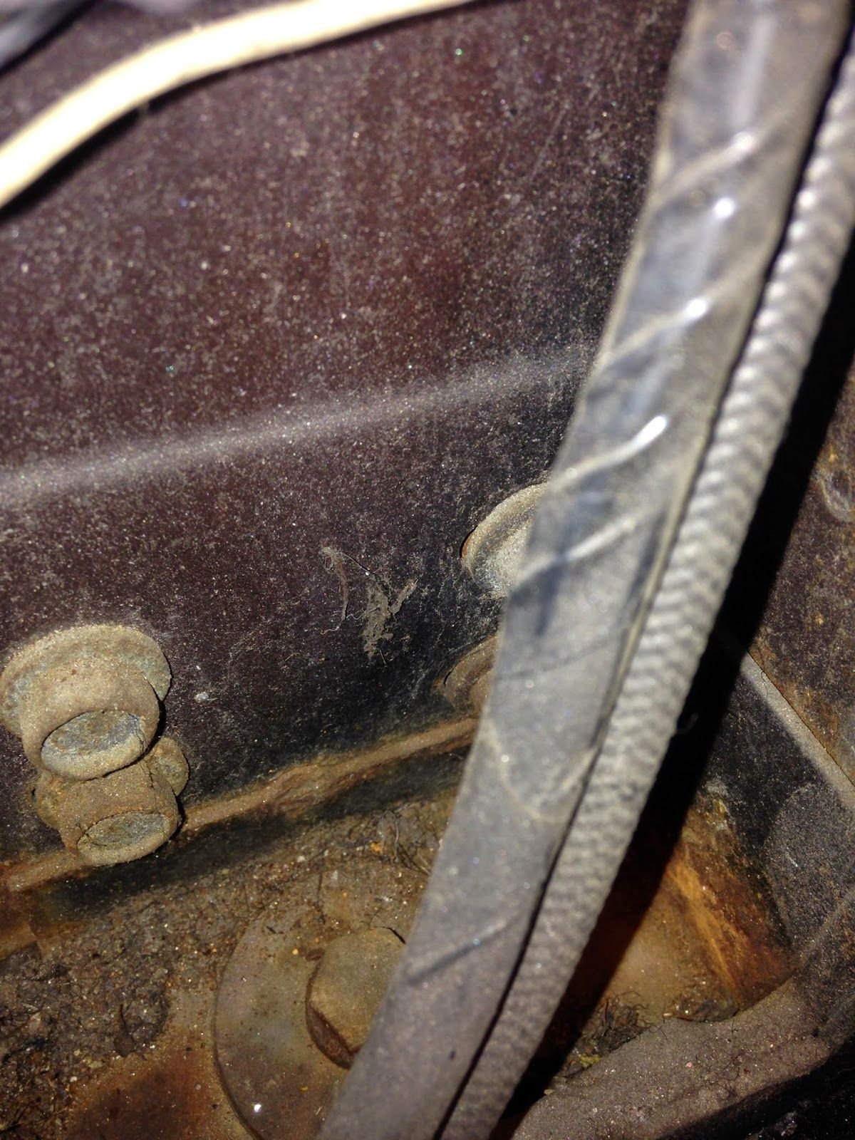

Built July 9, 1970. Under dash, behind seats, behind kick panels, windshield frame, no sign of green anywhere. All black, never restored.
Perhaps there was a small window late 70 early 71 they ran out of green?

Sounds likely, my 71 (black birdcage) is built dec 70.
