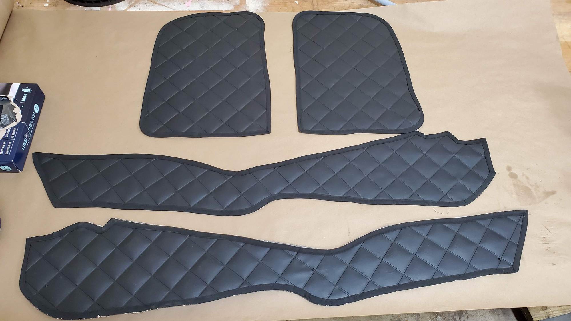

I covered the console side panels with quilted vinyl.
I had binding tape sewn around the edges for a finished look.
The other two pieces at the top of the photo are used in place ot the t-top headliners.
