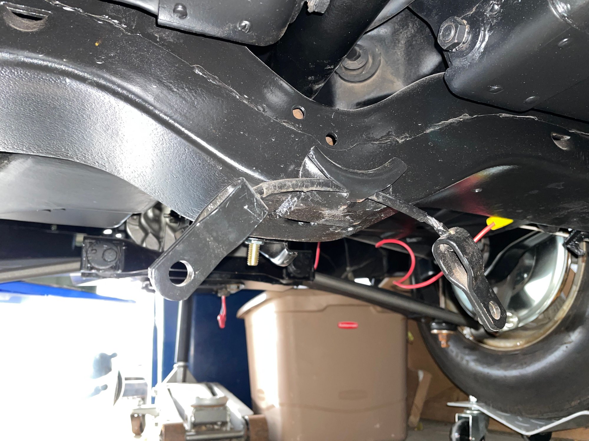

Could anyone please tell me what this is. I have a 1969 big block car and looked in the AIM and can’t find any info on what this is. Thanks in advance.

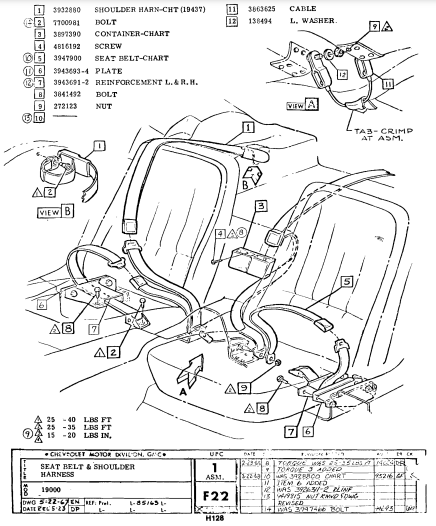

That's the safety cable for the seat belts; one end goes to the tunnel side of each seat's belt attachment. The right side of the cable should be under that nut seen in the very upper right of the picture. The passenger belt and cable would attach the same.

Looks like the seat belt retaining cable. See upper right of my 68 AIM

Thanks so much for the reply. I don’t know how I missed that in my AIM but found it now with your help! Thanks again.
