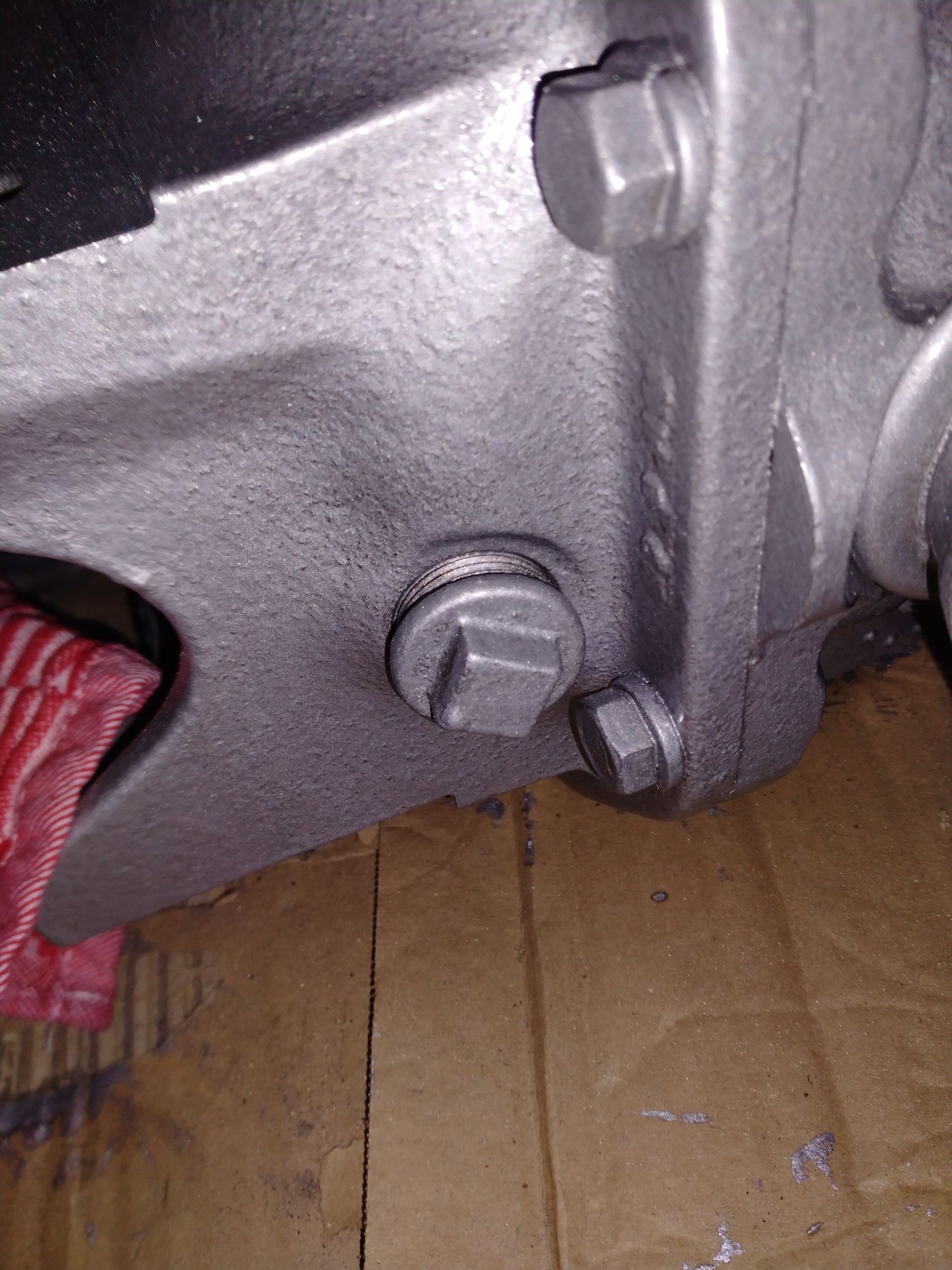

Hi everyone
I bought some cheap gear oil to do some fills and flushes on my differential.
Cleaning the inside with brake cleaner would eat the seals. (according to forum members)
Once filled with oil, I can also check for leaks (maybe the seals are leaky...).
The diff. is off the car. Where should I pour the fluid in?
Here are two pictures.
1. Can the vent hole on top be used? It is higher and because of that I can add to max level. If yes, how can I remove the plastic cap?
2. Should I use the 'pipe plug' on the RH side to fill it?
3. Should I use 'bolt plug' on the bottom side to fill it?
1
2
3

Pipe plug on the right side
Final level is when it just starts to run out of that hole (car/ diff level of course)

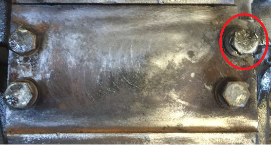

The bolt on the bottom shouldn't go into the housing...

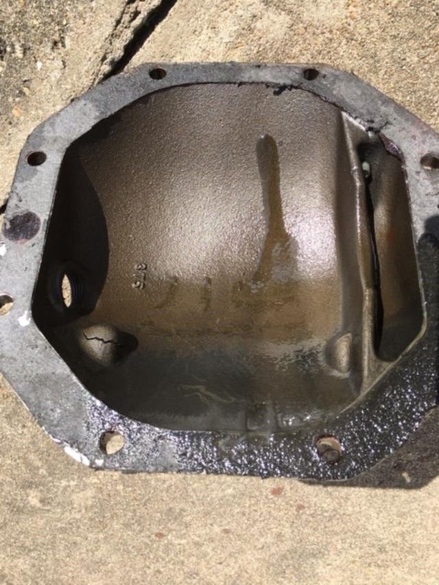

[QUOTEThe bolt on the bottom shouldn't go into the housing...
[/QUOTE]
When it does, usually not a good thing.

Do NOT touch the vent plug.
The square head plug on the right side of the rear cover is the ONLY access you need to have. Some who rebuild the differentials will put a drain plug in the main housing but you need to know what you are doing for that to avoid drill shavings being trapped inside.

Originally Posted by 60 SHARK
I may be confused by the picture, but this doesn’t look like the bottom of the diff. Looking like the top to me. Please help me, AND Novusuhu with this pic. ???
The following bracket is added with the 4 bolts going into the diff.
Driving69 posted a pic of when the bolt breaks through the diff cover instead of where the 4 bolts that are on the actual diff housing, that might be what's throwing you off
