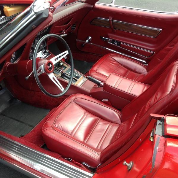

Hi madvette74,
Here's of pic of my '73 with the deluxe Oxblood interior, so you can see the console woodgrain insert as well as the deluxe door panels. Note...The deluxe interior (with leather seats) was only available with black and saddle interiors in 73 & 74. Deluxe Dark red (Oxblood) interior became an available option starting in 1975. My original standard vinyl interior was switched out and redone back in the late 90's by the second owner. Has held up really well. Just as gb states above....it's your car to do with as you wish!

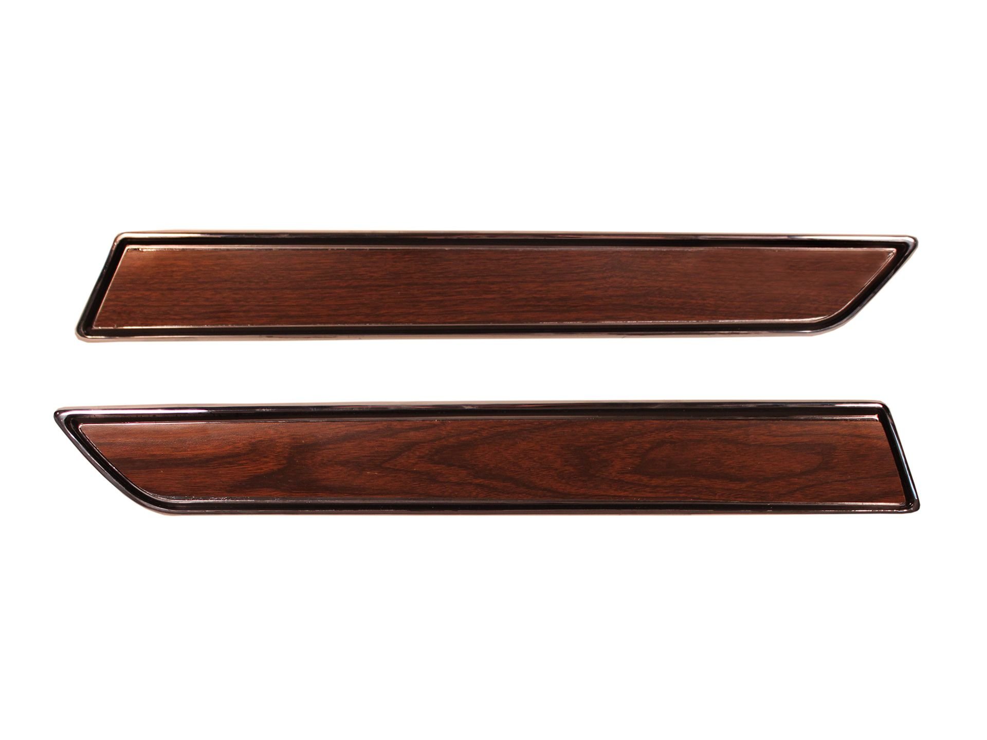

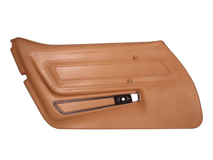

The door panels for the custom interior are the exact same vinyl covered panels as the standard interior with the exception of the applied wood grain inserts and a carpet strip with chrome trim at the bottom edge. The carpet is the plush, cut-pile so wouldn't match your existing 80/20 loop carpet. Given those specifics, you could just buy the standard door panels and apply the wood insert (I believe the "wood" from the regular vendors is really printed contact paper but I think there are some individuals making them from real wood veneers) This way you'd skip the carpet strip mismatch.
These are '77 panels but you get the idea:

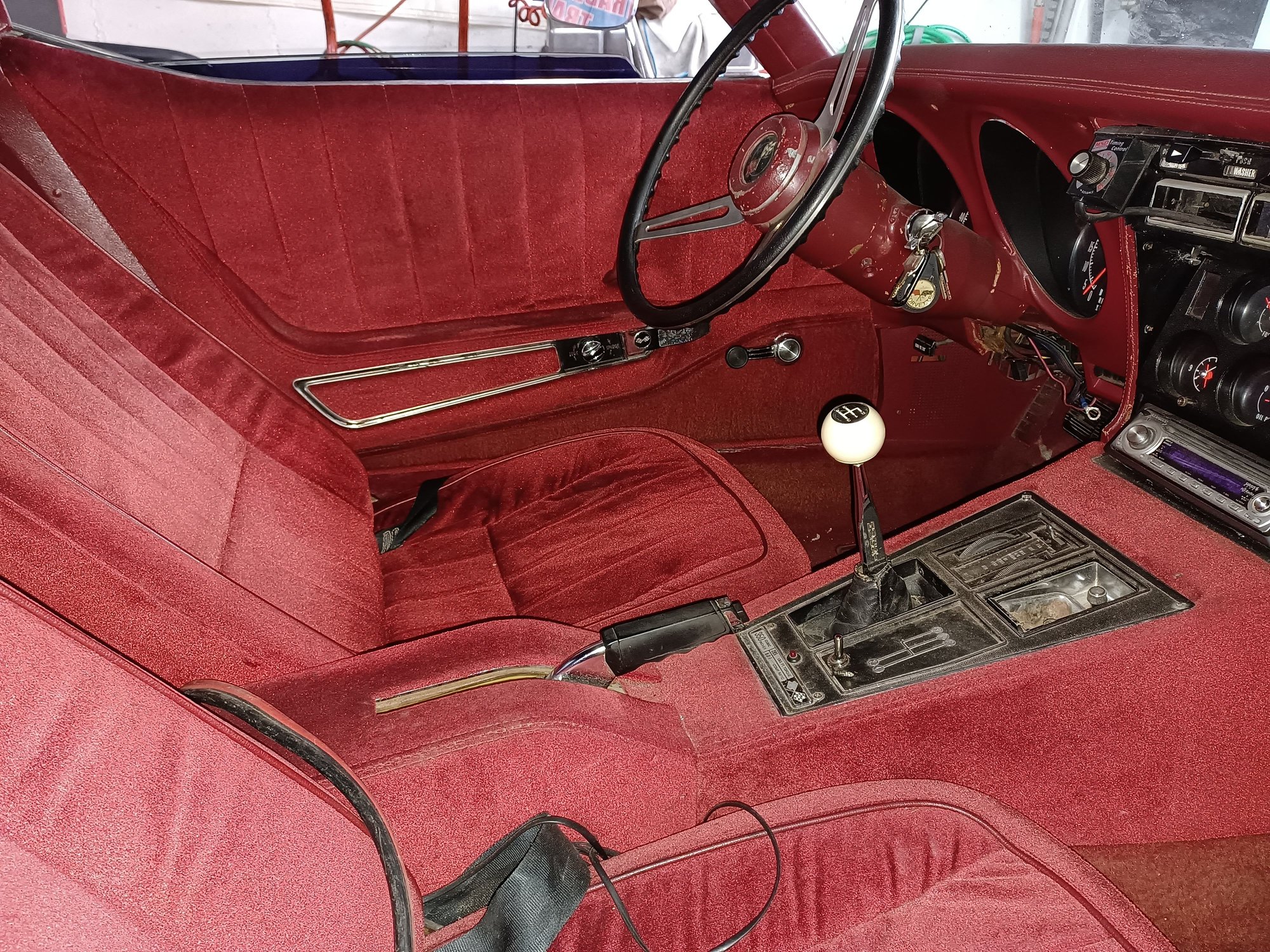

I got the lower column cover off and removed the ac parts under the hood, I was going to install vintage air, but I rather get interior, plus I pulled the motor sanded the firewall, and replayed it,, cleaned up the frame area under hood and used por 15 .. I am ordering eldelbrock pro flow 4, my complete front suspension is removed, got all moog parts.. so I am at the point where I have to watch what I spend my next dollar on..I do have have a polished air gap port matched to AFR 195 heads, proform 750, fairly new msd tach drive , msd 6al, msd timing control, msd blaster 2, and perhaps glass roofs.. and maybe more, so in a month or two, I will be listing parts in our classified section.. just not upto boxing and maling, atleast right now.

That's not just a velour interior, that's a VELOUR interior; looks like it's been flocked! The center console and door panels look well done but wow that's a lot of fuzzy redness! Be thankful they didn't decide to velour the dash and steering column too. Are the t-top panels veloured too?
Sounds like you've done a lot of work with plans for a lot more. Best wishes to you!

Default Ye
Thank you.. Yes, lol I didn't want to admit the tops were done also..lol..
30 plus years ago when I bought the car, it looked nice but it wore off quick

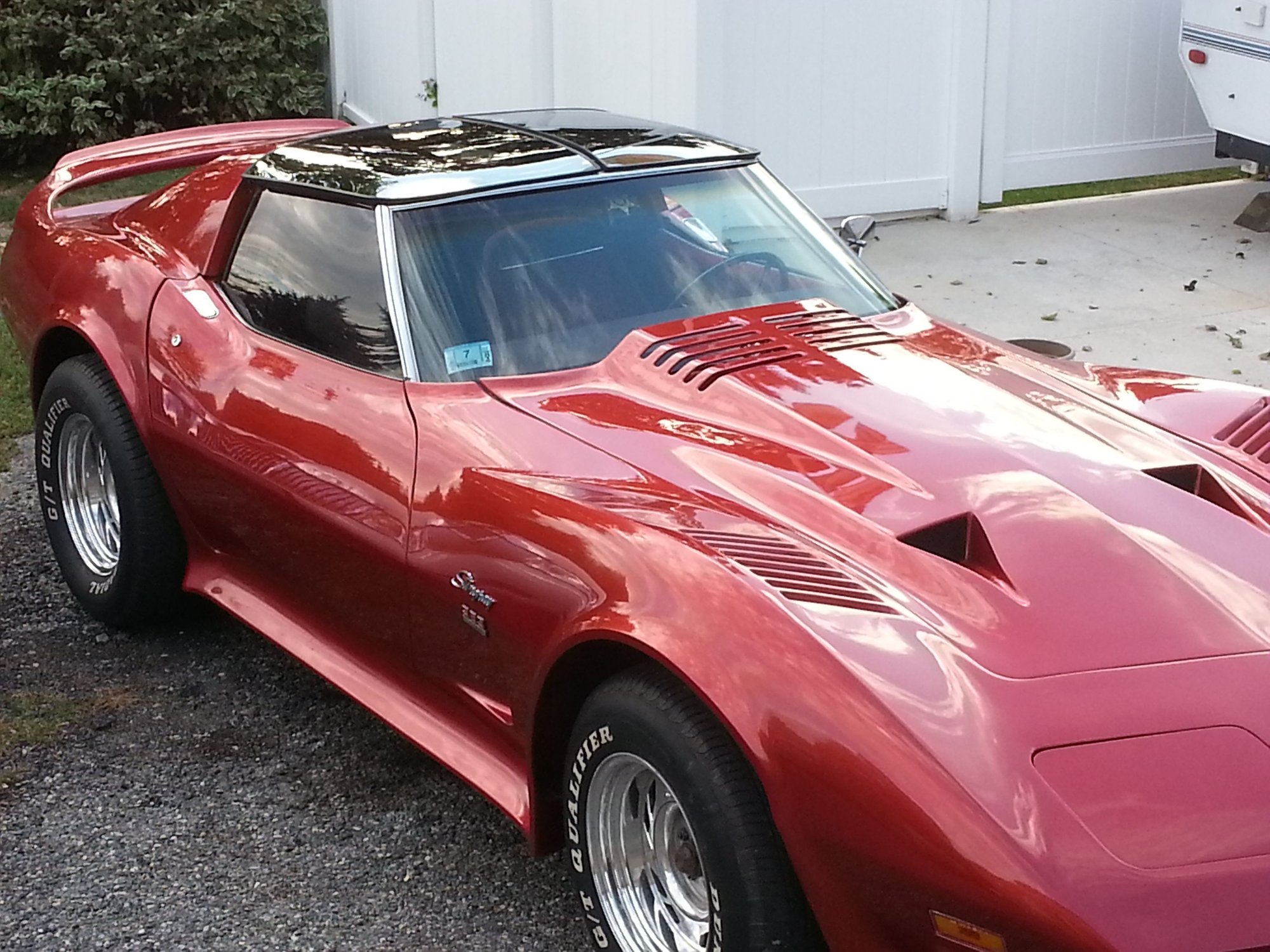

here is a pic of my vette, I did all bodywork and paint.
