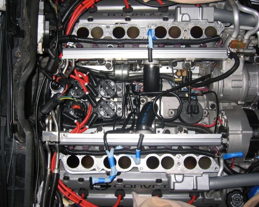

I recently bought this 75 convertible after a long 35 year sleep. In the process of waking it up I'd like to replace the bushing in the upper A-arms. So I have a spare set of A-arms built ready to go in the car. I figure I can get this done along with my coil over install over the weekend,WRONG! I've been working on my cars for as long as I've been driving basically and I can honestly say this car is really kicking my ***. The fan shroud needs to come out in order to get the A-arms off the car but the shroud won't come off unless you take out the radiator. The radiator is easily removed once you take the hood off.as stated I'm more than capable of working in the car,I've got a 91 ZR-1 inch hat in the only one that works on the car, this picture is changing the injectors on a car with 8000 original miles-thanks GM- but this 75 is really working my nerves.

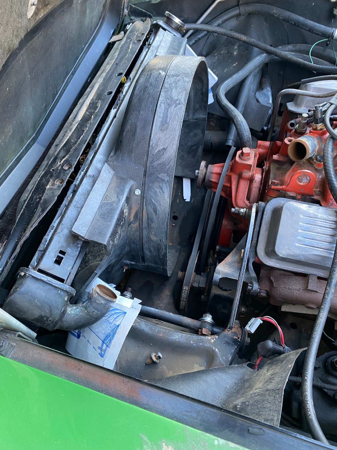

Old Dec 2, 2021 | 10:52 AM
interpon's Avatar
interpon
Joined: Jun 2019
Posts: 7,658
Likes: 2,470
From: Indiana
post 3 and what i had to remove and i have every accessory and ac..radiator stayed..had to use vice grip on one that c clamp would not fit…just don’t turn it!
Also mine a 79 ymmv

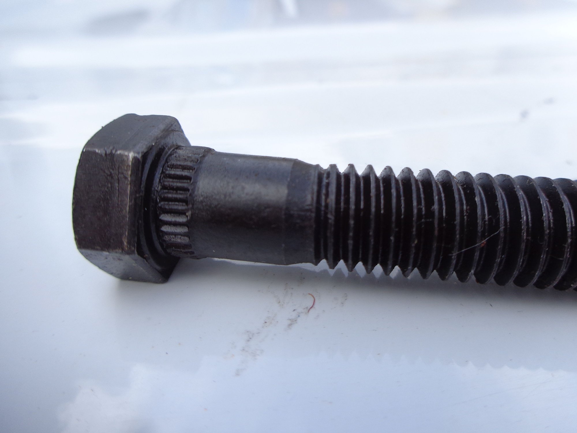

Old Dec 2, 2021 | 03:28 PM
ralphspears's Avatar
ralphspears
Banned Scam/Spammer
Joined: Nov 2011
Posts: 2,966
Likes: 991
From: MA
Also mine a 79 ymmv
also now you have access to purdy up some parts
https://www.corvetteforum.com/forums...rs-method.html
Cleaning up parts as they go back together but need to be able to set limit or before I know it the motor will be out and the snow ball will start rollin. The plan was after the car is 100% remove a lot of parts from the engine compartment,clean,paint and reinstall. I'm going to repaint the intake and the water pump,get the alternator apart,clean up the cases,replace anything that clean be made to look new. This cars only got 12,000 original miles but the rats,mice urine really did a number on a lot of parts in the engine compartment.

With the nut loose on the bolt tap it from side to side it will loosen it up and you can just push it out separate the upper ball joint first
