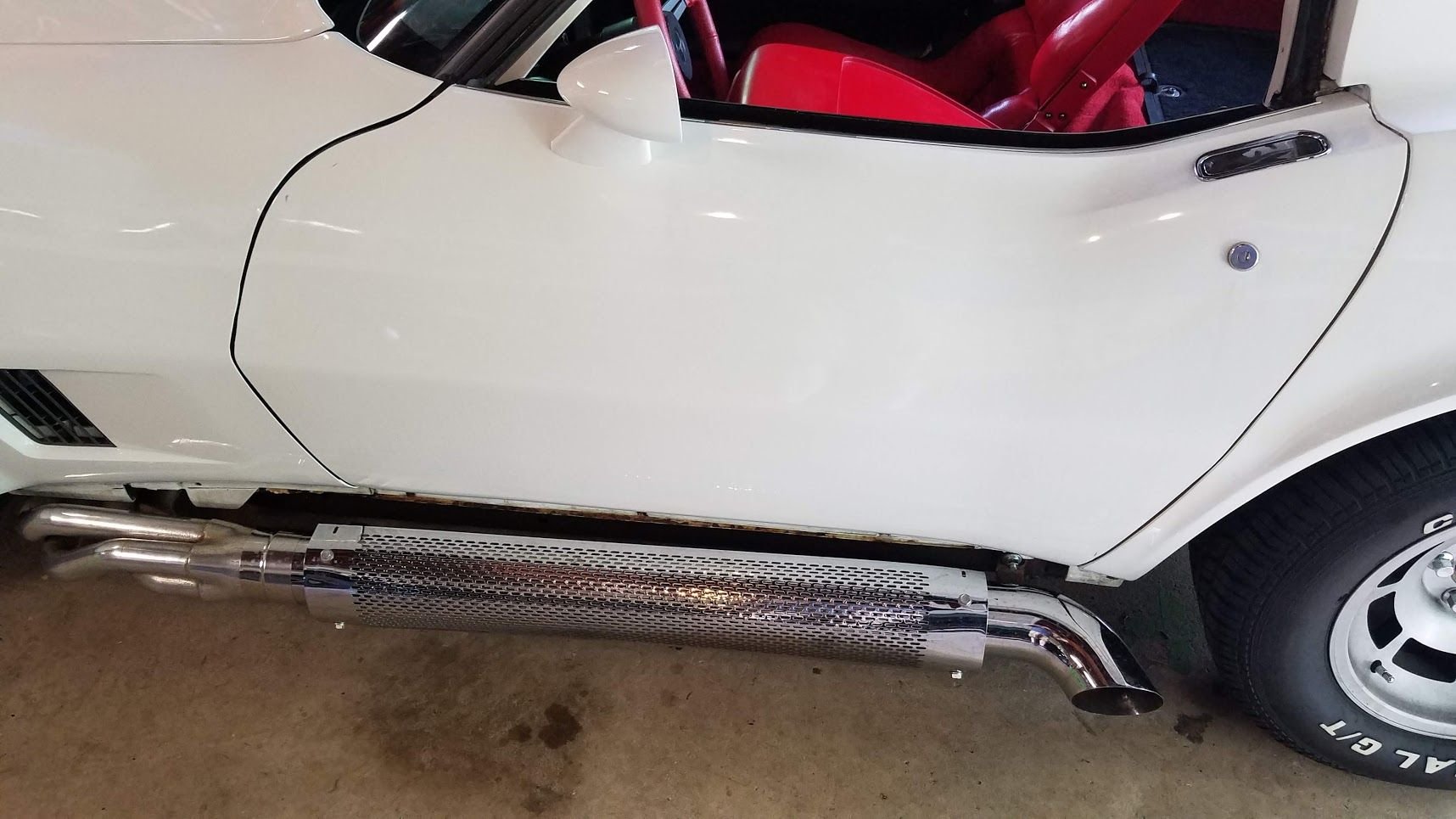

Welcome to the Forum! I'm surprised no one has yet mentioned the unwritten requirement to post photos of your car.
Sidepipes are iconic on C3s, even bubble-glass vinyl-bumper cars I have ceramic-coated Hookers on mine. I hate the chrome look, and will fix it eventually, but it fits, and frees up so much room under the car. I'm pretty sure I can put the stock side skirts back on the car, once I repair the screw clips.
Be sure to check your timing and possibly re-jet your carb when you go to sidepipes (or headers in general), and use side-shields to protect yourself (and especially your passengers) from burns. Also, ARP makes mixed size studs. 3/8" into the head, and 5/16" external for smaller nuts. I made it work with 3/8" studs and nuts, but it was tight, so while I HIGHLY recommend studs, don't do what I did.
I have manual steering, but your stock steering box should be the same size. There's plenty of room. If you upgrade to Borgeson steering, there will be less room, but folks have made it work.
