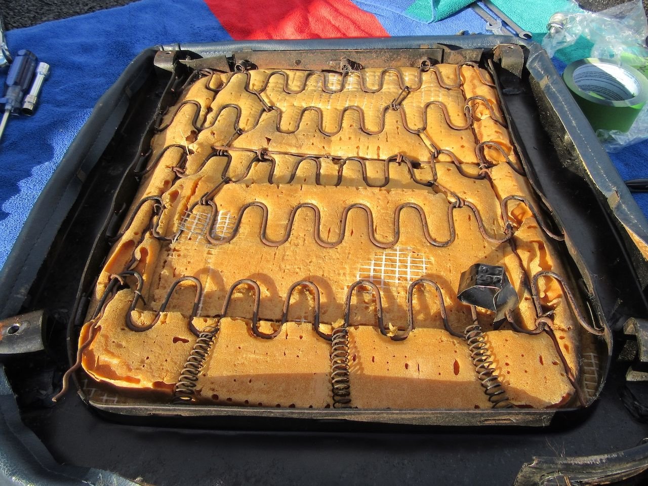

Under the drivers seat there is an electric something that is between the springs and the foam rubber (see pic) it has a two wire connector but it doesn't match up with the type of connector that is on the new wiring harness? Anyway, what is the electric strip used for? they didn't have seat heaters in '73 did they? and if it is a heater why is it directly against the foam rubber ? and if it is a heater, how is it turned on?

This is part of the seat belt warning system and should be installed on the passenger side. Because the seat bottoms are interchangeable, I am thinking they could have been swapped at some point.

O.K., i pulled out the passenger seat to see if it had been switched with the drivers seat and evidently it had not been switched. both the driver and passenger seats have the sensor underneath them. there is the correct wiring connector underneath the passenger seat, but there is an incorrect wiring connector underneath the drivers seat. I am going to pull up the carpeting and insulation and see if someone put the wrong connector in the wrong place.

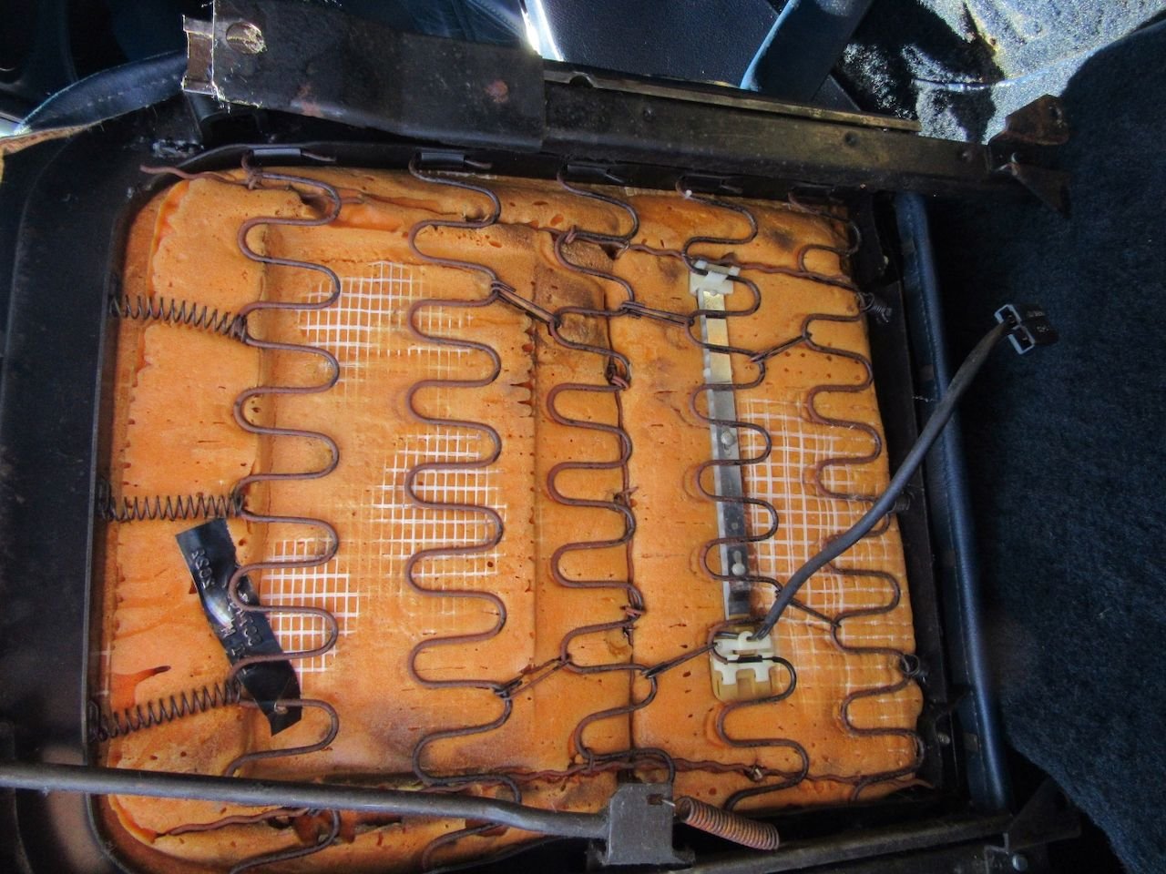

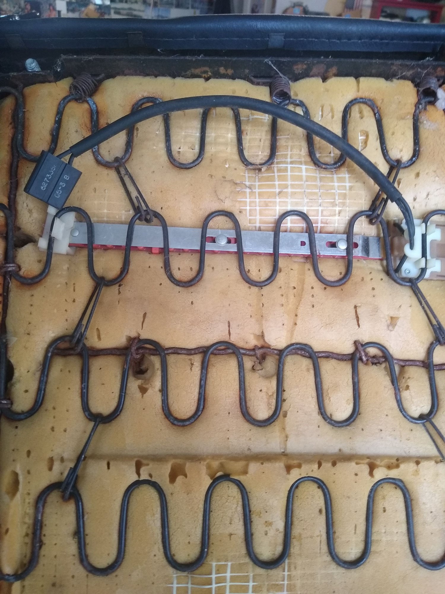

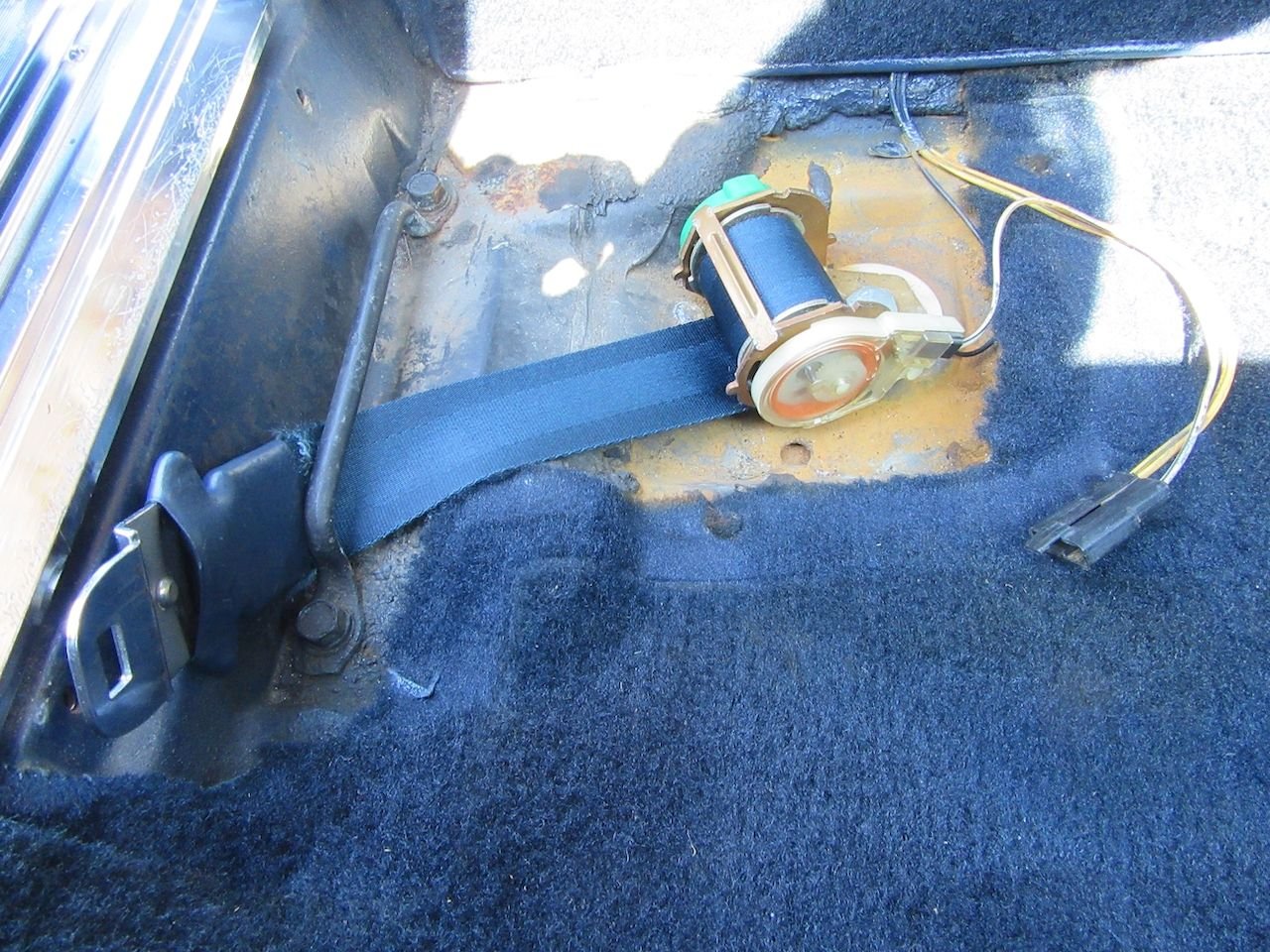

Only the passenger side seat bottom had the pressure sensative switch shown in your picture. It was used to activate the seat belt warning light and buzzer. A few pics from my original 1973. Fran
Drivers seat bottom
Drivers seat belt mechanism
Passenger seat bottom
