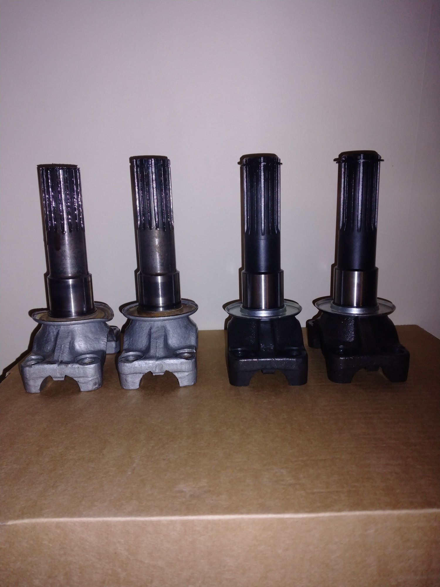

Left two (old) & right two (new)

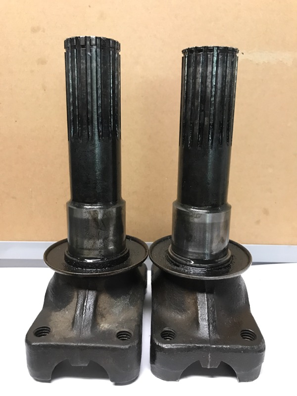

For the new yokes can you measure from the face to snap ring and let us know what it is? Also are they hardened? Did you get a hardness measurement on the face of the axles? this is important, if you didn't you should get them checked before installing or you may be back where are now. I haven't used new axles in a long time and the last ones were junk, the dimension was off and they were not hardened. I took the word of the supplier- big mistake, and 3 sets wore out in under 1000 miles.
These are the measurements (from face to snap ring).
I measured from each side of the snap ring groove to the face:
6 mm = 0,2362"
4 mm = 0,1575"
I didn't do a hardness measurement. The product disciption said they are 'heavier duty' then OEM.
6 mm = 0,2362"
4 mm = 0,1575"
I didn't do a hardness measurement. The product description said they are 'heavier duty' then OEM.
The Heavier Duty statement is meaningless marketing hype, so disregard it.
If we are on the same page and you measured from the face to the snap ring, not including the ring thickness and you have .236 on one and .157 on the other that is terrible. Again, if those are correct measurements, it shows me complete lack of QC on a part that should be in the 185-200" range. The 236 is really questionable and I don't know how you could get the ring installed. The 157 would be very loose. To compare, if they were used in a correctly tuned and balanced posi you would not get the snap ring on the 236 and the 157 would have about 030-040 endplay. Again, if these are correct measurements then I would really question the hardness of the face since it tells me they have no clue on how to make them and would not use them until you can confirm the hardness.
Okay, I didn't know the measurent needed to be so accurate.
Will check again tommorow and let you know.
The two measurements were on the same yoke (to be clear). Sorry for the confusion.
I ring was not installed when I measured it...
I will measure again from the face to the snap ring, not including the ring thickness, as you said.
If we are on the same page and you measured from the face to the snap ring, not including the ring thickness.
I did a more acurate measurement and got the following:
4,6 mm = 0,1811"
