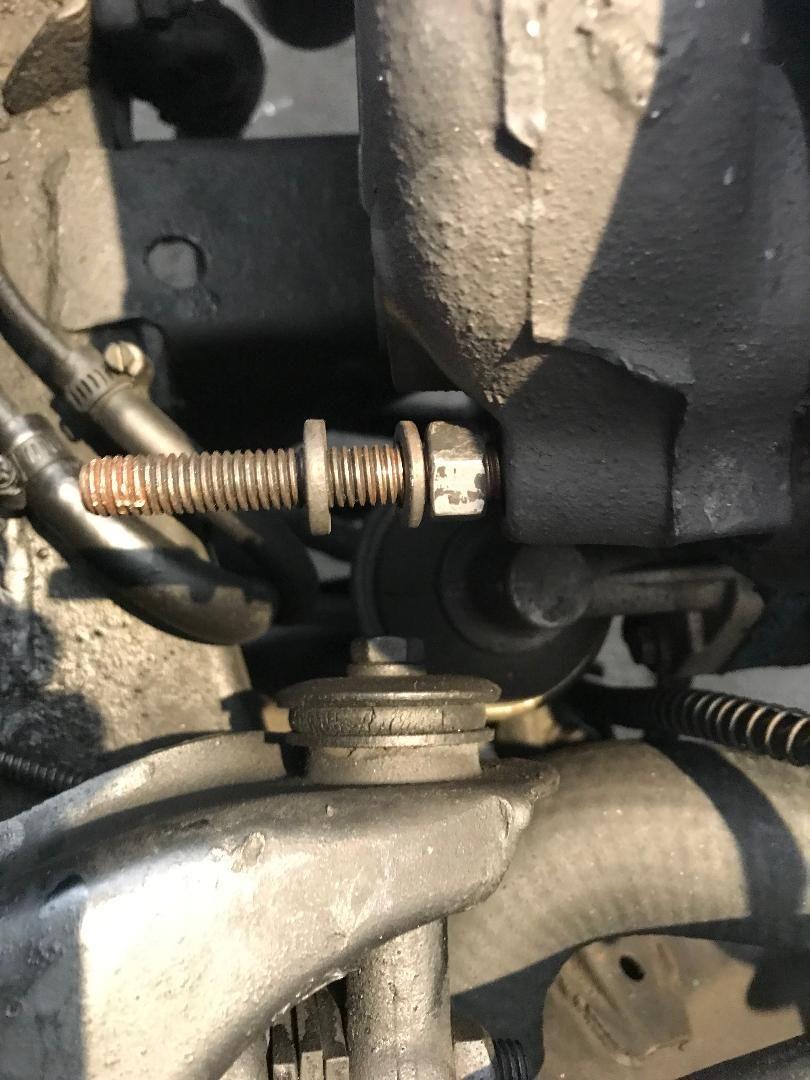

Was cleaning up the engine bay after my rad was installed and the old ac condensor was removed..
I noticed at the very end of the P side exhaust manifold is a very long threaded bolt with a nut and washers that cannot be tightened up??
FWIW the OE AC compressor was removed by a PO..
Any probs with not having a bolt at that position in the manifold???

Old Dec 24, 2021 | 02:22 PM
JavaJolt78's Avatar
JavaJolt78
Joined: Nov 2019
Posts: 614
Likes: 56
From: Dover, Delaware
Old Dec 24, 2021 | 02:24 PM
JavaJolt78's Avatar
JavaJolt78
Joined: Nov 2019
Posts: 614
Likes: 56
Not a one EM
Can you tell me what to look for if I can find one at Advance Auto bc I work there partime?
Or maybe you have one for sale?
JJ78

That was used for the stock A/C compressor mounting. You can replace it with a normal bolt for the exhaust manifold if No a/c is going back in.

It should need a 3/8 / 16 - 2-1/4 bolt
