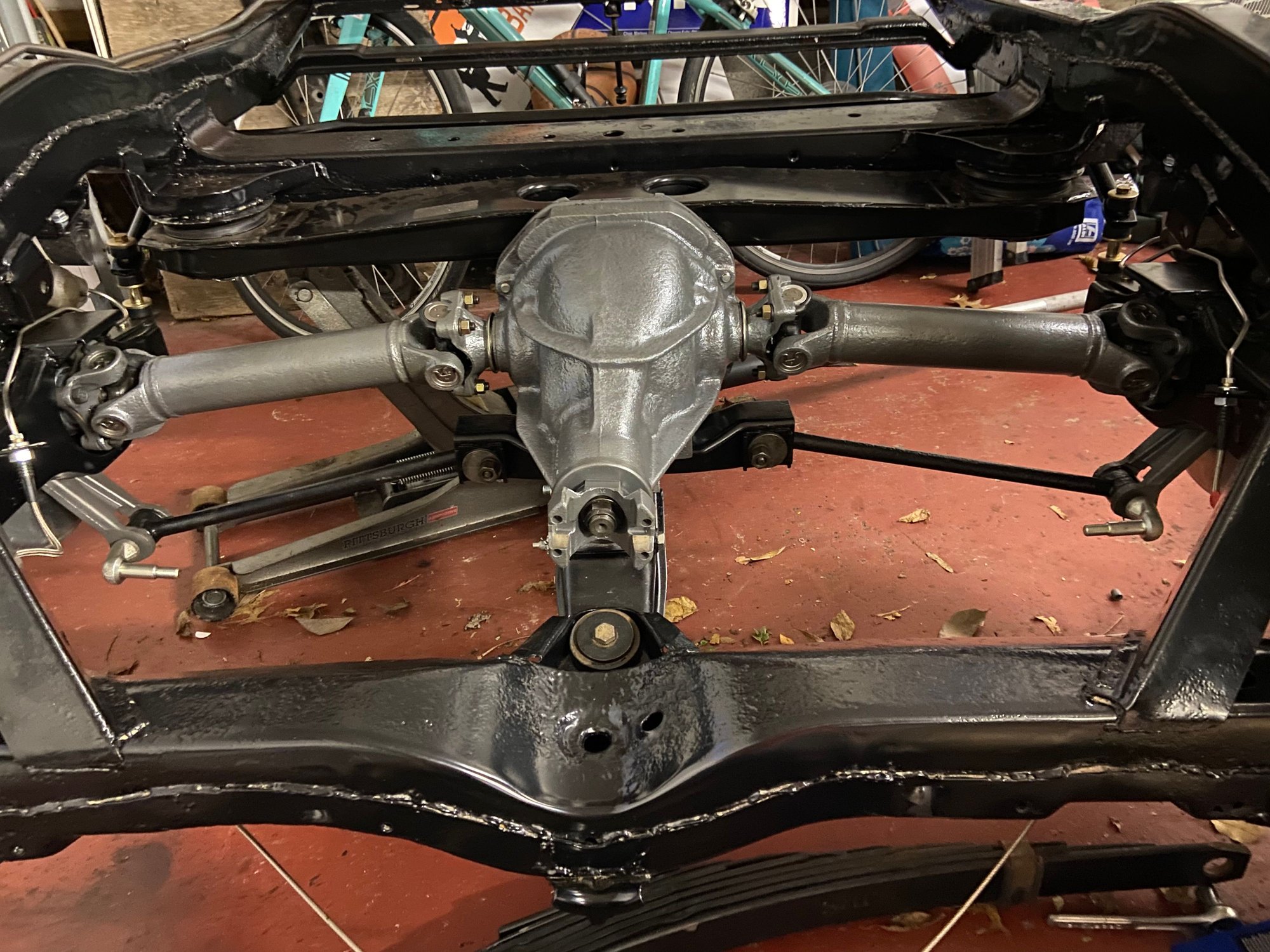

vette68's Avatar
vette68
Joined: Dec 2000
Posts: 296
Likes: 190
From: North Olmsted Oh
I went the powder coat route. Silver. And I’m very happy with it. But as was said, all internals have to be removed for powder coat. So that’s a lot more work than just replacing the u joints. So unless you plan on gutting the differential, then a coat of paint will have to do. In my case, I had the whole thing rebuilt. New bearings, new bushings, new seals, new shims new universals…. All new. Cost $1500 all in. But I essentially have a new differential and half shafts now. And they will never rust again.
