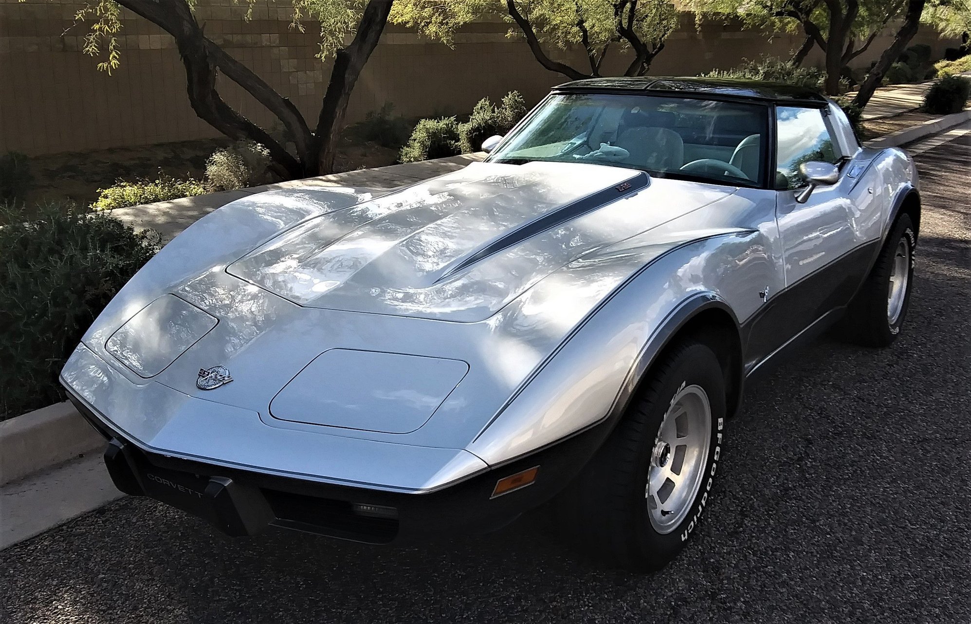

Default 78sa l82
Quick check....look at the stamping pad should say CMS, measure the harmonic damper should be 8" for a L-82.
All L-82 came with emblems on the Hood,
Fast fact...L-82s were not available in most of California,
L-82 4 spds are the ONE... with less than 20% of the 78 population.
It's on the hood for all to see!
