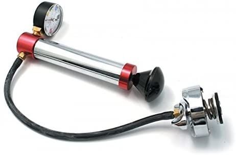

Like L-46man said, open up the valves, rent one of these:
and pressure test it. Easy peasy.

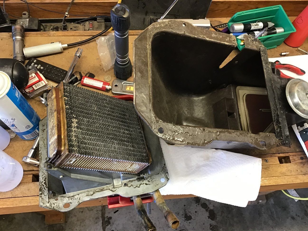

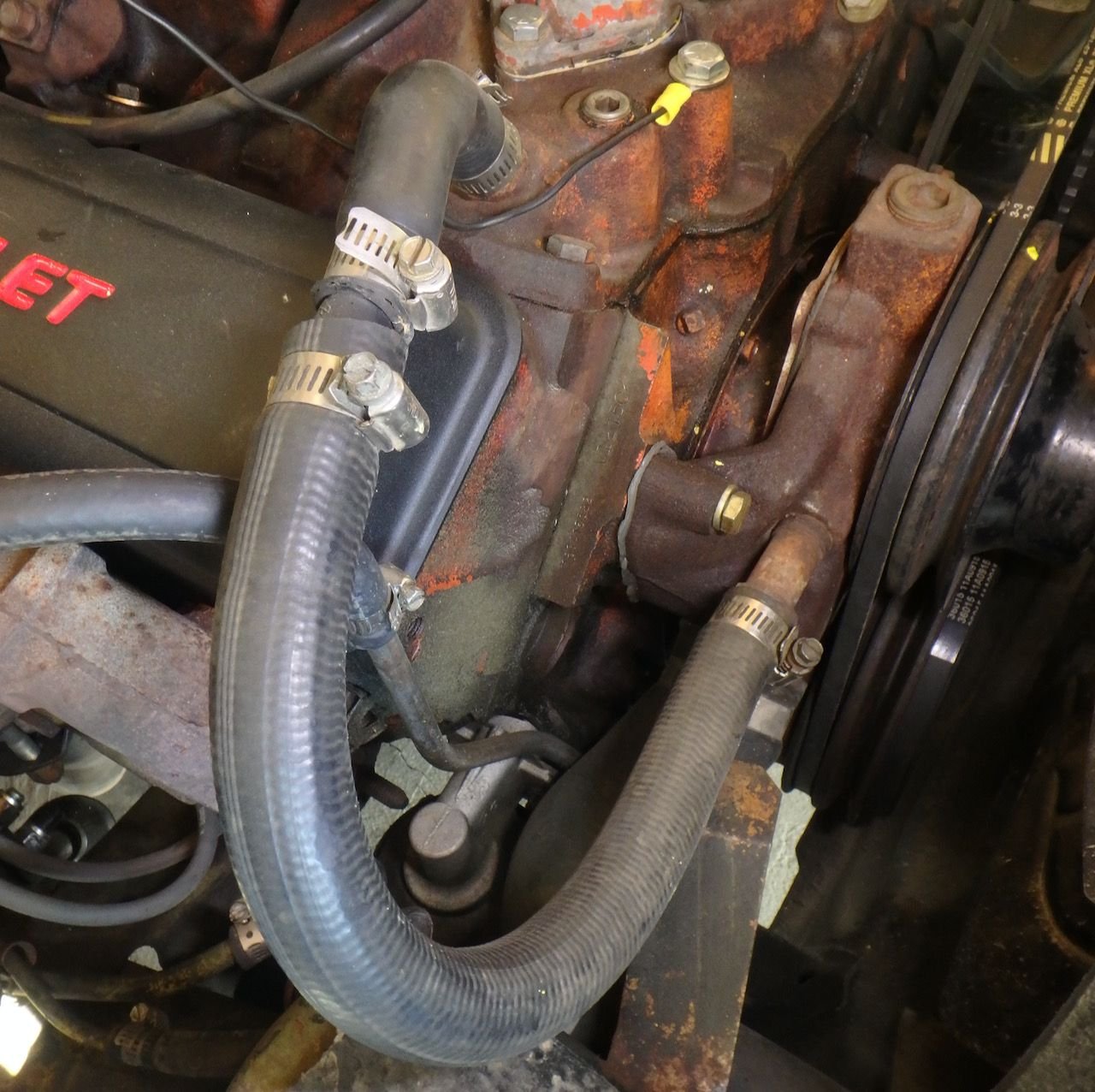

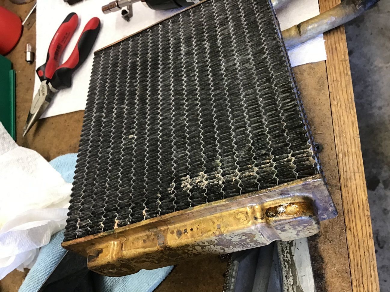

I bought a '76, sight unseen on eBay. When it arrived, the passenger side floor was moist, and I almost had a stroke, thinking it was a rotten bird cage or windshield frame. I rubbed my finger on the carpet and then tasted it, and thank heavens, it tasted sweet.
Luckily, where I live, I don't need a heater. Here's what I did to fix it, all I had to buy was a 5/8-3/4" hose adapter. I wouldn't change that core unless I absolutely had to. Even thinking about it gives me a headache.

Mine looks just like that. I put a 3/4" nipple on the intake manifold so I wouldn't have to use the plastic transition. In my 80, I plugged the holes in the intake and water pump.

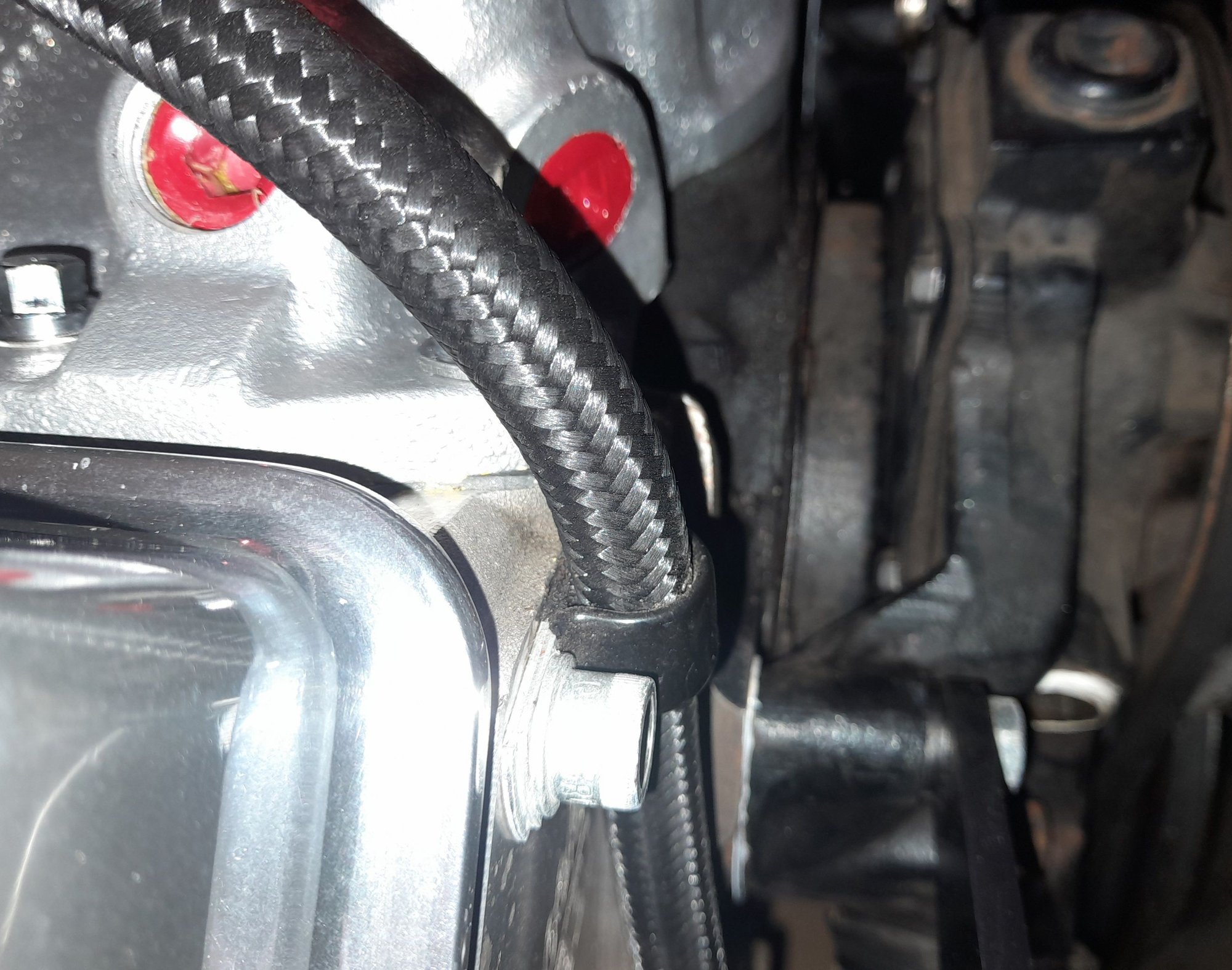

Although this does look fairly easy. I came up with a different low cost solution that I thought I would share.
A pipe plug in the intake manifold, painted red to match other underhood components. And a pipe plug in the water pump. And yes you can see the white Teflon tape. I guess a bit un tidy. I might need to revisit that.
Thought I should add a photo from a little further back. better comparison.
