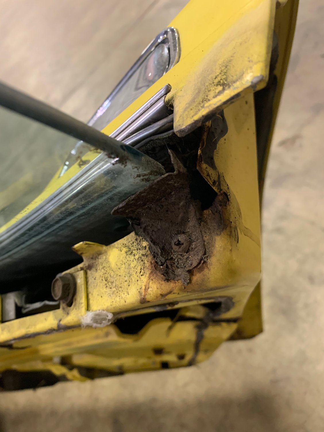

Like to replace this rusty window guide?

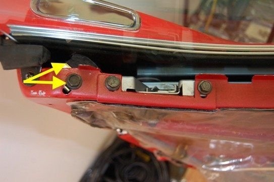

IIRC It's part of the weather strip

Molded into the end of the door weather strip just behind where those arrows are there

In the aim it is part #466661 and called panel assembly. Paragon has it listed as 466661u and calls it a door assembly but need to call. It doesn't appear to be a popular part for sale on the internet.
If you are buying new weatherstripping that piece is embedded in the rubber as Mooser stated so no need to go chasing.
