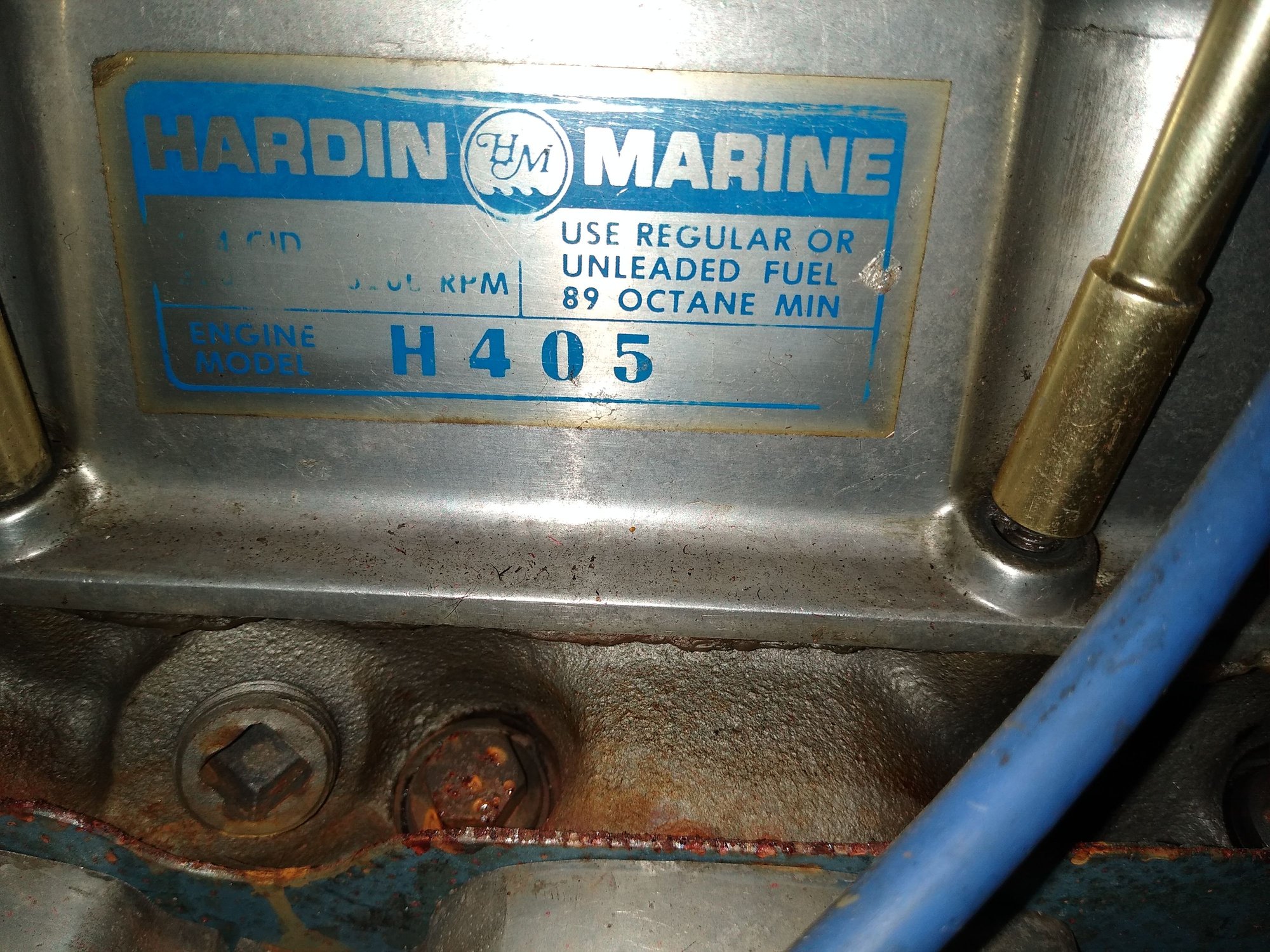

My '77 Baja jet boat has a 454 marinized by Hardin Marine coupled to a Berkeley Jet drive. The engine is a Hardin H405. Relevant specs are: Mark IV block, 8.8:1 compression ratio, Holley 3310, Edlebrock Torker intake, Hardin jacketed log exhausts, open cooling system, 360 HP (as rated by the manufacturer). Marinization consists of, amongst other things, different head gaskets (Fel-Pro 17040) and brass freeze plugs. I purchased the boat from the original owner in 1989.
Engine stamping is T04226XH
T=Tonawanda plant,
04226 = April 22 1976
XH = ??
Basic engine specs are provided by the owners manual https://www.berkeleyjet.com/instruct...ne_engines.pdf
I am just throwing this out there. I know several Forum members have stamping libraries and stamping guides. Has anyone come across the XH stamping before?

Marine engines are truck engines. 4000 RPM heavy throttle all day. Low compression, mild cam. That engine code is 6XK. 1976 454 marine rated 215 horsepower. http://www.1968ss.com/BBCsuffix.asp

XH comes back as 1968 396 Truck engine. But that can't be right as your engine is a 76'.
Engines built specifically for marine applications had different stamp codes altogether than passenger car/truck......
What is the block casting number on the bellhousing ? What is the cylinder head part number under the valve cover? This will help sleuth out what this engine exactly.

Yes, and the hull is a '77. I will check the casting numbers and dates for the heads and block and will post. I do know the heads are rectangular port.
Hardin produced at least 5 different configurations of BBC during this time period. Ratings were dependent upon the components of the build and the application such as v-drive, jet drive, or direct drive. Components varied including Intake and exhaust manifolds (above water, over the transom, below water), carburation, heads, flame arrestors, distributors (single point, dual point) -- all resulting in varied horsepowere ratings. Keep in mind these HP ratings were gross ratings, as there were no accesories (PS, A/C, water pump), emissions equipment, mufflers, or drivetrain losses to account for.
