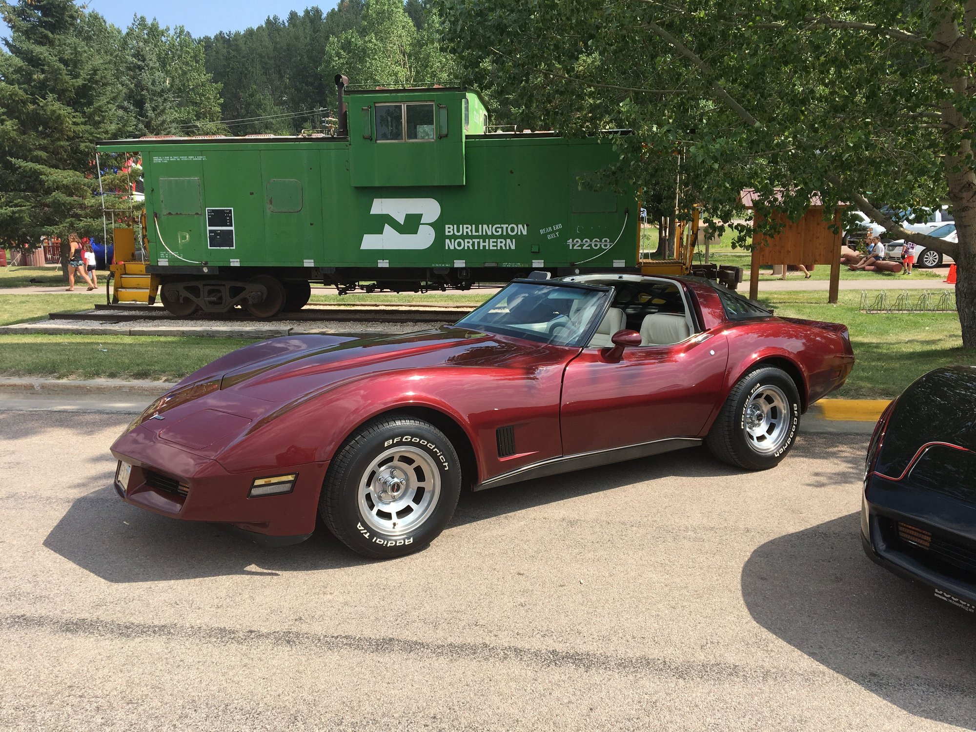

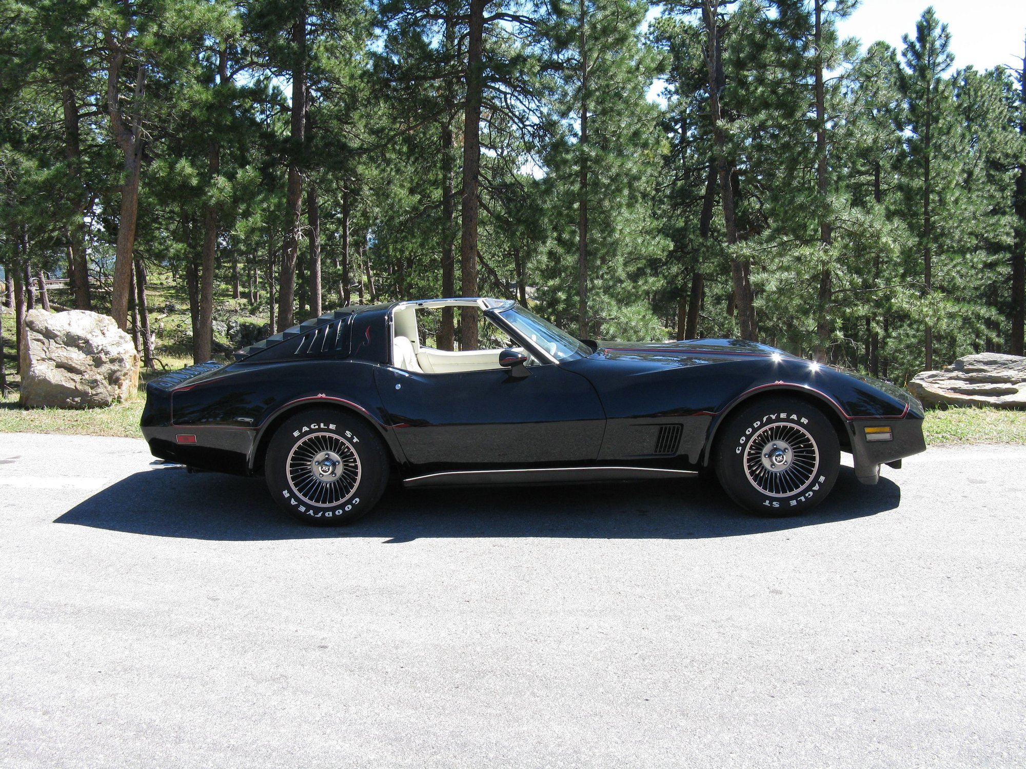

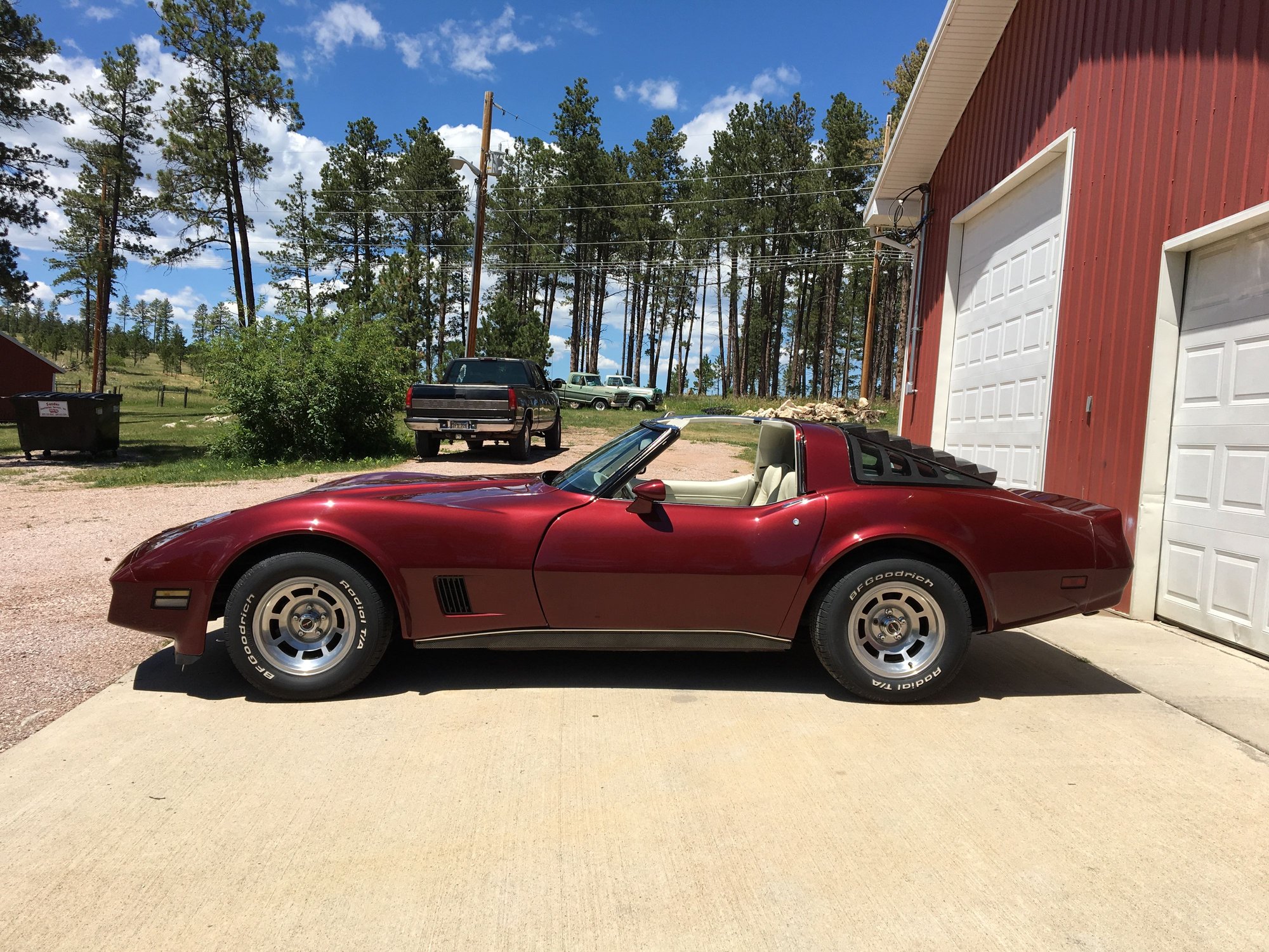

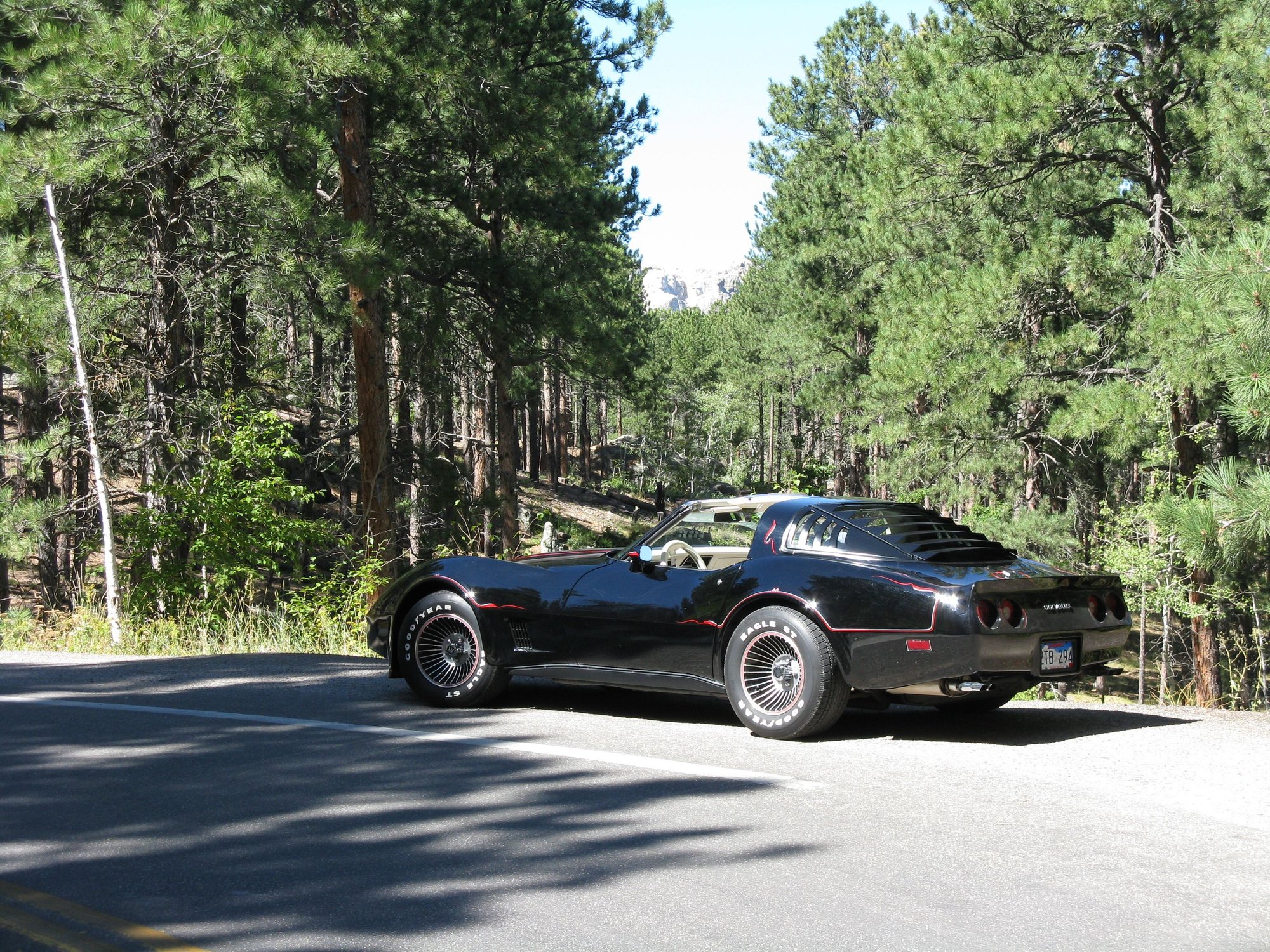

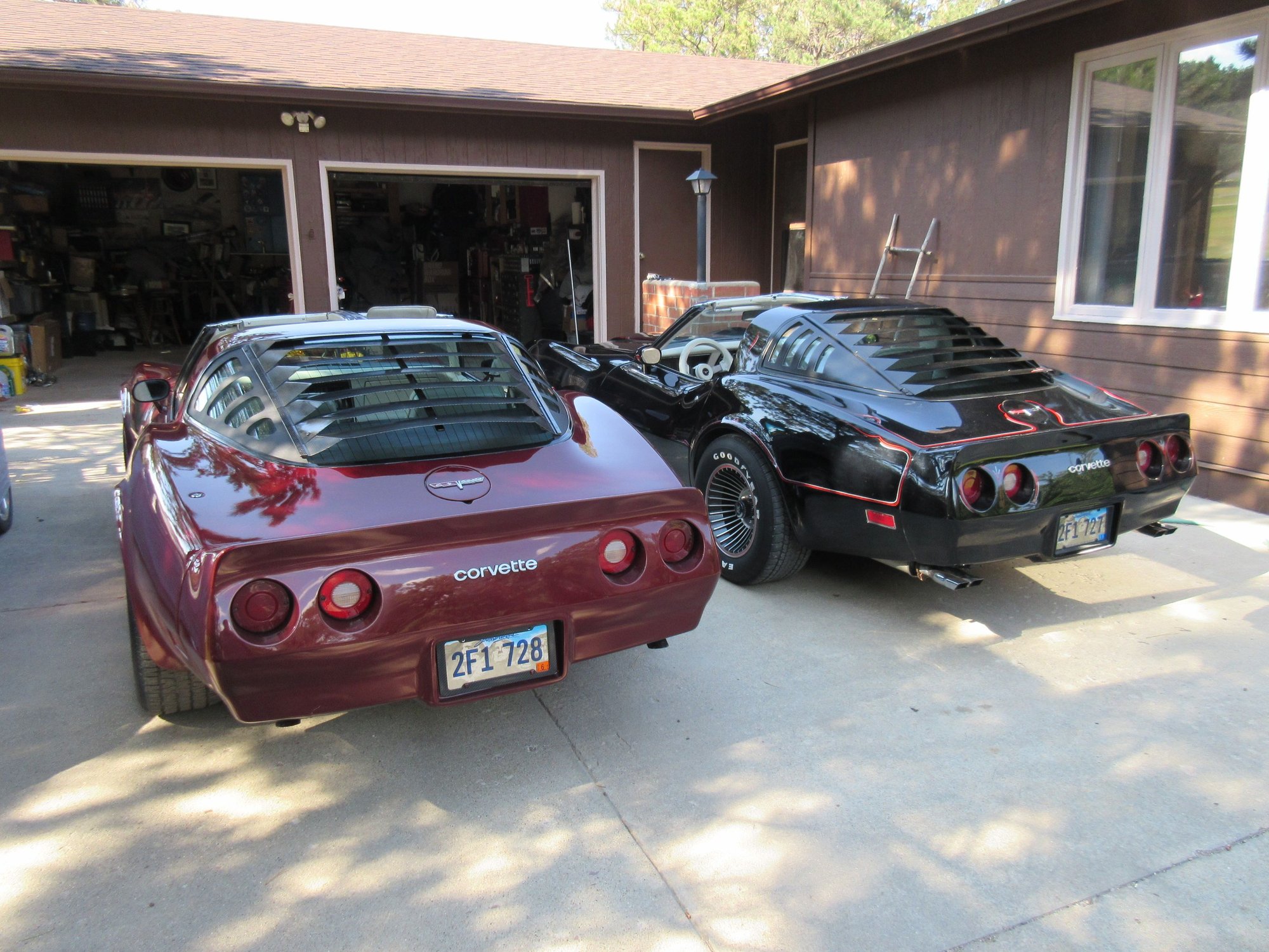

I've run louvers on my '80 since it was two years old. My louvers are the 3 piece all aluminum style that completely rely on the rear window trim to hold them on. 40 years took their toll on the trim clips.
This year I had all the clips replaced. Cost me $140. Money very well spent. Have a professional do it. They said there is a chance of breaking the window if it has to come out. Big Money! Have a pro do it.

I took the louvers off my car and that was the root of the same issues. Cracked the plastic trying to clean them up, so I'm just taking them off. Broke some more clips while trying to get the trim off to repaint it. I am in agreement about taking it to a pro. Just gotta get on the schedule somewhere.
Nice looking car Tony.

Thanks. I love my louvers on both cars. Changes the look and a ton cooler to ride in. The louvers on my maroon car are different and not as hard on the trim. But they don't look as nice.
