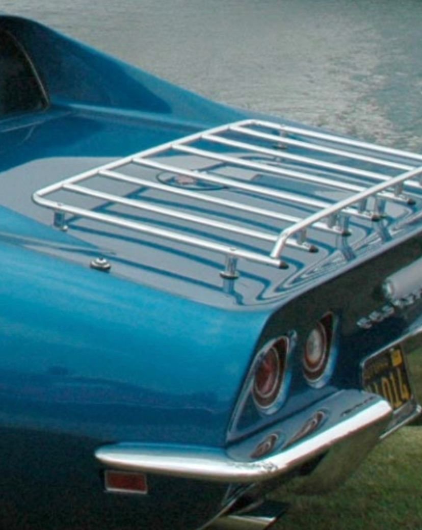

Why is the luggage rack all the way up in the window pocket its off like 6 in or more

Old Feb 7, 2022 | 06:41 AM
forman's Avatar
forman
Joined: Mar 2010
Posts: 2,270
Likes: 375
From: Randolph nj
This is what it should look like
Old Feb 7, 2022 | 07:41 AM
ElmrPhD's Avatar
ElmrPhD
Joined: Nov 2021
Posts: 206
Likes: 11
From: Weesp, The Netherlands
Oh, wow. Big difference. Maybe they were trying to improve the center gravity for, ya know, racing with luggage... ;-)
Old Feb 7, 2022 | 09:46 AM
fstntq's Avatar
fstntq
Joined: Sep 2011
Posts: 381
Likes: 90
From: Portland, the original!
Substitute "glove box" that you can access with the rear window removed, ha!
