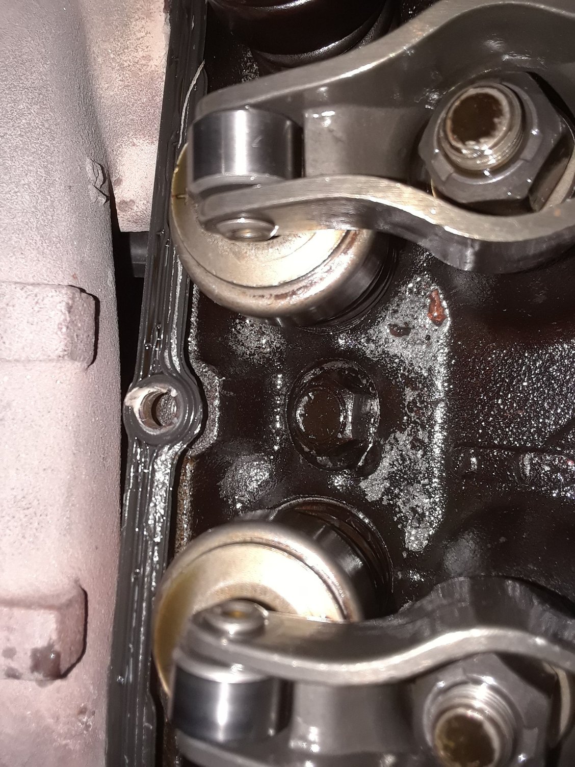

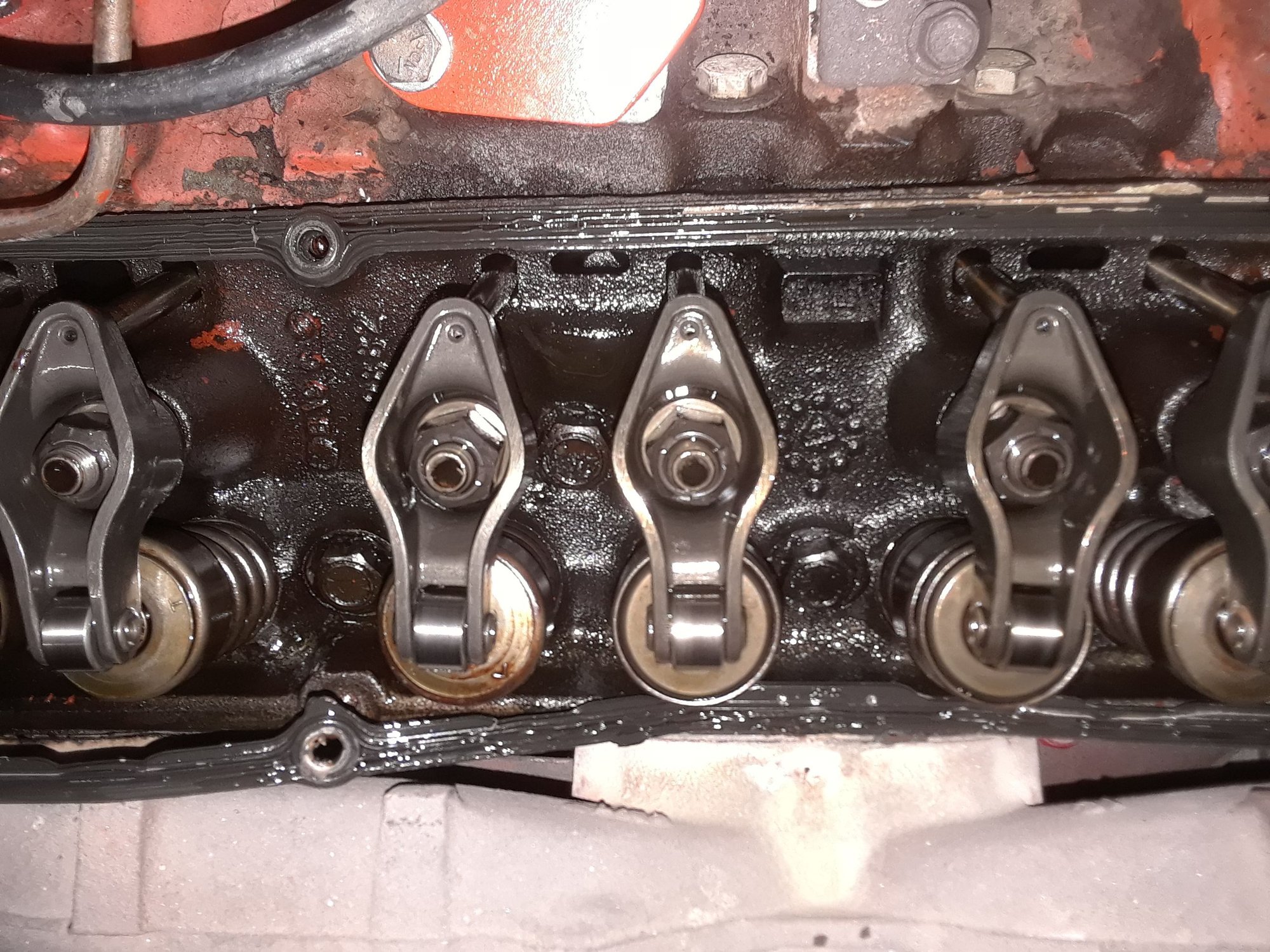

Originally Posted by L-46man
Life is a box of chocolates...etc.
I had to quote the above after todays discovery's.
First up, after removing the carb for a rebuild I realized the throttle does open fully.
I put the base plate back on the manifold and discovered the kick down cable is what's preventing it from opening fully.
The secondary's open about 1/3.
Next I thought I'd peek under the valve covers, I heard what sounded like an out of adjustment valve on #4 or 6.
Lookit that, roller tip rockers!
After a more close examination I see:
Metal filings laying in the corners of the top of the head.
I wanted to build an engine for the car eventually. I was planning on driving the car while I was building the engine.
I probably ought to bite the bullet and do the manual trans conversion at the same time.

Jeff don't panic!
I'm not quite seeing (from your pix) the metal filings you are speaking of....actually I THINK I see ONE.
Determine where this is coming from? Will it be picked up by a magnet? (steel/iron)...or is it aluminum?
Could be residual left over from prior work....(I tell my older friends while working on engines...WEAR YOUR #$%^& BI-FOCALS!) It's amazing what they don't see!
Report back!
Nice rockers tho!

If you're going to build another engine anyway, I wouldn't be too worried about this one. Run 'er till she blows!

Good points, thanks Hal. I didn't think to check with a magnet, I wondered if it might be anti-seize (it's the right color) except it is gritty and rough feeling to my fingers.
I was a bit bummed last night, I'm over it now.
I plan on continuing ahead with resealing the manifold, adjusting the valves (after inspecting the rockers) and rebuilding the carb, then I'll see how it runs.

Jeff a little old school forensics for ya.
Remove oil filter...cut it open CLEANLY....pull out the paper element.....LOOOK!
Old Mar 9, 2022 | 06:11 PM

That's the plan after getting some miles on the fresh oil and filter. I changed it about 60 miles ago.
