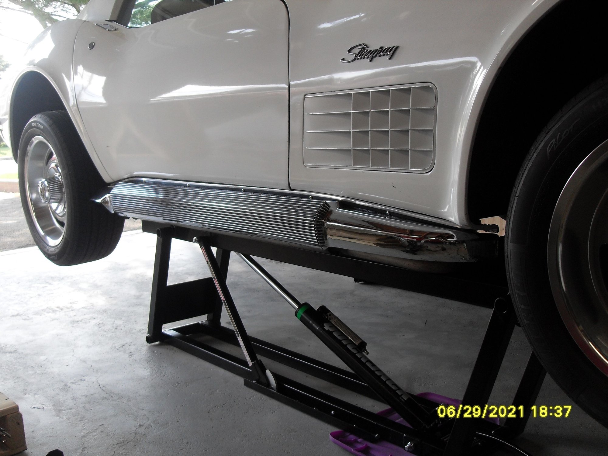

Mine just said quickjack 5000 2 years ago..
Are you sure the 5000 and 7000 has same pad opening distance? Mine only has 4 inches to spare in pad pocket before the 5000 is too big.
i get 73 inches approximately 3 inches above tire bottom. if i add the extension for longer wheelbase i cannot fit pads properly as they move out. I hope that makes sense, they may have changed from when i bought a couple years ago.
i suggest costco as you can return anytime if needed..get your money back if. You have membership.
Front
2019 costco
Rear

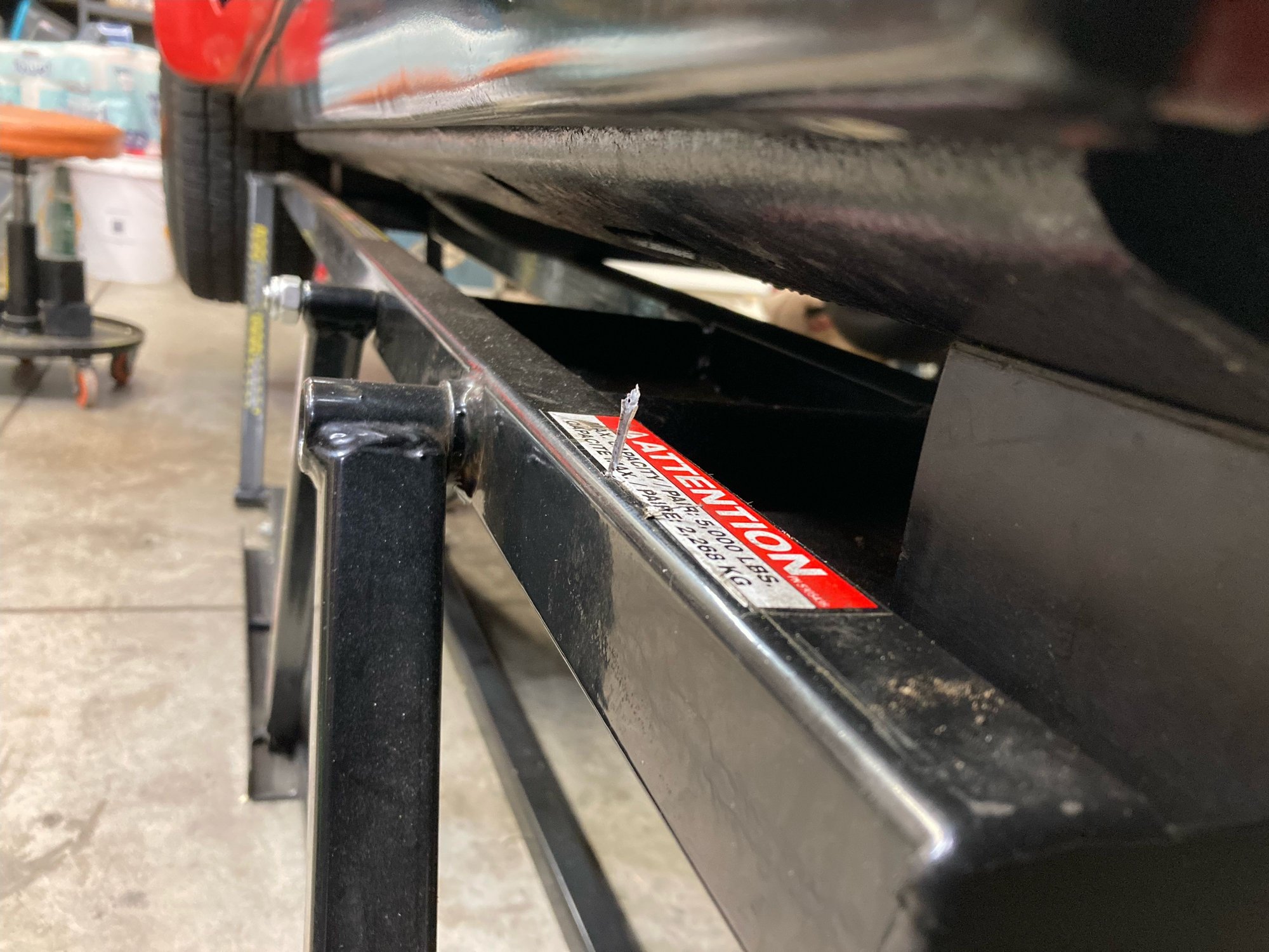

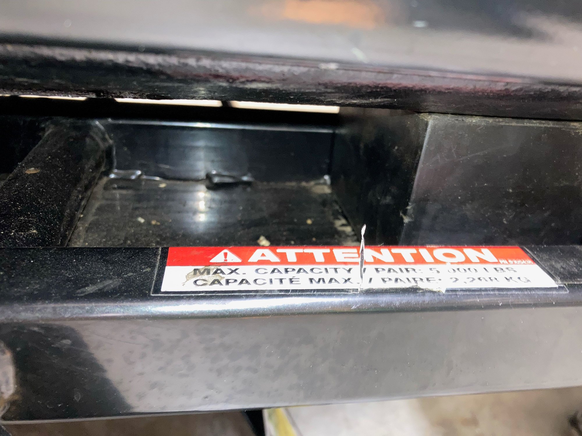

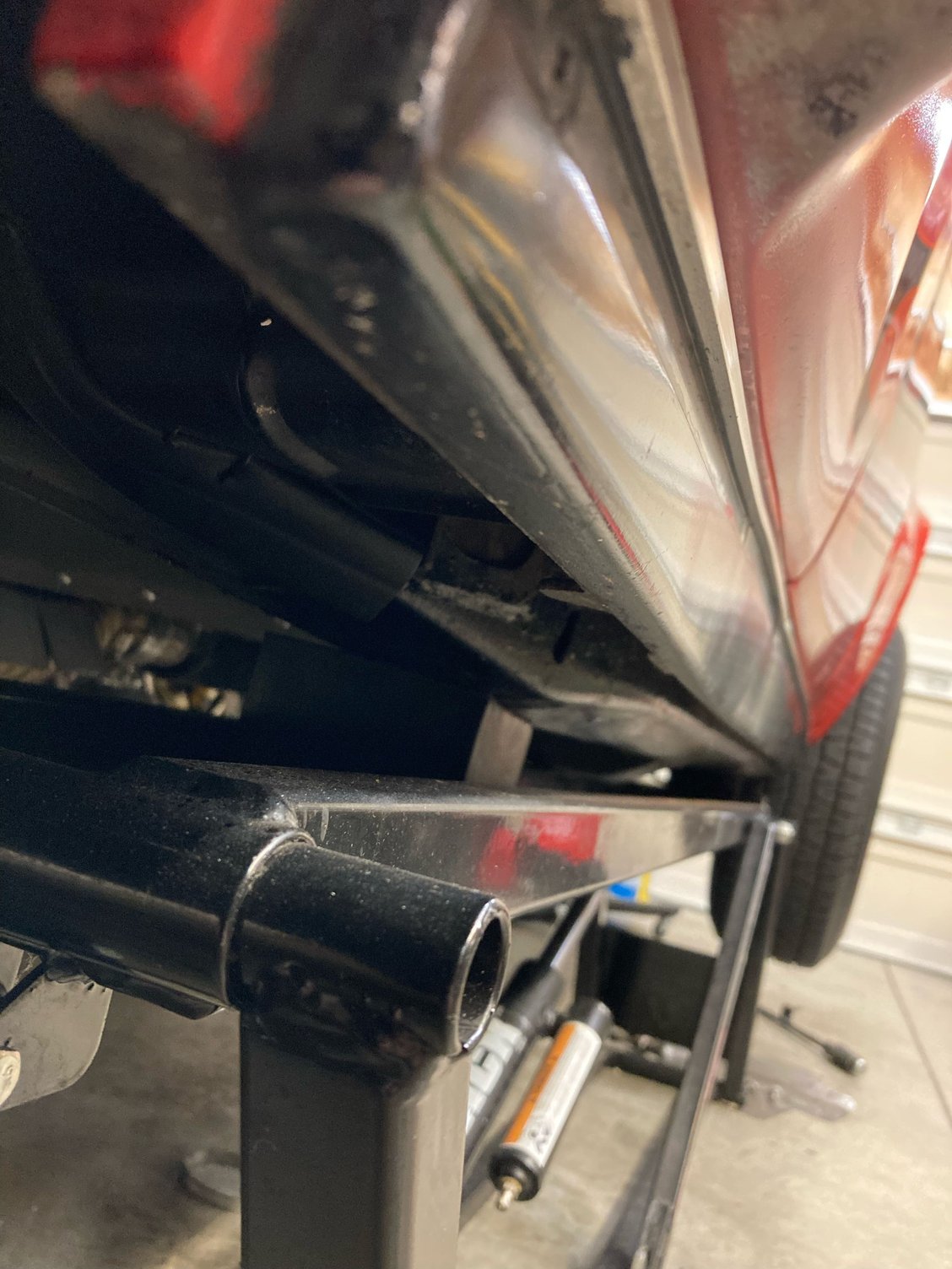

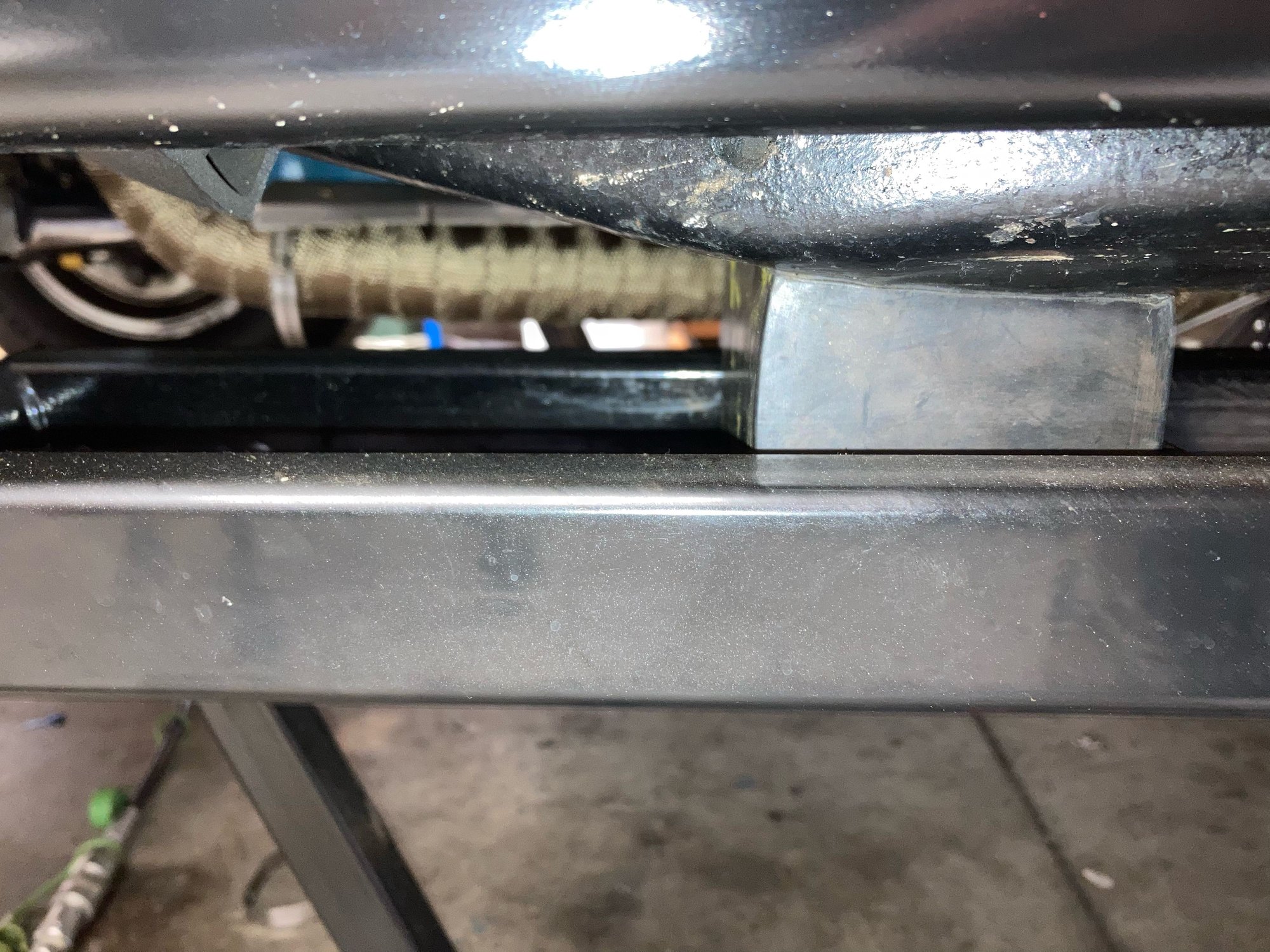

I have a 7000SLX, no problems. A bit tight with the side exhaust up front, required a specific height spruce 4 x 4 to make life easier. I have 17" rally wheels.

The 7000TL model I'm interested in requires 3/4" more room between the tires than your 7000SLX does and that's the "critical unconfirmed" dimension I'm worried about. In your pictures it looks like there is more than 3/4" excess room available to fit between the tires even considering the 2" buffer QJ mentions in their measurement guide.
