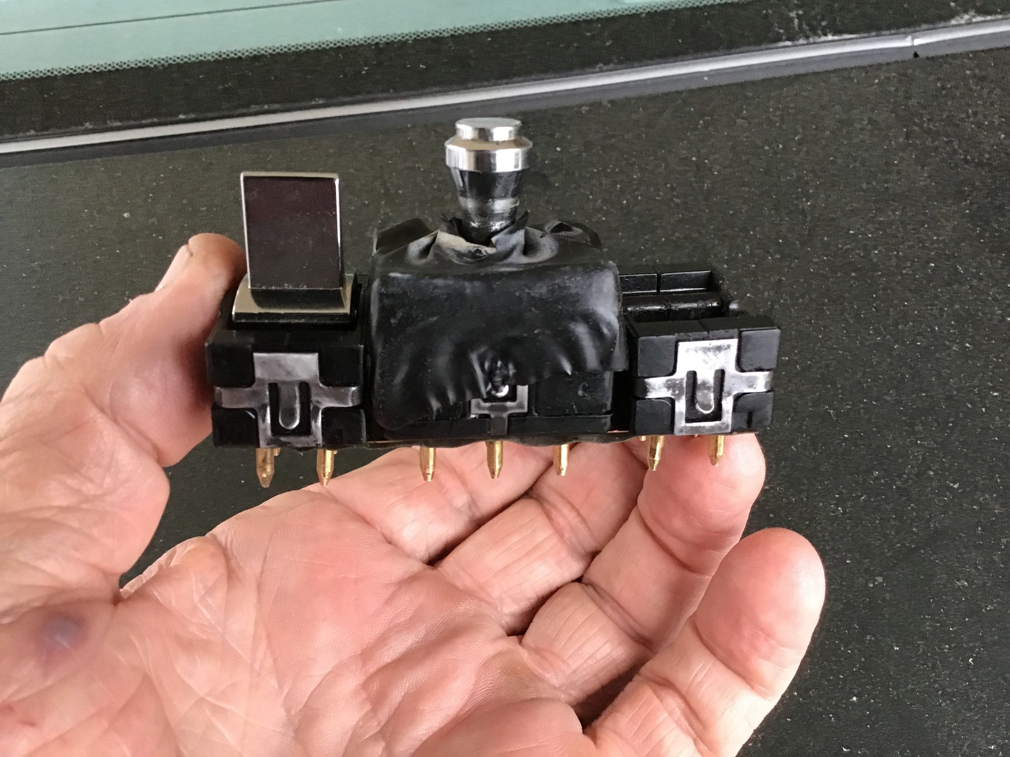

None of my power seat buttons work,so took it off the seat and unhooked the wire harness going to it,sanded the contacts and spayed with WD40,and hooked the wires back up and nothing,so where can I get a replacement from.

Are you sure you are getting power to the switch? Post some pictures, they would be helpful for us so we can help you.

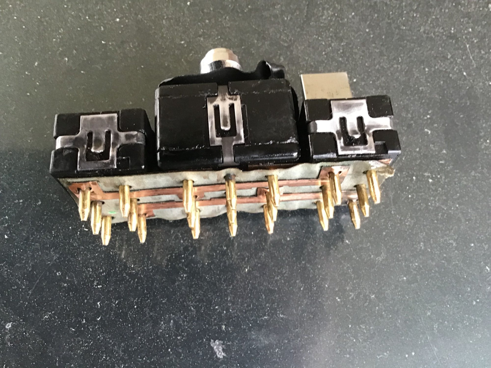

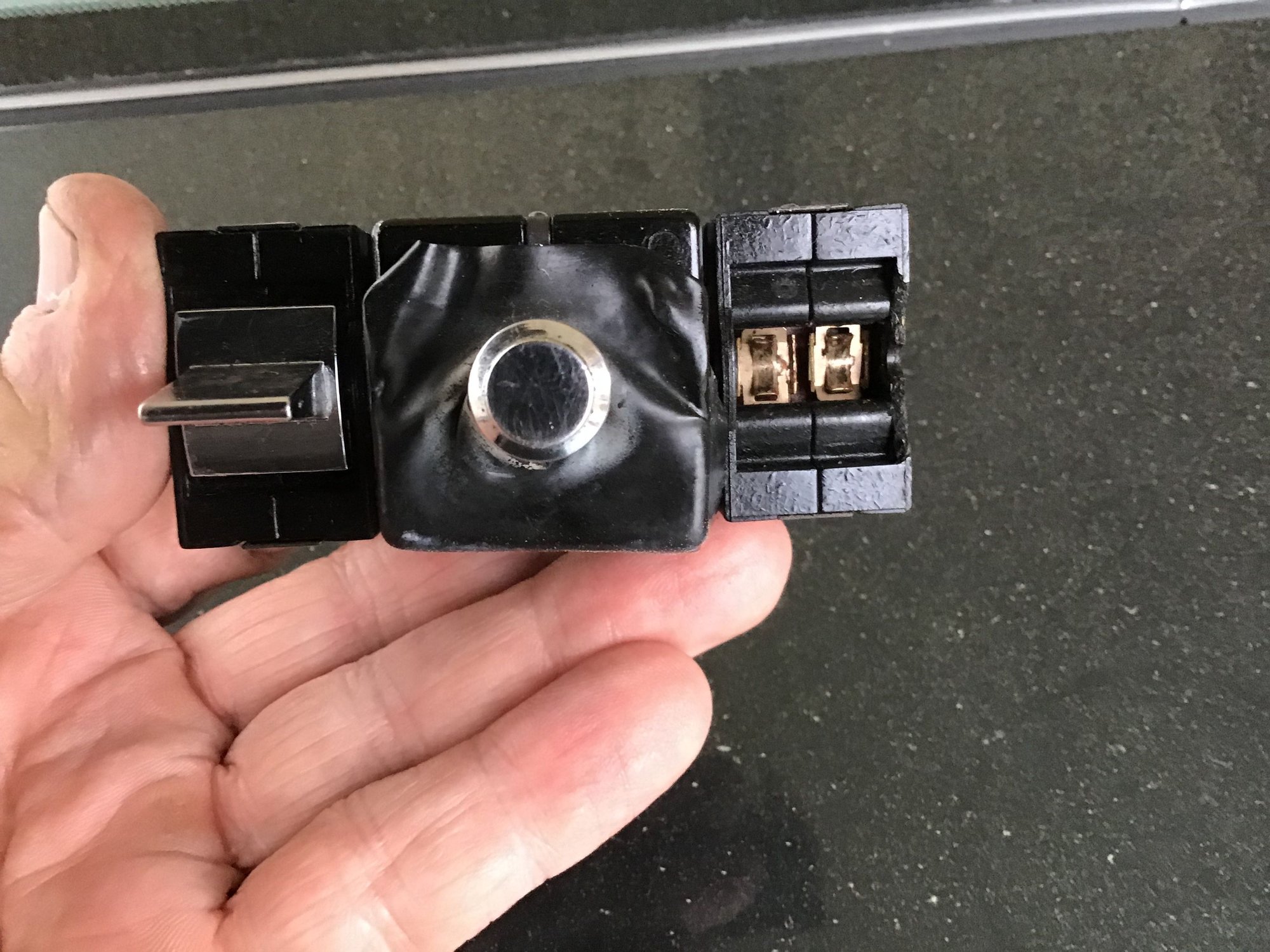

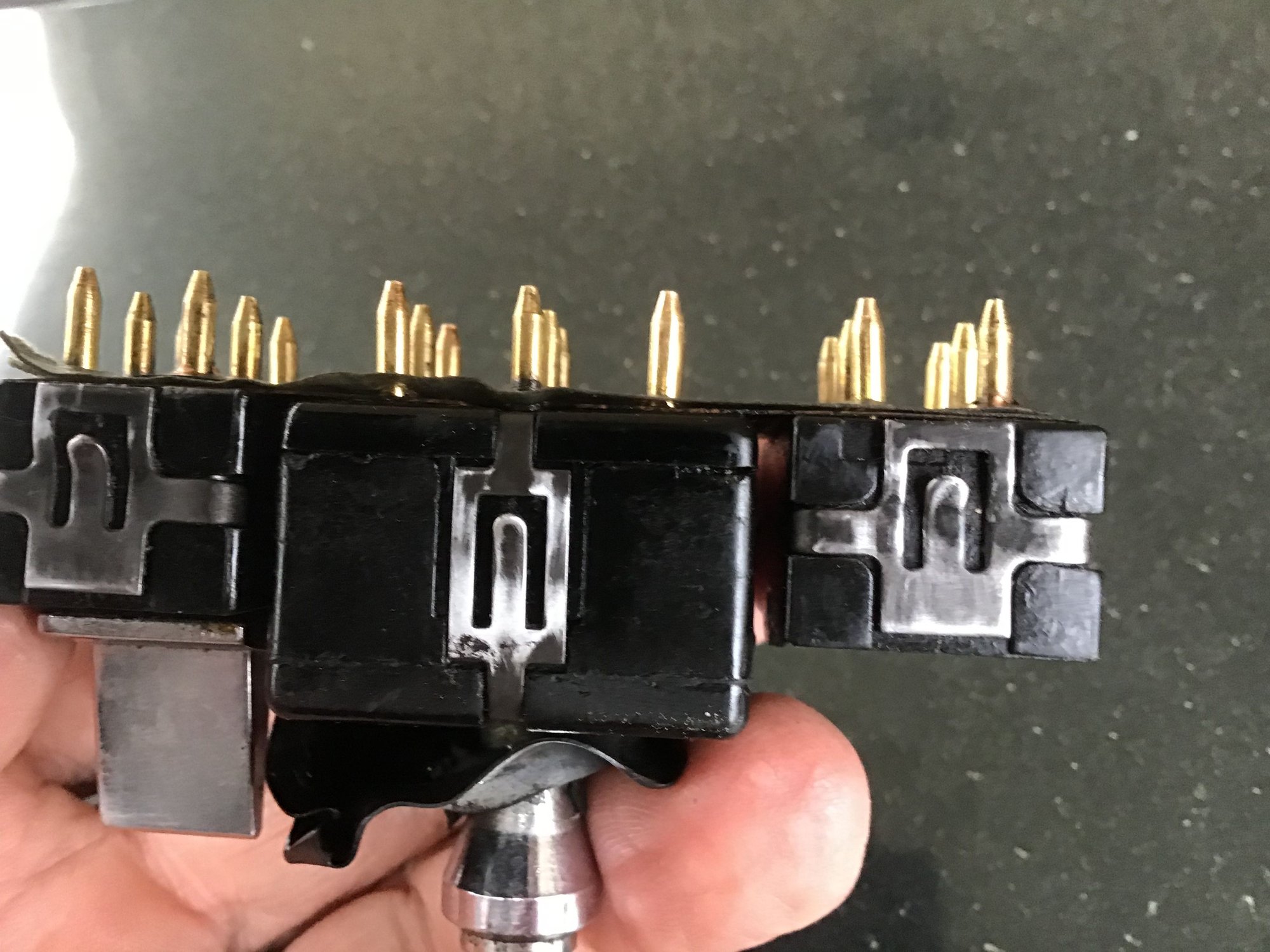

Looked for a fuse didn’t find it,so no not sure it’s getting power,is there something I could check with a meter or something,here are some pictures.

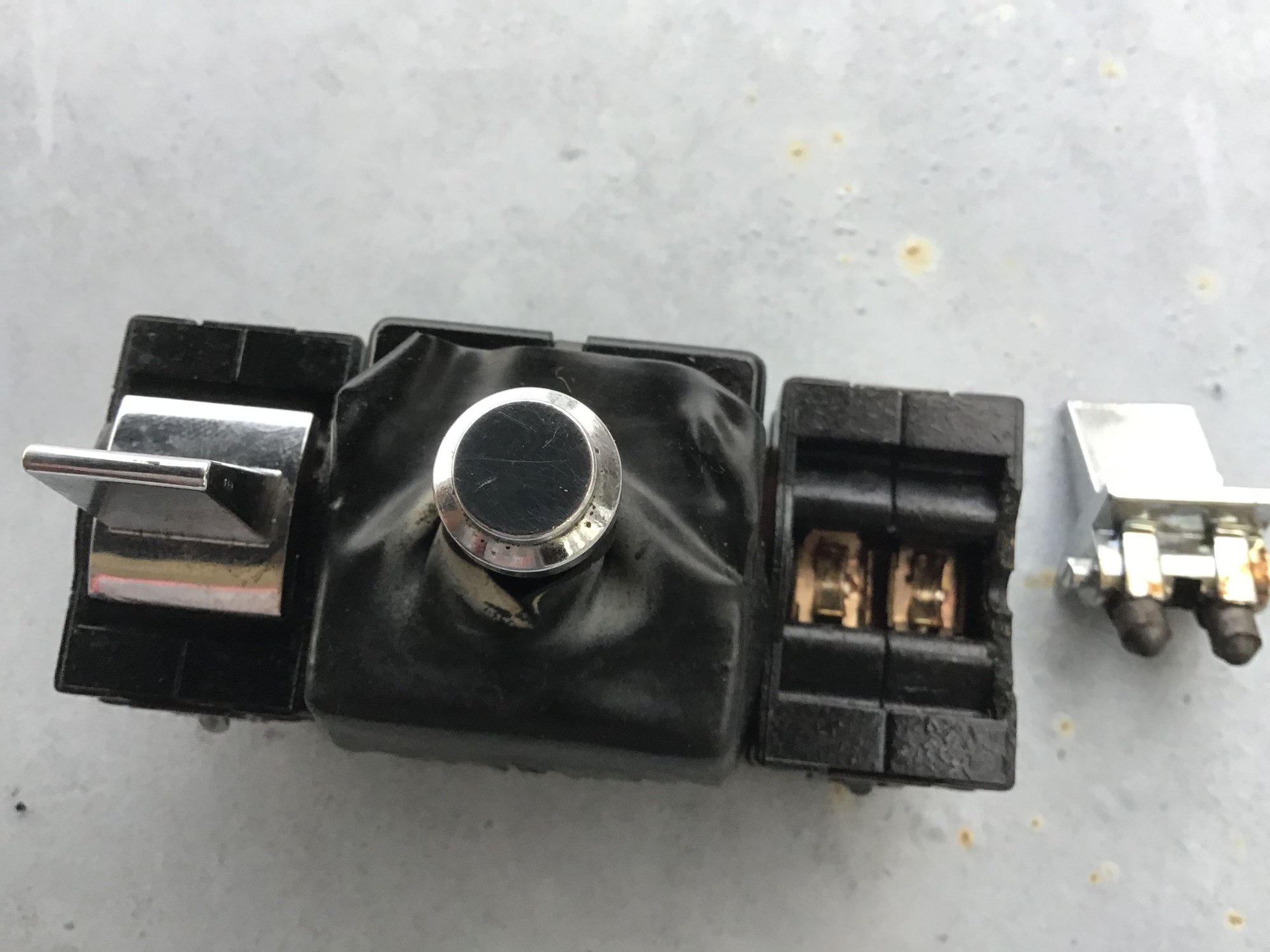

It uses the 35 amp circuit breaker which is also used for the power windows. You will find it at the top center, slightly to the right on the fuse block under the dash. It is a silver looking part. There are two on the fuse block but you want the one at the top, should be marked Power Windows.
Now under the seat is a harness running from the power seat harness back over toward the center console. It will be a two wire lead and should be a pink or orange and black harness. Just follow it over to the main switch harness and that will be the harness you can test. Black of course is ground and the orange or pink wire will be the hot power wire.
The switch itself is almost impossible to find and expensive if you do find one, even used. Looks like yours is broken on the one switch mounting area.

thanks,yea I broke that piece,and I bought from a short woman,and I’m not tall at 5/10,and I’m crouched up driving,I’m assuming no manual way just to get the seat back.
