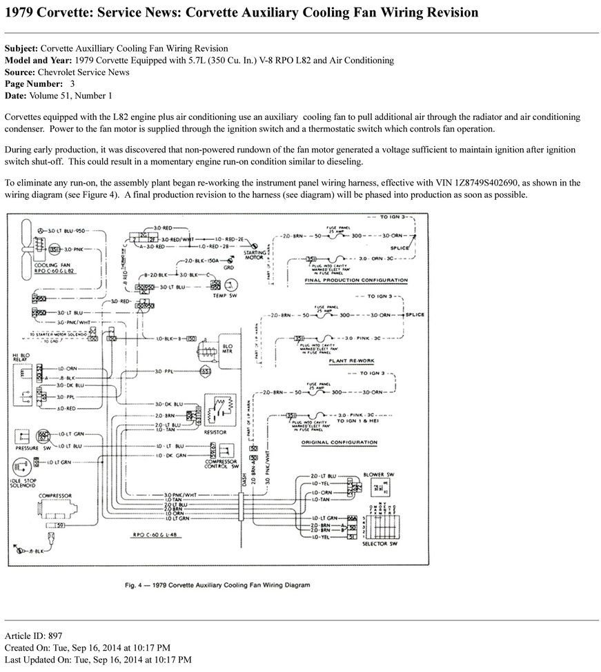

yup
wired here with help
https://www.corvetteforum.com/forums...ss-option.html
the oem electric fan was only for extreme heat, i think ~230f before it came on.
the mod i did has it come on with ac / on full time/ and as designed.

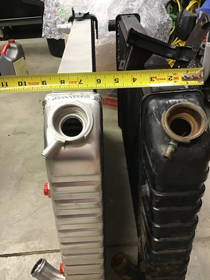

my aluminum radiator here was my fix but oem was pretty bad.. i even went trying to get recored and a couple old radiator shops said aluminum is a no brainer for heat transfer and noone around me recores anymore. 180f thermostat from 195f
https://www.corvetteforum.com/forums...nt-79-l82.html
