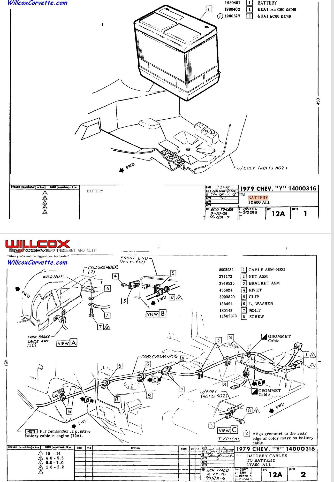

https://www.topflightautomotive.com/...AaAqx0EALw_wcB
https://www.corvettecentral.com/c3-6...de-post-173012
2 awg..what year

The car is a '79. I'll order that hold down kit. Thanks!

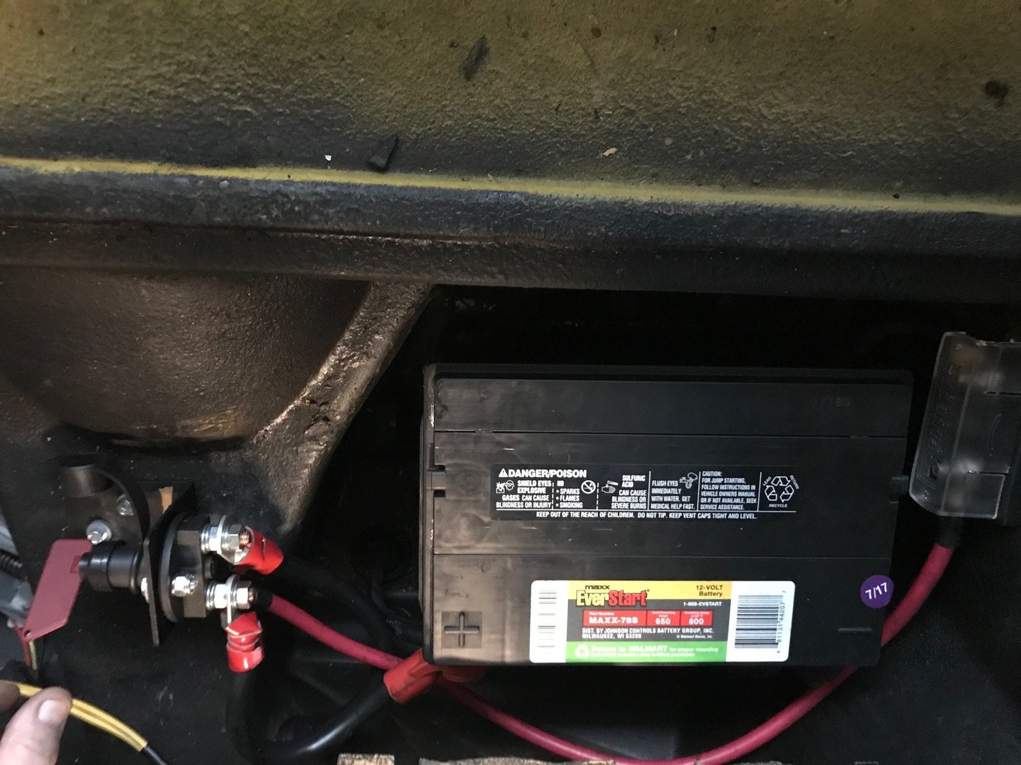

I have since added the proper insulators over the terminals on the cutoff switch, the yellow wires are going to a 12v terminal block to the left.

Looks good. Thanks for the photo.
