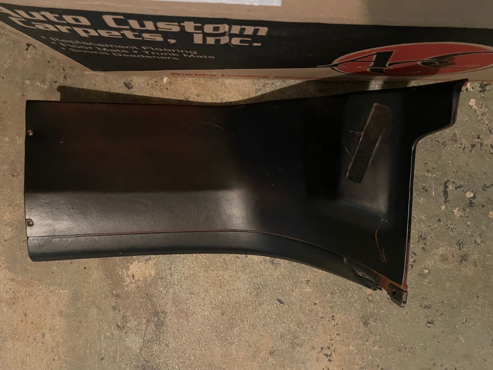

This panel covers the seat belt

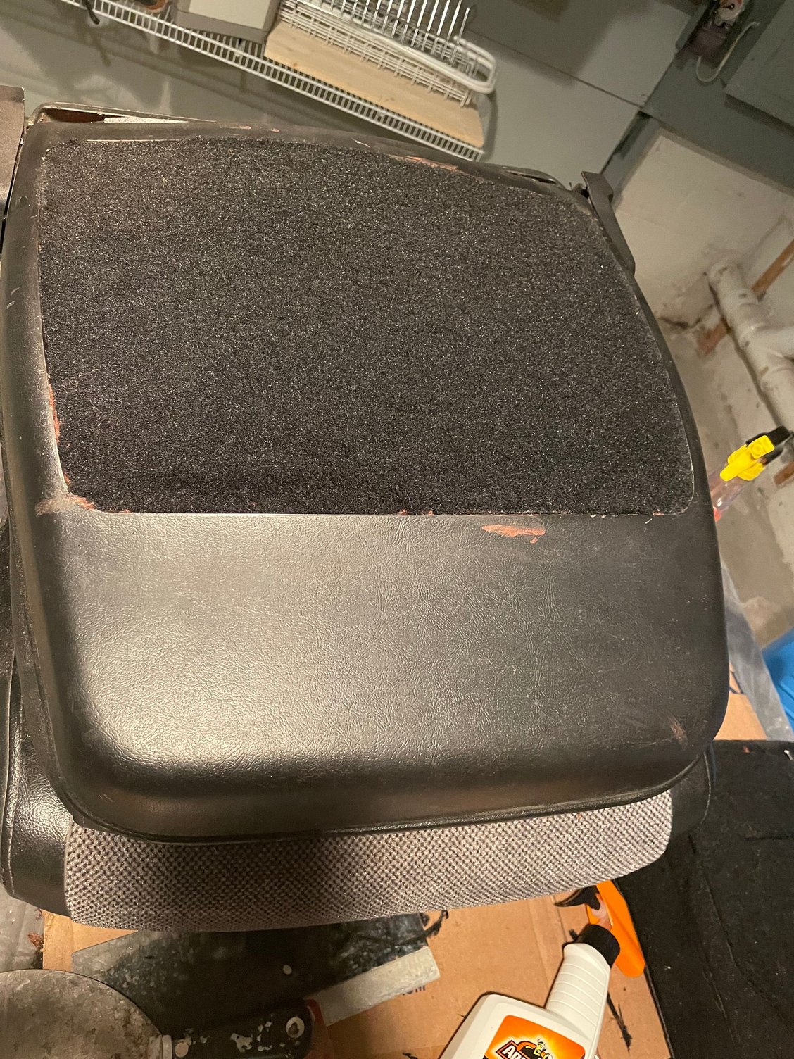

Here is the back of the seat

yes.. easy.. get a can... works fantastic.. clean well to remove wax and grease, light sprays to keep stipple..

i think you are seeing the red orig color where the black dye wore off...
what color does your trim tag say the interior is/was?

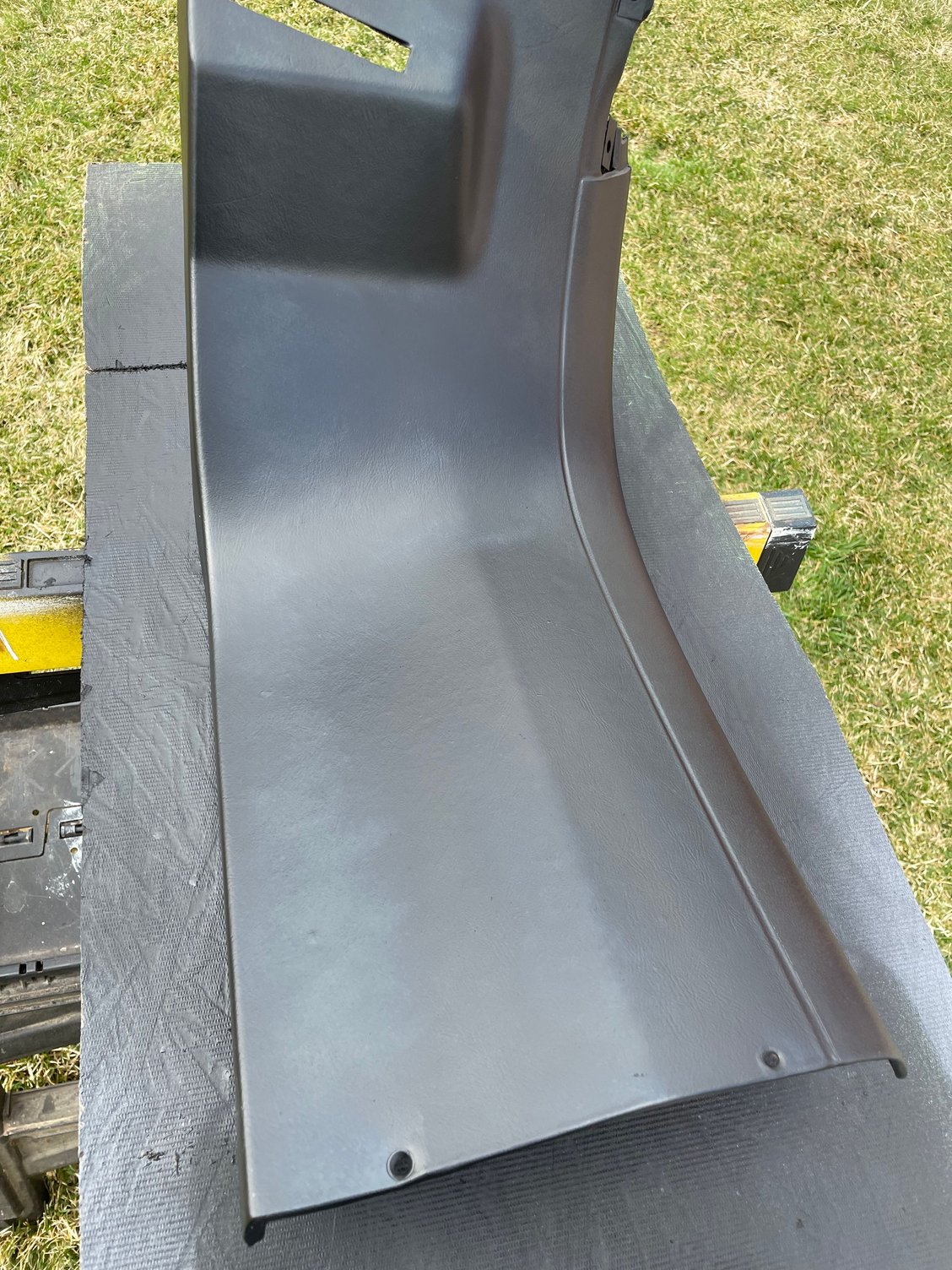

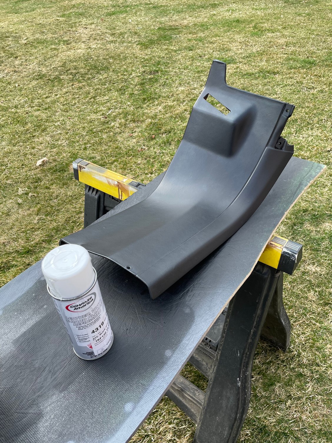

I appreciate the information I bought a can to try it and it came out pretty good. I will check the tag to see what color it was originally.

I used SEM Color Coat with great results.

Looks great! Keep light coats..like new
tape off carpet on seat back and spray will look great..
