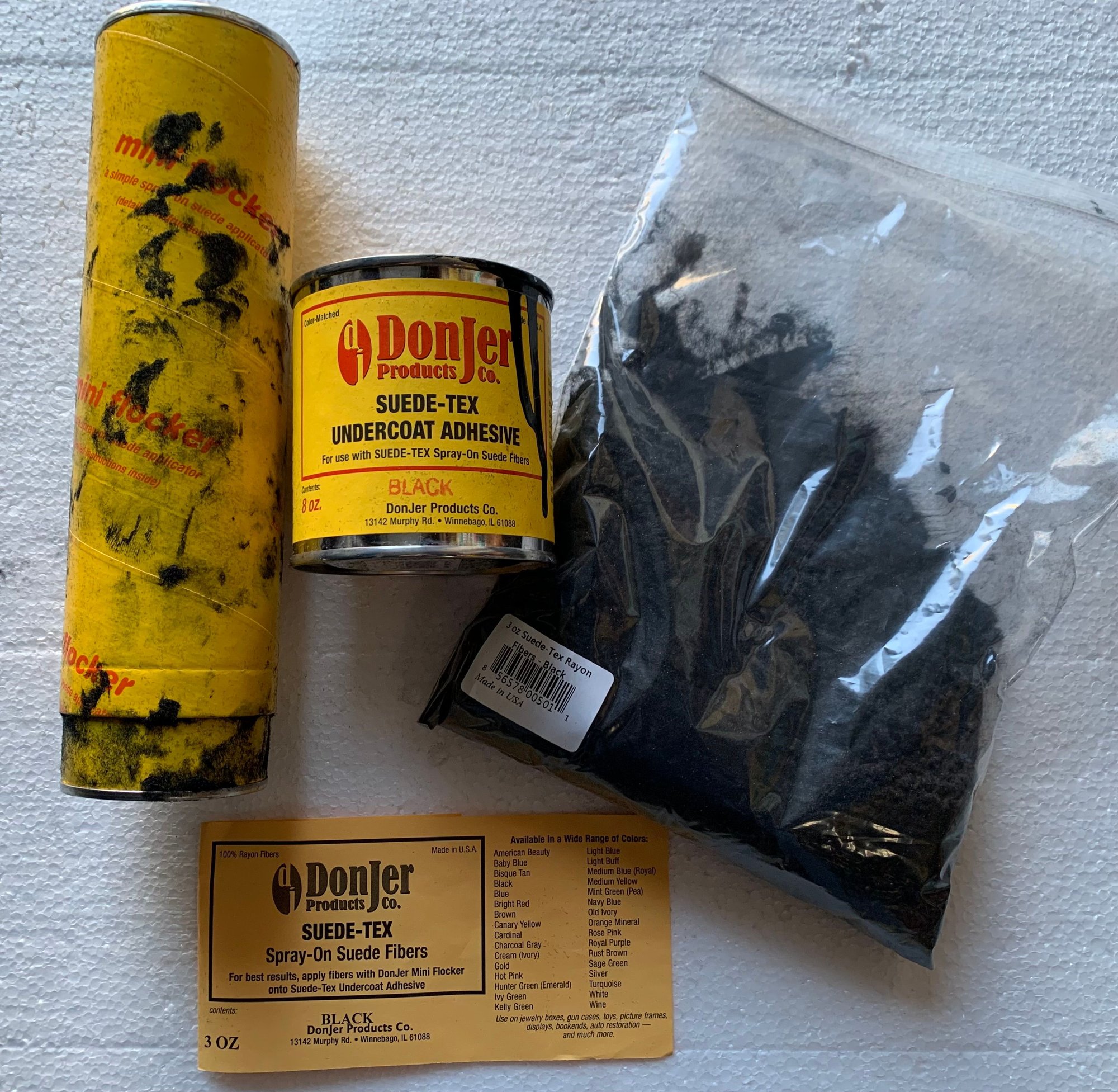

Not sure if you are looking for someone to do it for you or you want to do it yourself? But, here is a photo of the kit I purchased from DonJer products, to restore my '73 rear storage bin tray a few years ago. I'm pretty sure the company is still in business. Just google it. This is a fairly easy and fun restoration project to do on your own.

It is the rear bin that I need to do,will this cover small imperfections on the surface?

Hate to be the bearer of bad news you really can not fix small patches of missing flock. When I was restoring boxes you need to remove all of the flock then apply the glue and then the flock material. Doing a small area will stand out from the original flock. If you want you can contact me through PM and I could give you hints on how to do a full restoration of the box that would cost no more then doing the piece in flocking.
