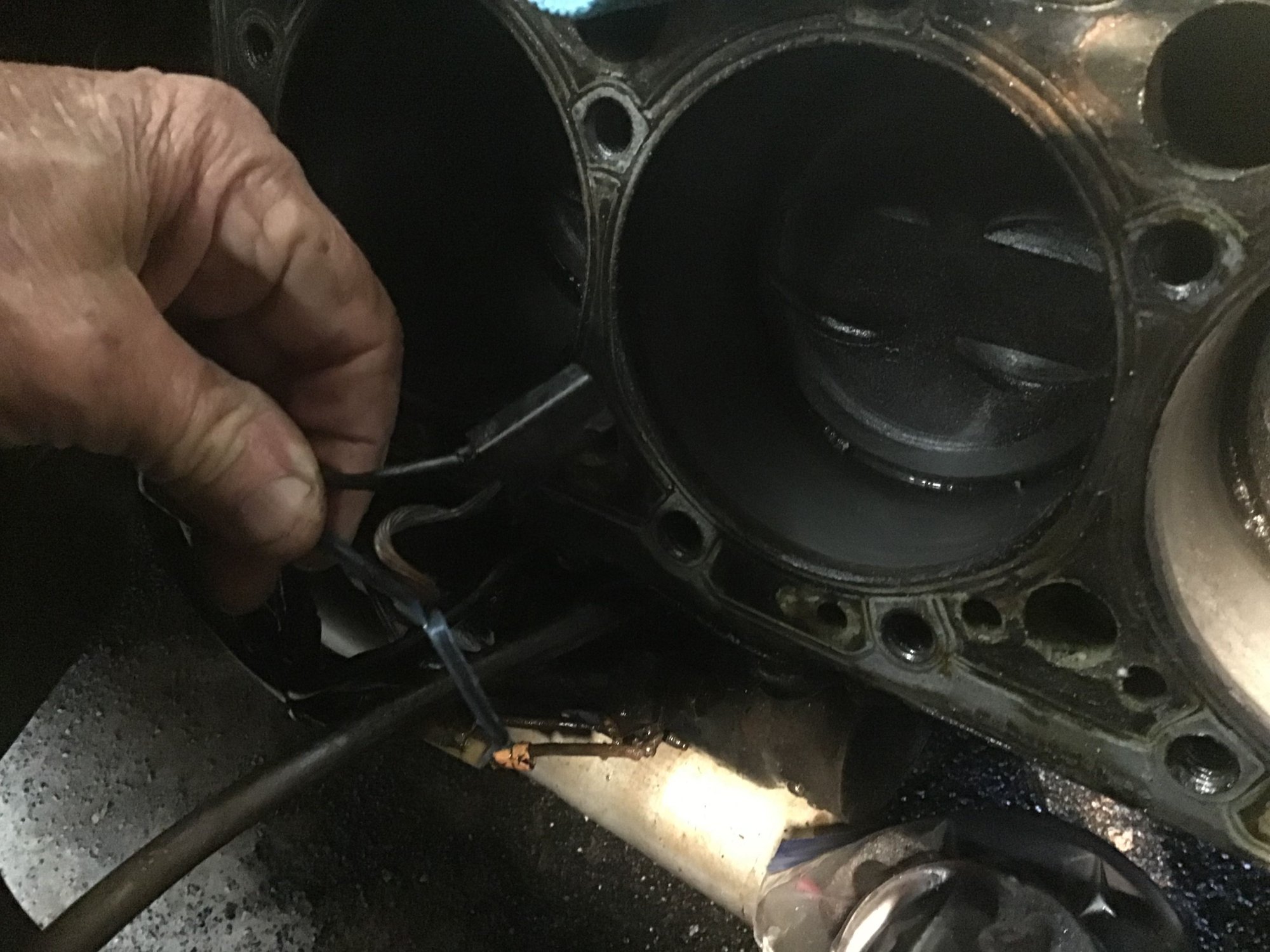

Here’s a blue wires,because it’s 2 wires from the connector,I noticed a few weeks ago,and If I remember correctly it was bolted to one of the transmission bolt,like a ground but not sure where it was connecting to.
Anyone have any clue.

WHAT year what transmision plus a better pix

Sorry,1981 TH350.

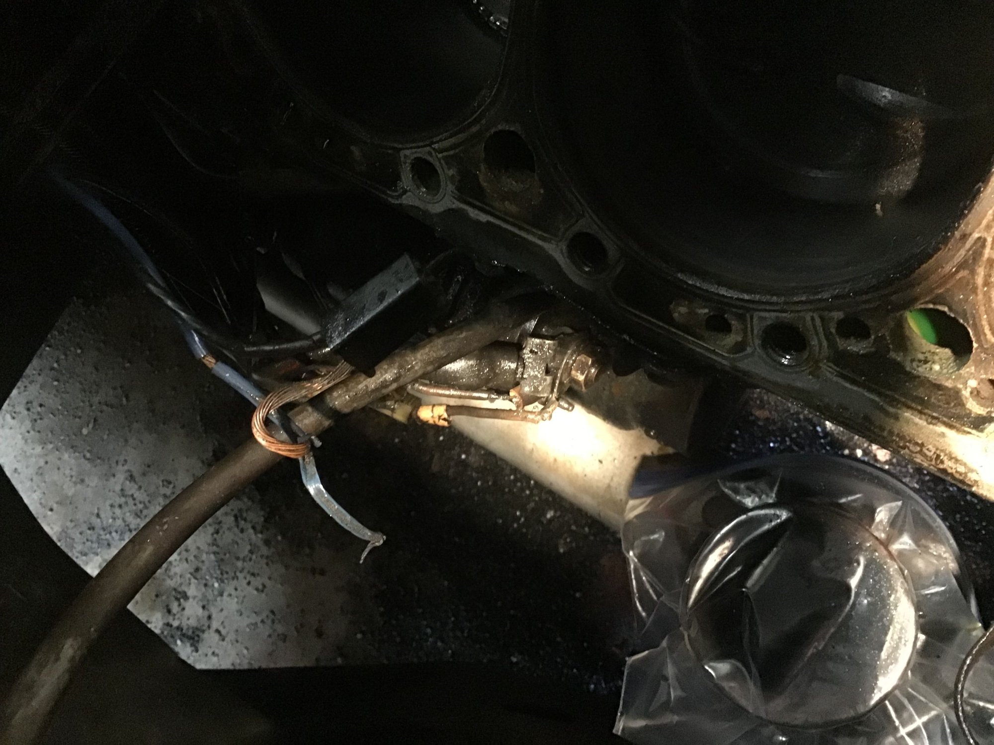

Those wires go to the aux fan temp switch in the r/s head. Black is ground, blue goes to the aux fan. Here's my 82. A green dot is on the temp switch.

When switch closes the LT.BLU wire is the ground path to cooling fan motor...
This drawing is from a 79...
