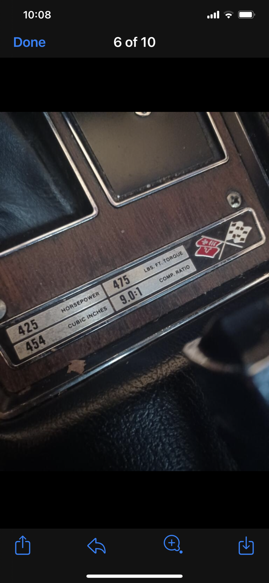

Picture of the motor and does he have any documentation in regards to the motor change?
The tag on the console is most likely from a 71 LS6.

I will get pic of motor and hope I get all the correct stuff. Problem is man is suffering from dementia. But thank you

So, while this may be a nice car it is simply a "converted" car with a GM supplied engine that will not have matching numbers.
And yes the console engine CID/horsepower tag can be purchased from any of the vendors.
Still sounds like a cool car but not really "rare", more like "customized".

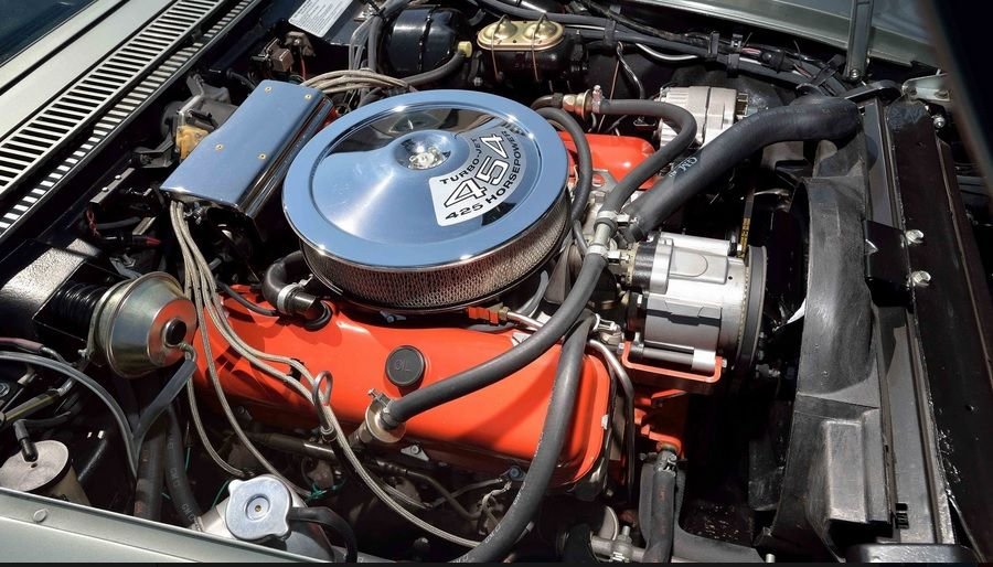

Does the engine look like this?
