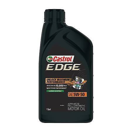

I like using their full synthetic.

Do either of those quote exactly how much ZDDP they contain?

I found this:
5W50 Castrol Edge with Syntec API SN, synthetic, formerly Castrol Syntec, black bottle = 75,409 psi
zinc = 1252 ppm
phos = 1197 ppm
ZDDP = 1200 ppm
https://www.autorestomod.com/oil-zddp-list.html

That's good to know for when I use my last can of old stock Mobil 1 from when it had decent zinc content.
