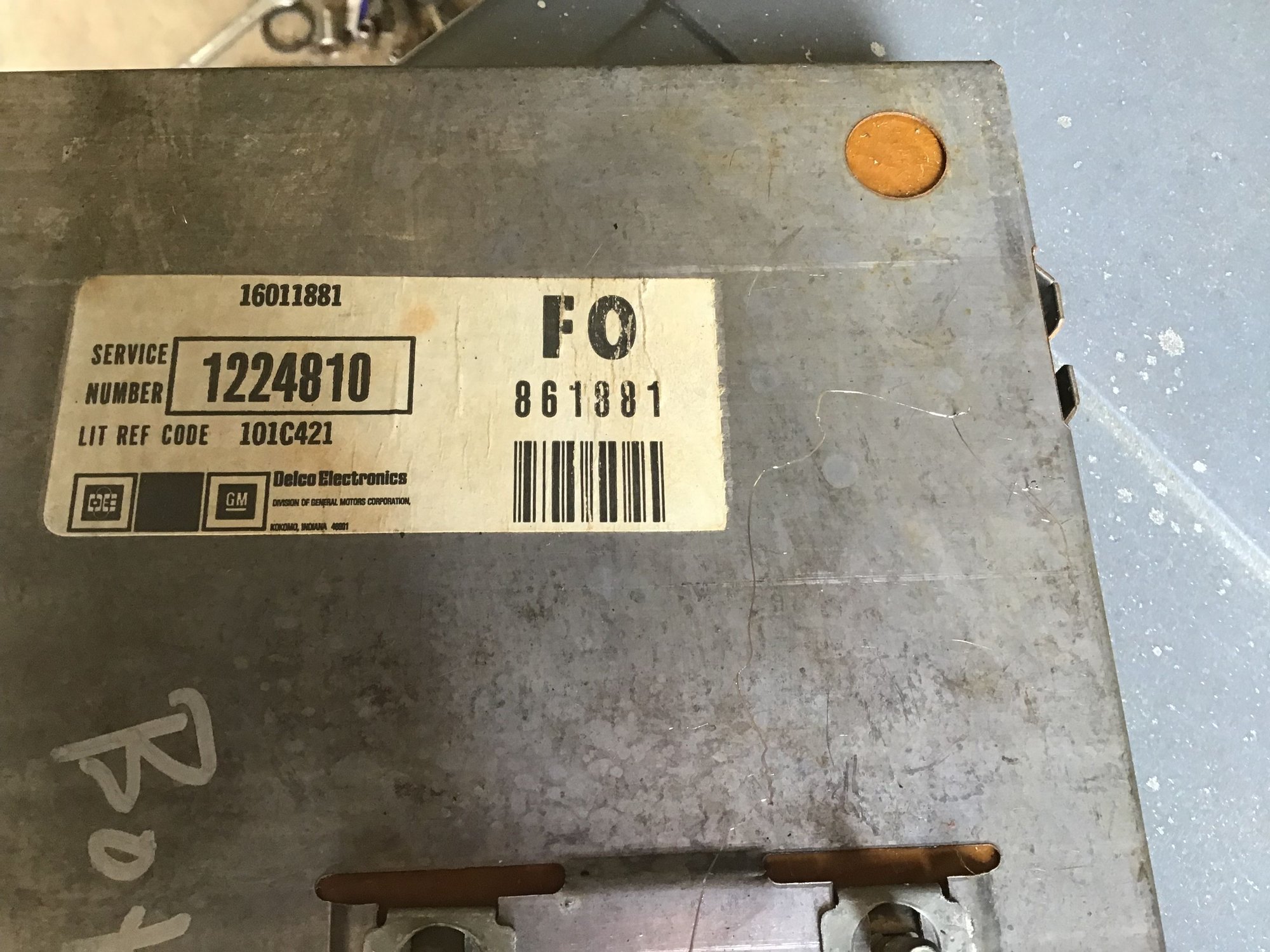

Well,since I’ve pulled my engine apart,thought I would pull my computer system out,next few days will pull all those wires out.

apparently the CCC-e4me wiring harness is stand-alone. it is not integrated into the engine harness. but essentially an add-on to the 80 harness. so it will come right out. parts list to convert to non-CCC setup: carburetor, distributor.

do you have a picture of the harness and parts you removed so i know what im looking at when i remove mine

I did the same to my 81. there is only one wire that is part of the harness that runs under the console. It's the a/c wire that connects behind the e-brake and upto the center right of the firewall. That was the only outstanding issue I found. Once I added a new wire to connect the two, everything worked as planned.

please take lots of pics,of everything in-place before taking it out,,then lay out the harness and computers too
