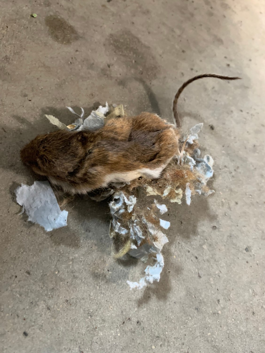

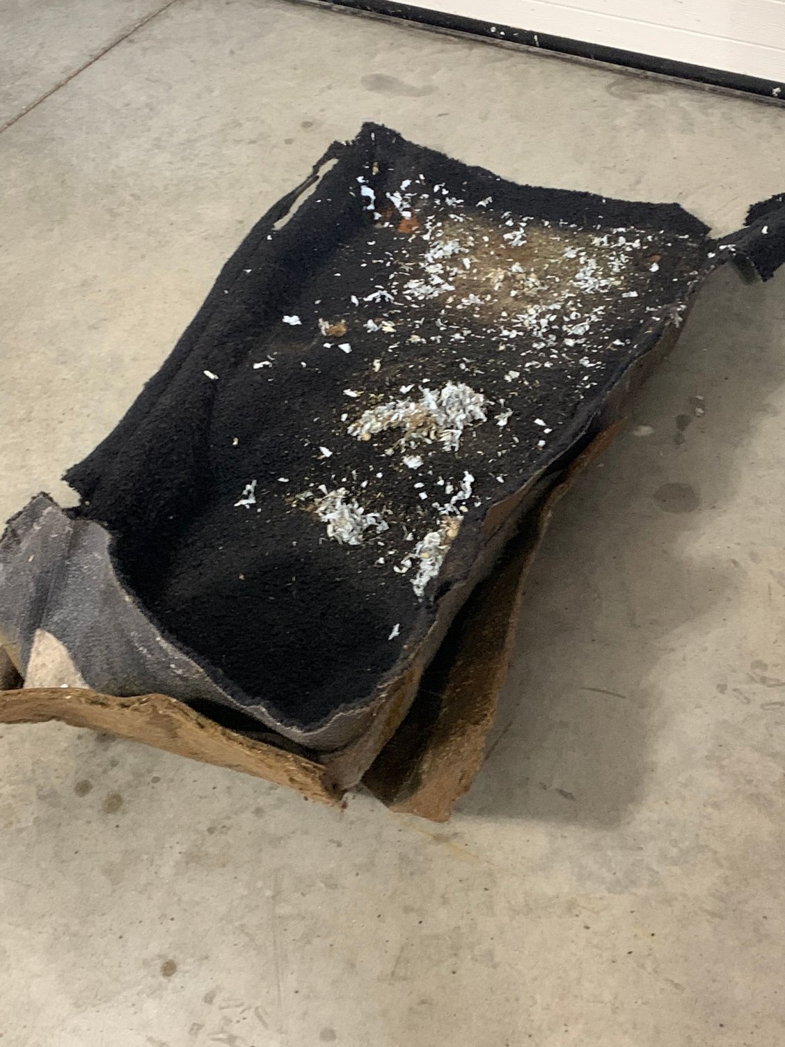

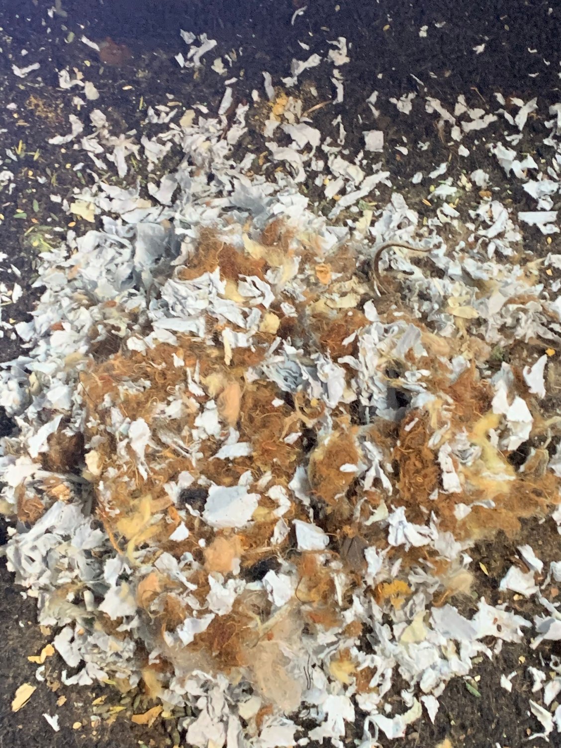

1969 Tripower L71. Triple Black Convertible with Black removable Hardtop.
Noticed an odor while driving… Yea, don’t ignore odors.

Yes thanks . Hopefully carpet replacement will do the trick. And i wore mask and gloves for sure.

So, was it just one mouse?

Yes just one mouse.

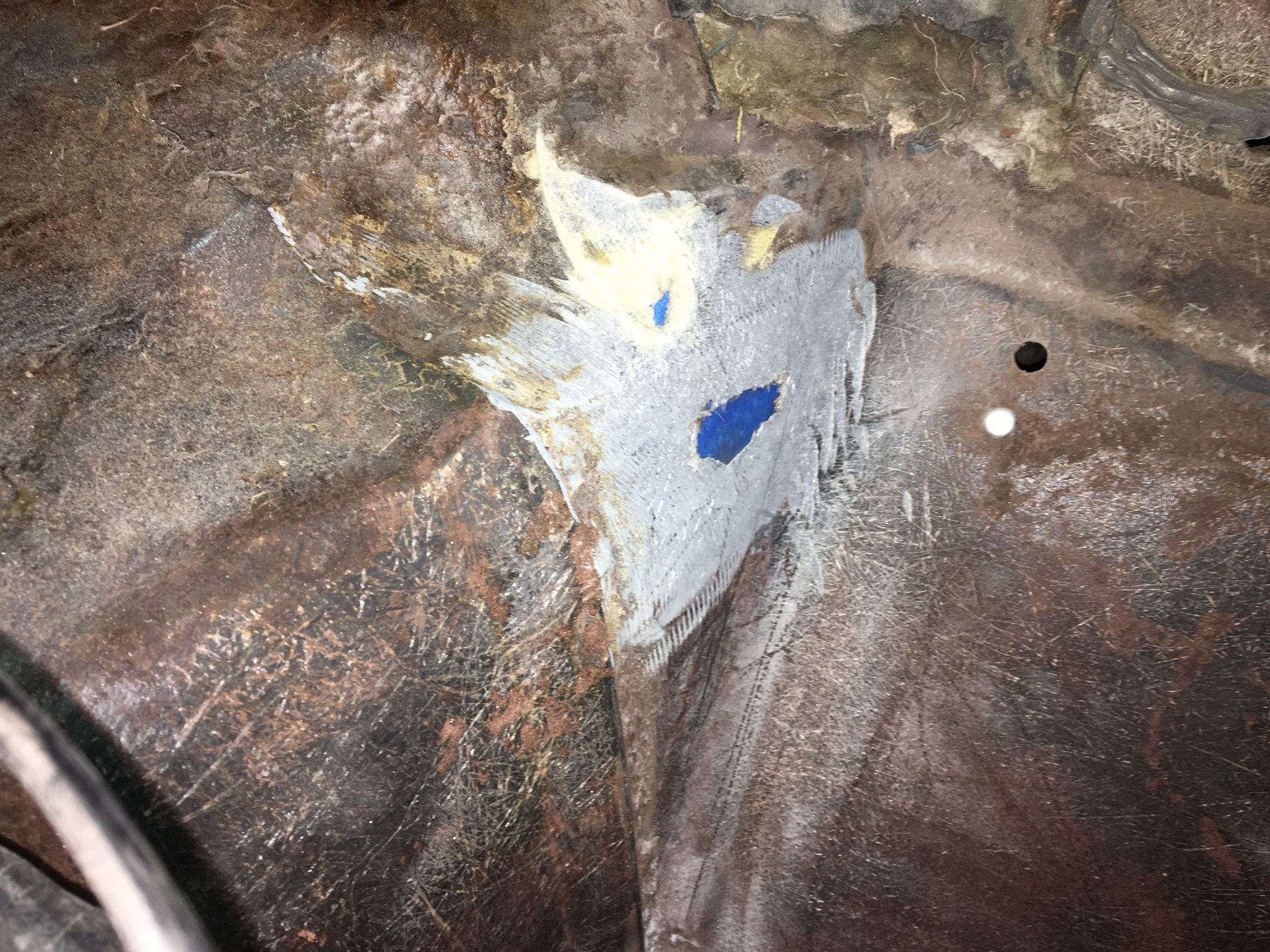

Now finding holes and cracks in the floor pans near the feet. The whole thing was a blessing. Do you guys put down dynamat? How do ya fix a crack in the floors fiberglass near the pedals?

Stop stumping on the gas pedal. I am sure a better pic of the area would help.
My very basic understanding, basically you feather the edges, roughen everything then add some Matt soaked rain in layers in both directions to reinforce the area. Sand smooth and your good to go.
I think it’s a common area to see a crack.

Originally Posted by medicdunlap
Yes just one mouse.
Grind the cracks down from top and bottom so the crack opens up to 1/4 - 1/2 inch, feather the grinding a few inches from the crack put some tape on the underside so it doesn't sag. Lay new glass from both sides. Cleaning everything up and putting it back together is the time consuming part. The grinding and laying new glass will only take an hour or so. Laying glass on the underside is a bit messy. Wear a good mask when grinding, you don't want to breath any fibers. If you use epoxy resin and are in a ventilated space, you shouldn't need a respirator. If you use a polyester resin, you will absolutely want a respirator. Got the repair technique from body/paint guru DUB.
When you get in there you'll find all sorts of "while I'm here" things to fix. I was missing about half the rivets between the birdcage behind the seats and the fiberglass seat well. I laid a different product than Dynamat that works really well. was easy to work with and less than 1/2 the cost.
Beautiful car you have there.
This was one of the small repairs. I had several much larger cracks. It's all solid now.
