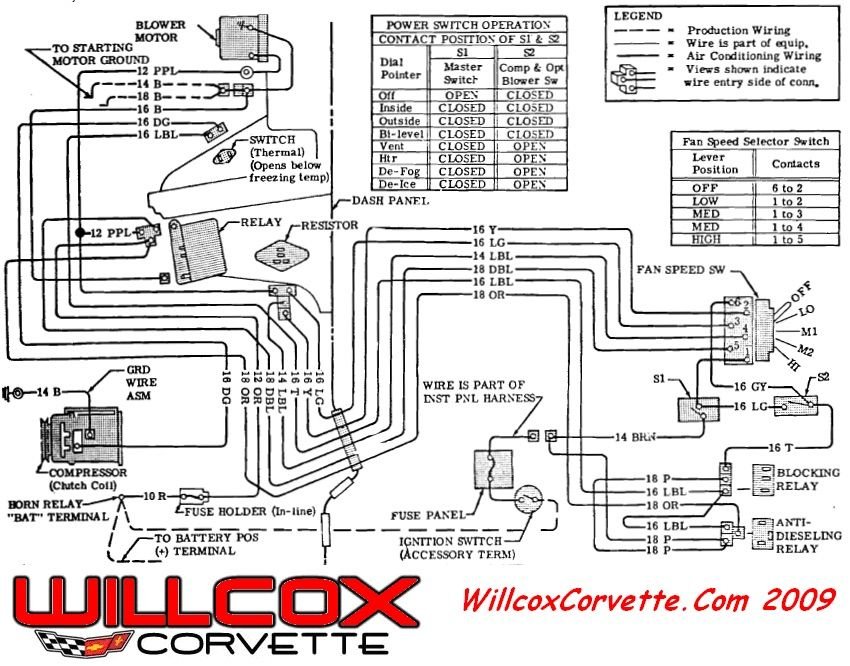

Well, I found that the thermal limiter fuse is missing, and there is a jumper wire on it. Time to get the gauges and start the real trouble shooting. Not looking forward to it, since I never use the AC anyway, but I just want everything to work on this car. This is literally the last non-working thing. Even the original radio and alarm now work.

Are you POSITIVE what is in system? Do you plan on getting r12?
this link may be helpful
https://www.corvetteforum.com/forums...ompressor.html
if you are not sure what’s in it I would flush see if compressor metal in system and replace the part mentioned above. Then you decide on what refrigerant and just as important type of oil to use.

Is the compressor clutch engaging? You should be able to hear it "snap" together, then see the center shaft turning. If that is not spinning, gauges will do you no good.

I believe the clutch is engaging, but I don’t hear a snap, but I can see what I believe is the clutch on the front of the compressor spin when the AC is switched on. Is there some way to check to see if it is actually engaging and not just spinning? Thanks

Not being familiar with AC systems I'm still learning, but here is what I've found. The clutch disc is external and I can move against the springs when the AC is off. When the AC is on, it does engage. I can hear the click up close. But here is the BIG takeaway. Looking at the hose that connects the can of freon to the service port, I can now see that the fitting is unable to depress the shrader valve so of course it wont let any freon in. I have two hoses, one I bought off Ebay for use with R12 and the other that came with on old R12 refill kit. Unfortunately the one with the kit had deteriorated rubber in the fitting so it's unusable but I can see it would depress the valve. So I don't know if this is the only problem, but while the EBay fitting screws on, it wont depress the valve so it wont work. I am going to get a loaner set of gauges that should have all the fittings, so hopefully it will work. I also ordered some new thermal limit fuses so I can replace the one that was removed and jumpered. Keeping my fingers crossed.
