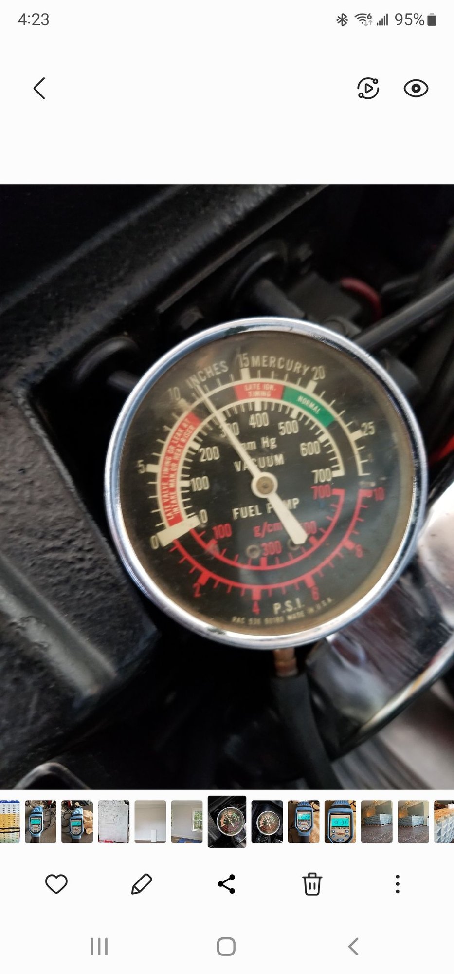

Originally Posted by Mobifire
How much vacuum should a 1970 lt-1 engine make at idle? Thanks.
From my 70 LT-1 when i was checking last summer.
