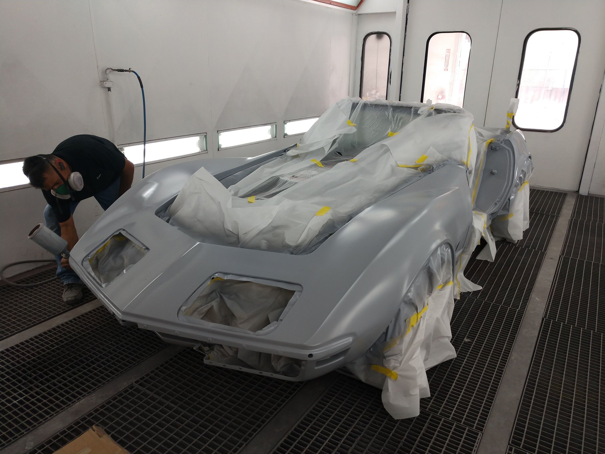

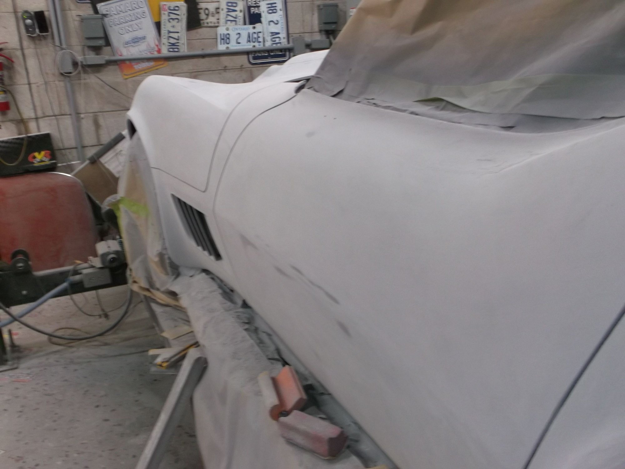

Guess we see the decision my guys made.

great pics @jgilevettes
