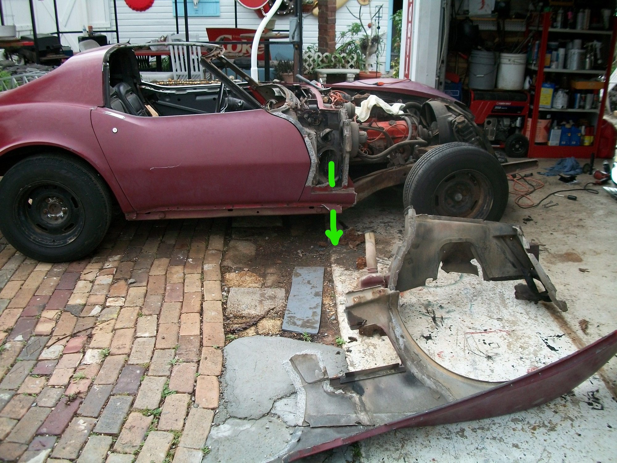

There`s a hole at the bottom of the plenum. When I removed the front fenders, it was packed solid with leaves & dirt & crap. Yours may be clogged. Look for it here.....
A couple months ago, I lost one of the plastic bushings for the wiper door down the side, but nothing came out the bottom. A strong stream from a garden hose with nozzle down the side and out came the bushing, lots of dirt, pieces of leaves, and... another wiper door bushing from someone else's work on the door in the distant past! Flushed the other side too and got also got leaves and dirt –– unfortunately, no tank sticker, cash, or diamond rings. Afterwards, the floors were wet but I'm hoping it was due to the volume of water plus the blockages backing the flow up at the lower plenum doors.
