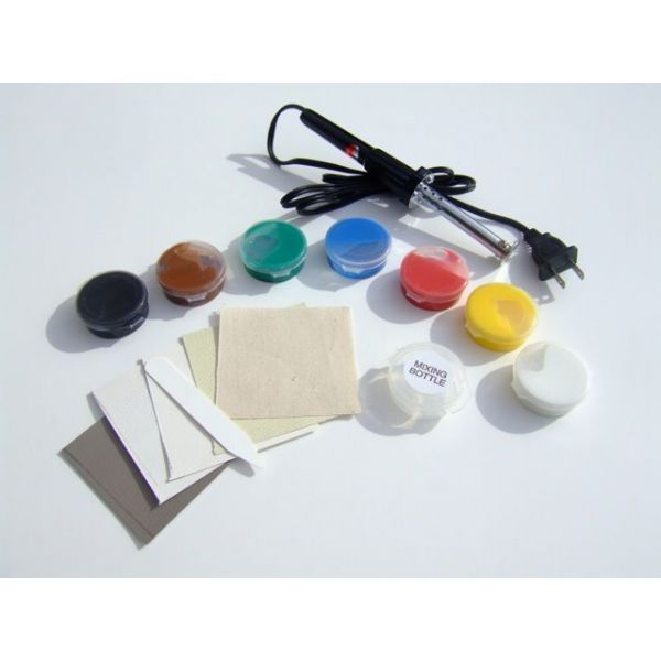

Is it black or another color?
Well, there are colored adhesive patches and things like that you can buy off ebay and heat-gun adhere. I haven't tried them. If it's black that might be the quickest and easiest ..and cheapest way to deal with it. Or even some black electrical tape if it's small and you don't really want a pro-looking repair.
This kit below may or may not work for your tear because the vinyl on the door panel might be on the softer side. But then again, I don't know why it wouldn't work. Years ago I bought that same vinyl repair kit (see link below), for repairing a very expensive armrest on a cadillac with a red interior ..that became cracked in a couple places. The results turned out great and lasted many years in a sunny environment. In my case the corner of the armrest vinyl had broken out so I had to re-mold quite a large area. The kit includes different leather-like patterns and you mix up your liquid vinyl color (to match), apply it to the vinyl, cover with the leather grain sheet that matches your repair area. Then you vulcanize the vinyl by sliding the flat (hot) iron tip over the leather pattern sheet. That hardens the vinyl. Since my repair area was somewhat larger than most, I ended up 'dusting' the corner of the armrest with some red interior color I had ..using a touch-up spray gun. If a person was looking right at it you could tell it was repaired, but the casual observer getting in or out never really noticed it. It looked far better than when it was cracked and white foam was protruding through. But if your tear is black in color, that gives you options. You might be able to find the same kit cheaper somewhere else, maybe amazon or ebay. Back in the day I bought mine from J.C. Whitney (remember them??!).
https://www.eastwood.com/vinyl-and-d...ir-system.html
Ultimately if you want a completely invisible repair, you'll probably need to buy a replacement door panel. But if the tear is in an inconspicuous location and you don't mind giving something a try, go to ebay (or Amazon), and type in 'vinyl repair' or 'leather repair' a lot of different style of repair kits will show up. Take a look and see if any fits your needs. Best of luck. Let us know what you did and how it turned out.
