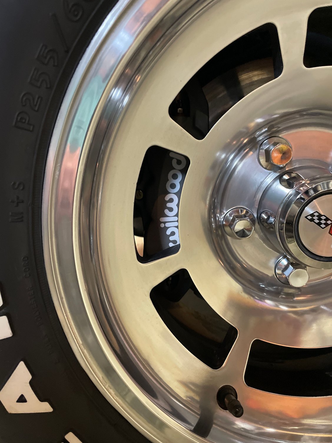

I hope! Only drive the 82 a about 500 hundred miles a year, and about every 2-3 years I go thru rebuilding the front calipers. Yes they were SS sleeved about 15 years ago.

Lip seal, last few years only drove it about 15 miles about 6 times a year just enough to things warmed up to temp. Fixed the left side a month ago than the right started to leak. I'm sure it been just a matter of to much idle time and to many Corvette's to drive.
