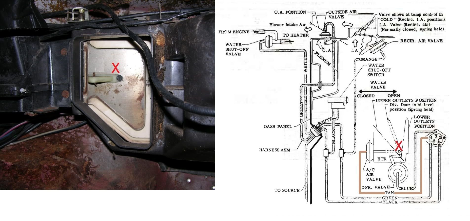

Have a 78 anniversary why is ac blowing out the bottom vents and not the top

Pull your dash and check your vacuum actuators. Is the switch supplying vacuum to the right actuator? Is the door jammed? Do you have a bad actuator?
Step one. Start checking it out.

A few things to check,
First make sure you have a vacuum signal to actuator from #4 port of the vacuum switch (Tan Line) in any of these positions...
MAX A/C
NORM A/C
VENT
Make sure actuator is actually changing state in all positions above...
There is a plastic actuator link secured to the blend door by a single screw.
This is where the link sometimes will break overtime.

If you find the link broken there is a reproduction plastic one from Willcox Corvette LINK: https://www.ebay.com/itm/13378823228...kAAOSwEaNa-t-s
Or a what looks like one made from Aluminum LINK: https://www.ebay.com/itm/16414748322...MAAOSwdppehfm5
