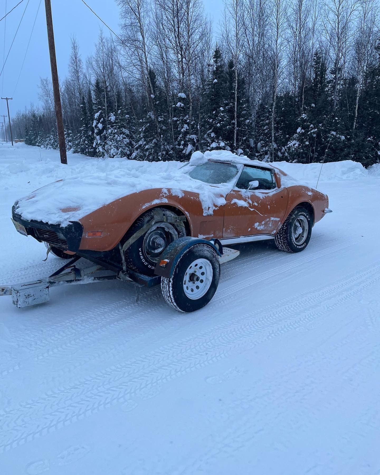

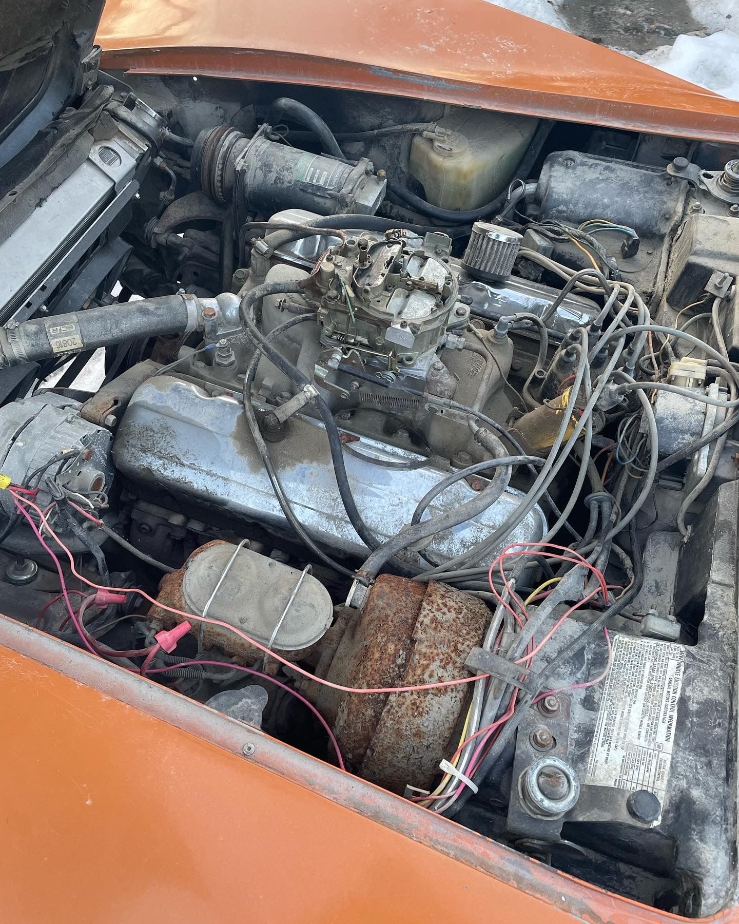

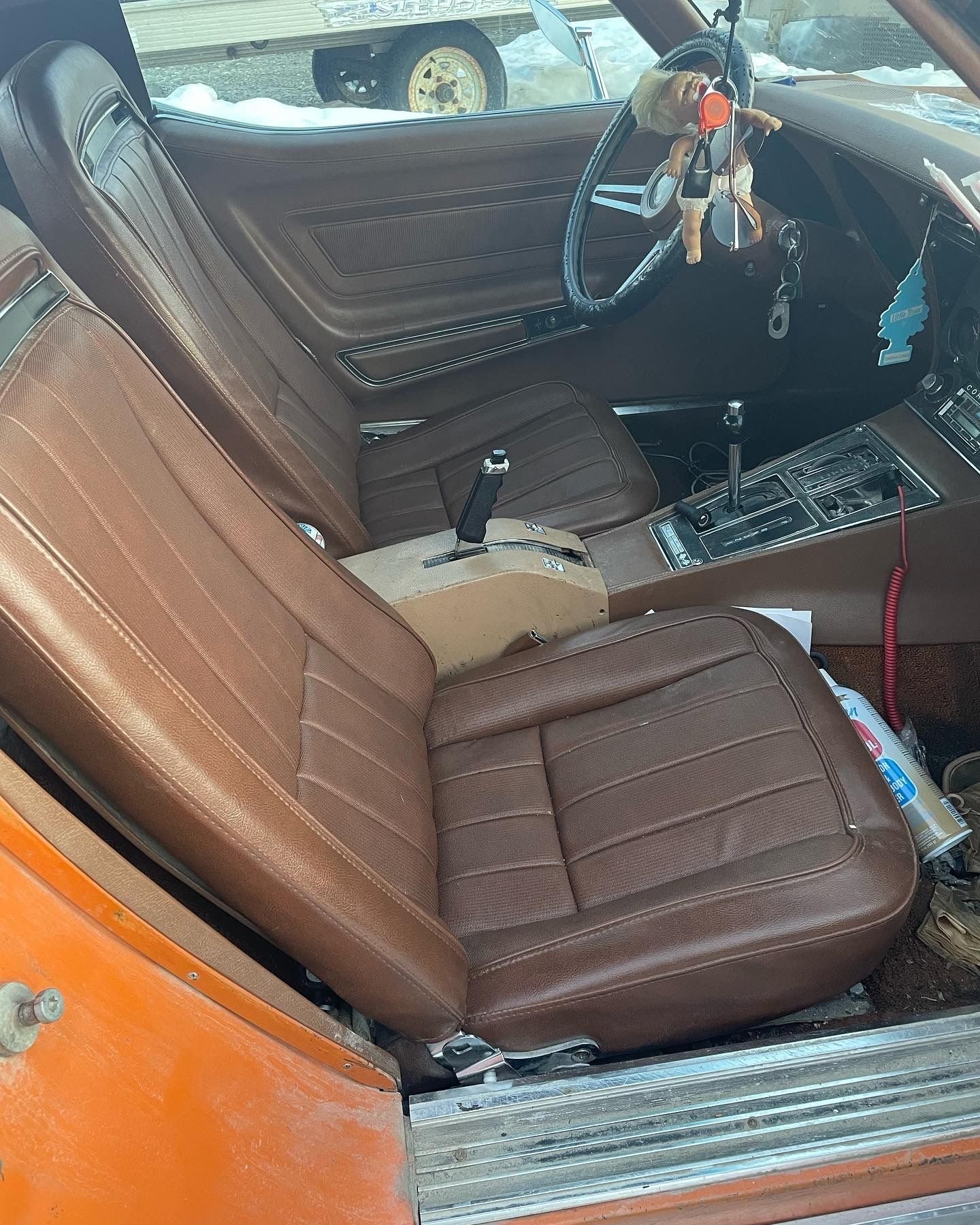

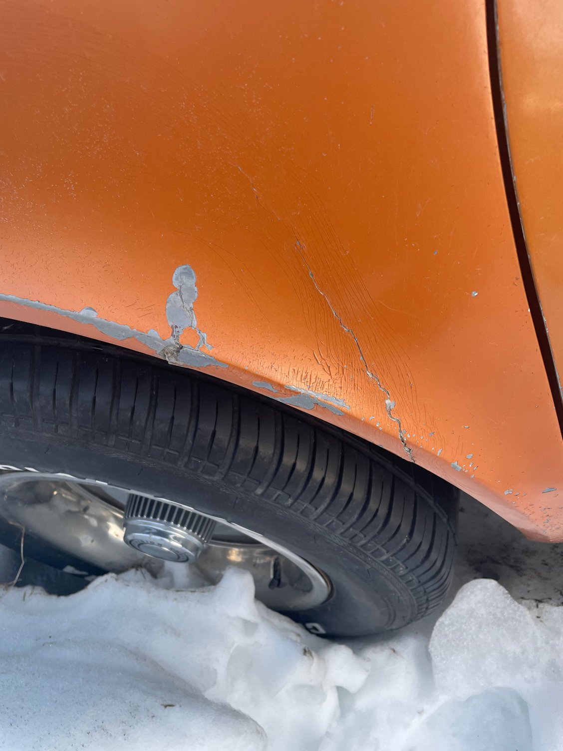

A friend of mine’s daughters were given a Corvette by their grandfather when he passed away. Now they both can’t drive it at once and neither truly have the money to restore it. I’m helping them decide what it’s worth and trying to see if I can afford to buy it for myself and work on it as time and money allows. When I was first asked about it, their mom gave me a VIN which I checked and it came back to just a base 350 car. The Corvette has 454 emblems on the hood, so I popped it open, and holy hell, it is a big block in it. After doing some research, I finally go pull the VIN off the pillar myself and I’ll be damned, it is a Z code big block car. I still haven’t made sure it’s the original engine, but from the looks of the engine bay, I’m betting it is. It is an auto car, but just easier to drive. It does have factory A/C, power windows, tilt/telescoping wheel, luggage rack and power steering. When we thought it was just a base car, I had told them maybe $5-6000, if we could get it running and driving. It does need a nose and there are a few kinda rough spots in the body, but no huge repairs. The interior looks super nice and clean. It does have some non original parts, it has an aluminum radiator with electric fans, it has an Edelbrock Q-jet carb, and needs a battery. The A/C parts are all there but the belt, so I’m sure it’s not functional. I could hear a grind, sounds like a rear wheel bearing while we were moving it on the dolly. I have not tried starting it yet, but I know it was running last summer. I have kind of an idea on a value, but am looking for advice just so no one gets screwed.

that 454 is nothing special. truck motor. body beat. bad paint. mismatched interior parts. neglect under hood is gonna be repeated everywhere. front bumper flapping in the breeze. frame and bird cage will say whether it is 7 or 8k tops or a parts car. the money to restore it? this is not a car one pays to restore.

Looking at the brake booster and master, Id be looking the the frame and bird cage. Rust may be pretty bad,

they stopped making car 454's with the LS5. and the LS5 was borderline. what i meant was it is a nothing special engine except that it is large. low compression, mild cam. and LS4 is the RPO code for a 454 in a 73-up truck.
