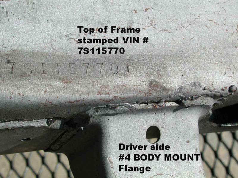

The VIN is also stamped on the frame inside the driver side rear wheel arch. A Google search should show some examples of the location.

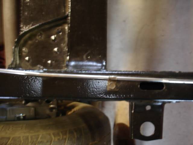

Much easier to see with the body off. Stamped right under the bolt on this 71.

Stampings on the frame, the block, and the transmission are all 9 character VIN derivatives. They do not contain a "37" or "67" designation denoting coupe or convertible. The only place the full 13 character VIN appears is on the pillar (as the OP noted) and on the blue certification label at the rear of the driver's door above the latch (as 67:72 noted).

Yes, of course. The point was not to confirm that the car is a coupe or a convertible. It was to prove that the VIN was (likely) original to the car. Perhaps a convertible got repaired, and a coupe windshield frame and VIN was used. But since the engine has been replaced, the easy way won't work.
What remains that I am aware of are the tank sticker, the sticker at the end of the door, the frame stamp, and the partial VIN on the transmission.(thanks @resdoggie for that suggestion!).
