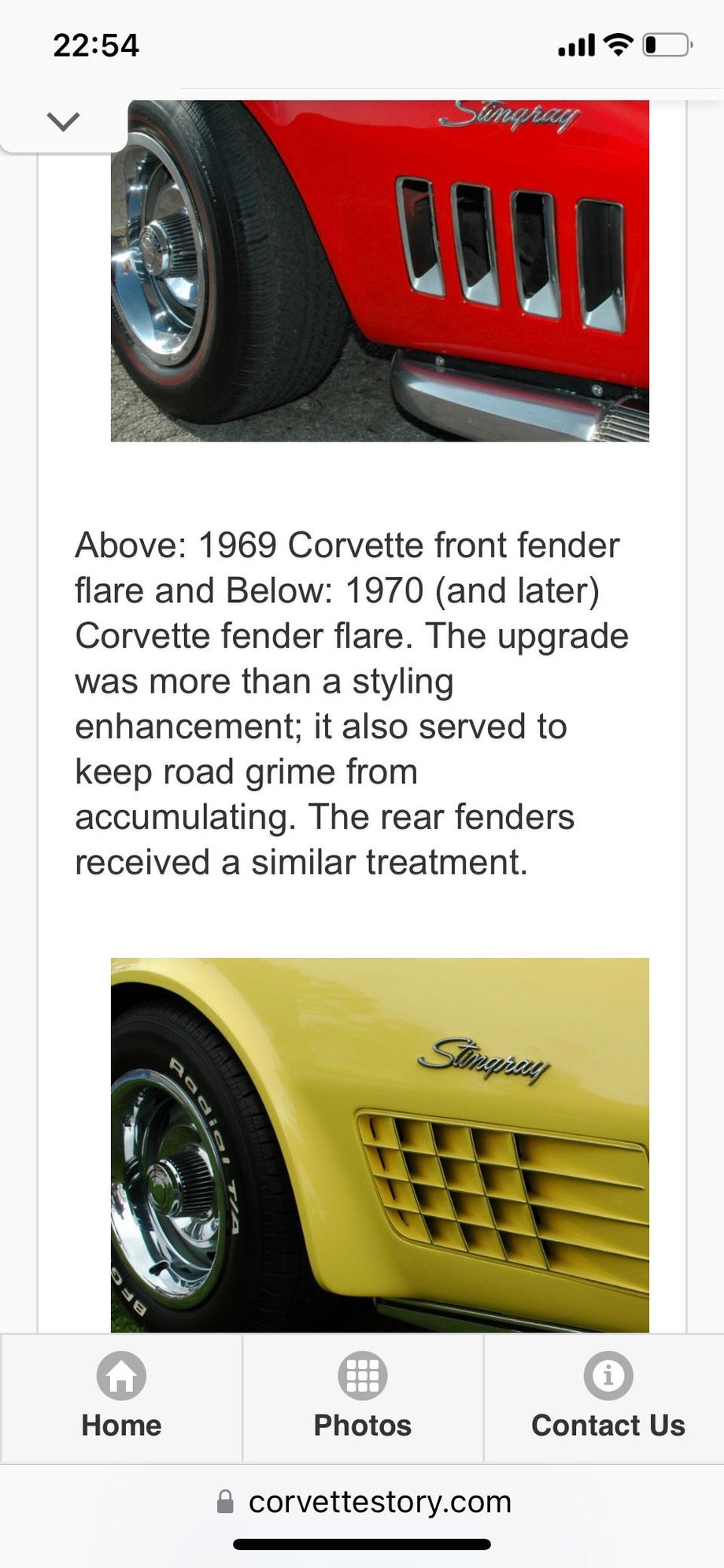

Then is it correct in 69 years? Is the front fender flare replaced?

Your VIN & trim tag match a '69. Not sure what you mean about the flare.

This is the difference

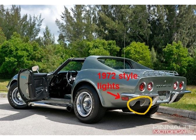

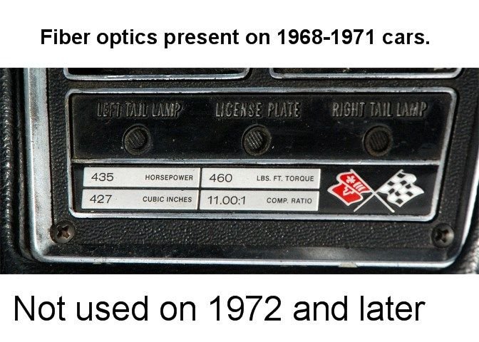

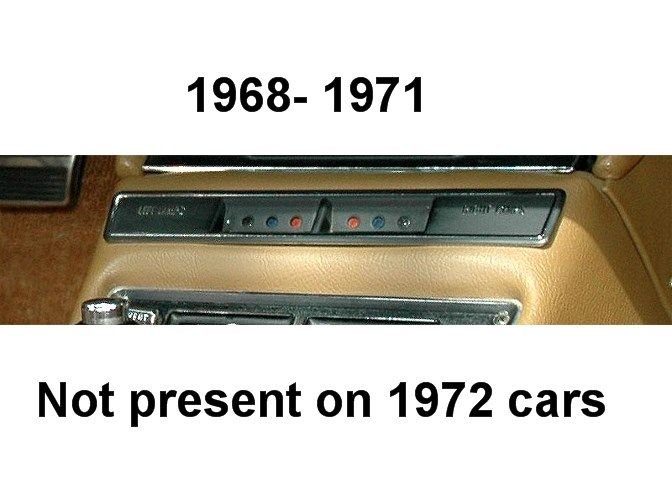

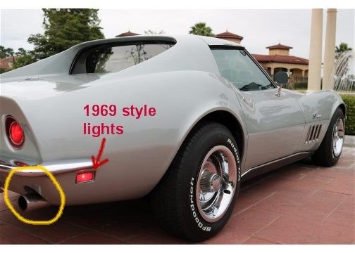

The frame VIN of 1SXXXXXX shows an early February '71 build. Much too early to have the amber turn signal lenses up front, but they could have been changed. So with the fender flares, grills, turn signal lenses, egg crates ans front marker lights, outwardly the car looks more like a 1972 to me. Does the car have the fiber optics light indicators on the console and a pop out rear window? Either way it is definitely not a '69 body (share a picture of the rear side marker lights and exhaust cutouts to confirm this). Trim tag and VIN are correct for 1969.
