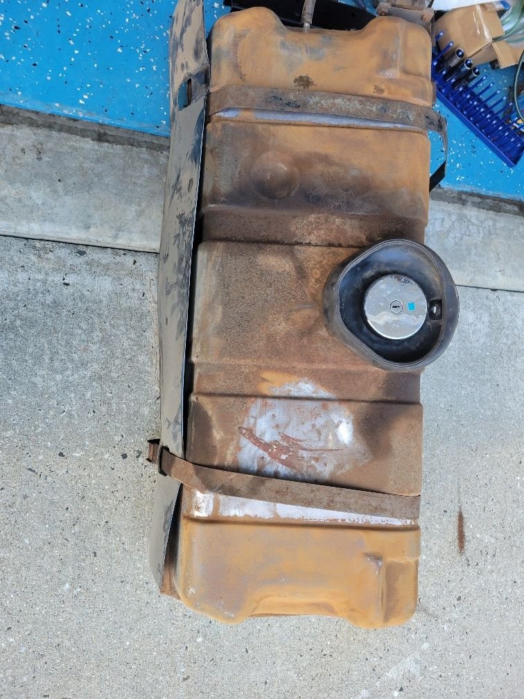

After getting through a small case of "while you're in there itis" I nylon wheeled some of the scale on my gas tank. Now I'm left with the rust dust (see outer edges of the tank) left over from the operation.
What is the best stuff to both "wash away" the dust so I can get to the clean metal, then leave on the surface to keep it more less rust free going
forward after reinstall?

The rust isn't really 'removed'. That would be the equivalent of smearing a malt around the floor with a mop (not picking it up) ...after someone's spilled it. You could consider filling the tank with CO2 and having someone bead blast it with glass beads, in a large cabinet. We used to bead blast tanks all the time.
But if you're just going for 'better than it was' then I'd just wetsand the rust with like 320 or 400# (to de-nib), apply some 2k primer or sealer, then spray with a couple coats of (hardened) silver acrylic enamel. Wetsand because it'll take off the nibs which are part of rust usually (let it dry in the sun for a day). Hardened ...to prevent gasoline spills from affecting the paint. Since it's not really exposed to the elements anymore ...if it's garaged all the time and driven on mostly good days it should last a decent while. You could try every 'miracle' rust-neutralizer in the world but it won't work any better long term. Just prep and spray some silver on it and it'll look a lot better.
Ideally, glass bead to remove all the rust, then apply zinc-based etching primer, then a 2k primer/sealer ...then a catalyzed (hardened) paint (in those stesps). But you have to figure out how far you want to take it and how long you want it to last. There's always a trade-off on labor effort, cost and end quality. I get that. A guy doesn't need to gold-plate everything, right? Best of luck!
