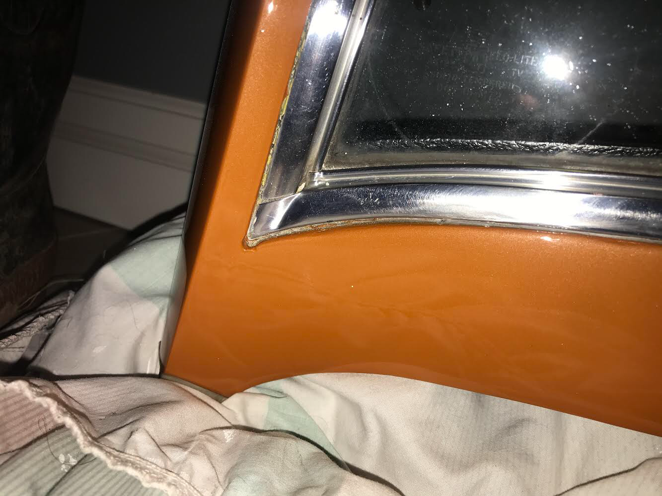

I had the same issue on a top I purchased. I didn’t want to take off the chrome for fear of breaking the clips. I masked the chrome using vinyl smooth edge tape then carefully filled the space with bondo. Took my time to sand it scrape it with a razor blade, especially against the chrome/tape. I’m satisfied……and….I am for sure no expert.

thanks for the reply and photo. Nice job on that. I think I’ll fill the gaps, just because that window (no pun intended) is open. Maybe I’ll fill it around the entire edge, so all the trim fits the same.
This is an opportunity to make it “better than new,” since some aspects of these cars were a little rough off the assembly line.
