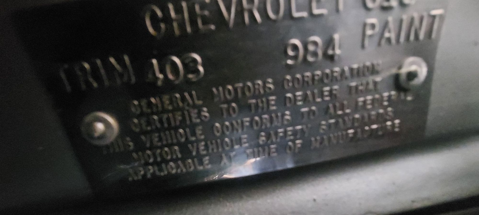

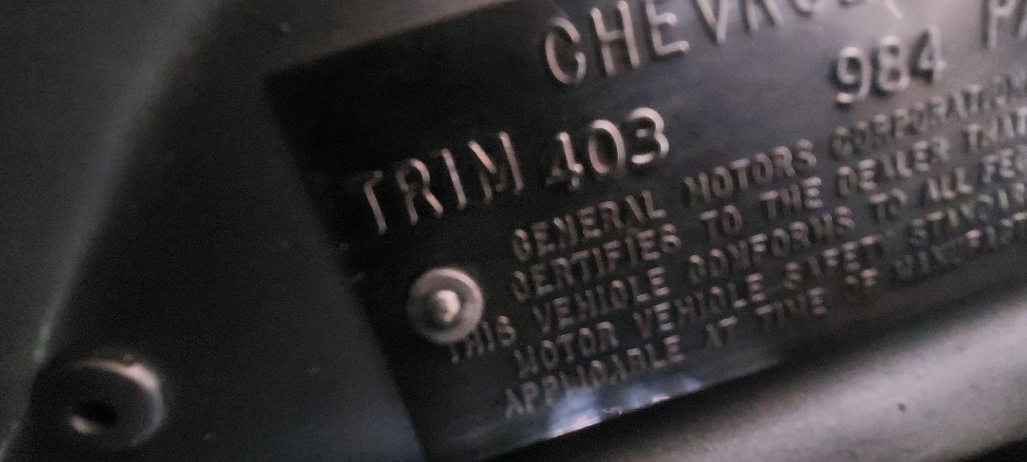

Anyone else have a Trim Code 403 on a 1969 Coupe?
Do the rivets look to be assembly line correct or could this tag have been removed and then reinstalled when the body was repainted a new color?
Sorry for the poor picture quality

As you surmised, the rivets are a joke.

403 is not a 1969 trim code what is the vin of the car ?

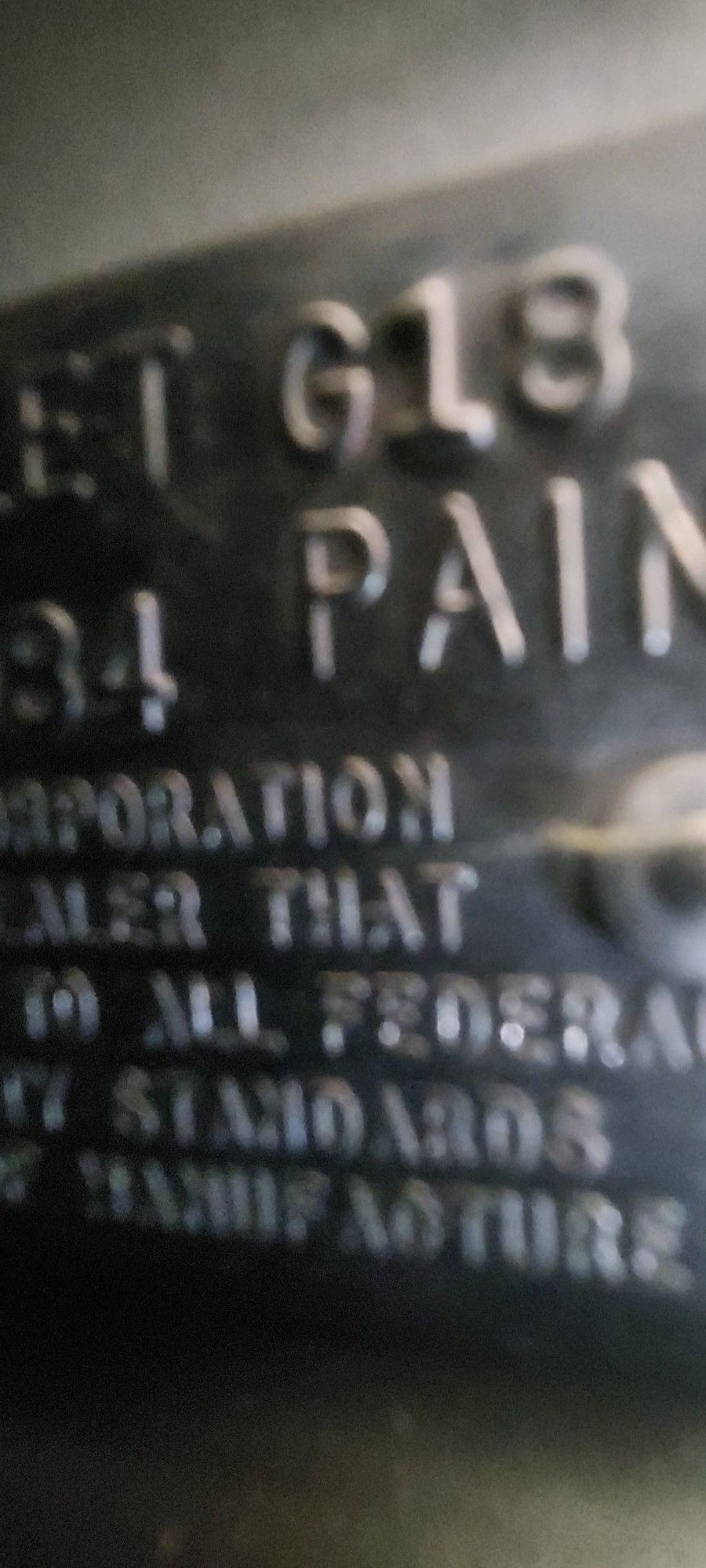

That particular letter G is also incorrect for a ‘69. In 1968 as well as in 1968, the letter G die was damaged. When stamped into a trim tag the letter G looked like a C because the cross bar of the G was broken. When you see a full G on a 68/69 it’s either a switched tag or a repro tag.
That looks like a real tag, but I’m sure it’s from a 1970 originally.

1969 G11 date

Why would someone put a false tag on the car, and still not match the original color?
1970 tag is my guess, too.
http://corvettec3.ca/interior.htm

Ed, I agree it is an original tag with incorrect rivets and from a 70. 403 is a black leather interior code but not for 69
