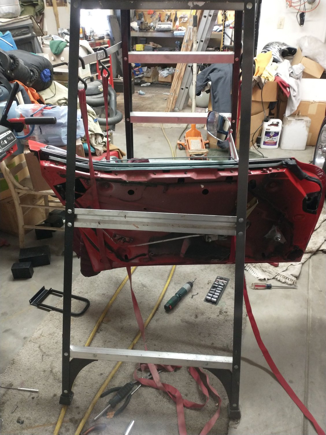

Easy to do when you have the hinge in a vice, not so much when it's on the door. If you are changing the spring, chances are that the hinge bushings are bad. Might be a good time to rebuild the hinges. The complete kit is available. Not that hard. If you want to do both doors you can use the old springs, just change the RT to the LT and visa versa. You will have to grind a new slot on the other side of each spring. I tried to remove the spring on the car and couldn't do it. It was hard even with the door off.
My door removal setup.
