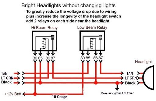

Joe is correct, it is the internal breaker. It will only affect the headlamps and usually only when the high beams are on. Reproduction headlight switches are notorious for this. But originals will do it too with aged wiring. The best fix is to add a couple of headlight relays. It takes all the load off the switch and vintage wiring. There are many posts about this same issue. I add the relays to all my vintage cars. Relays are available at any parts store. Quick, easy and affordable. Here is a basic diagram. You don't have to run the main 10 g. lead to the battery, only to the alternator. You can have this done in 45 minutes.

Perfect, i will give it a shot.
Thanks for the help Joe and Greg
