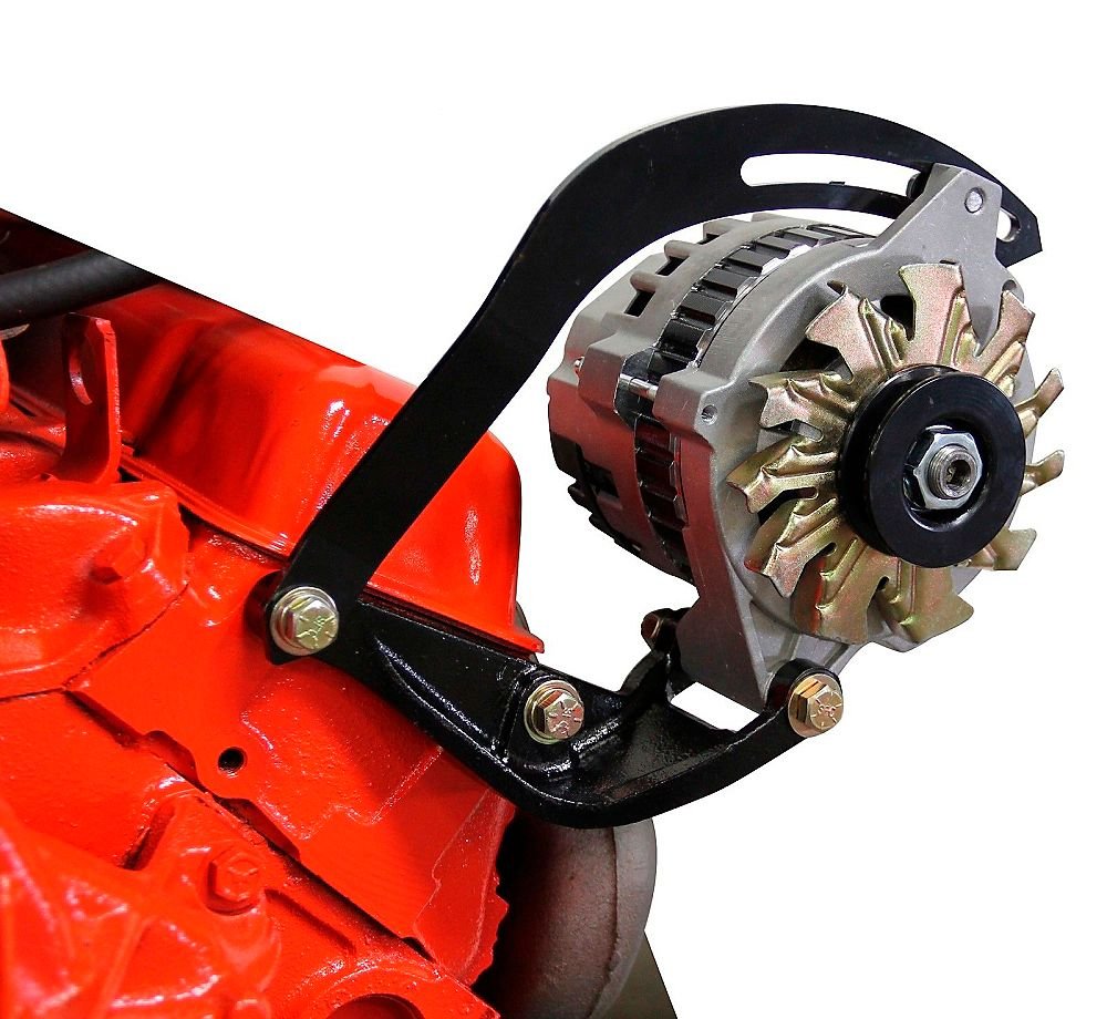

If you have the correct bracket, there is none better than the stock one for a 1970 small block. If your belt comes off, it is an alignment problem. You could also probably get a deeper groove alternator pulley. I shift at 7000 rpm with no belt flyaway ever. This is what I use.........

[QUOTE=C3 Stroker;1605128499]If you have the correct bracket, there is none better than the stock one for a 1970 small block. If your belt comes off, it is an alignment problem. You could also probably get a deeper groove alternator pulley. I shift at 7000 rpm with no belt flyaway ever. This is what I use.........
Would this set work on mine ? Where did you get this from? Thank you for replying that helps !!!

The bracket shown in C3 Strokers pic was used on 72-82 small blocks. 68-71's didn't use a lower bracket, but instead the alternator lower pivot bolt bolted onto a threaded boss in the top front of the exhaust manifold, and just a brace that ran from the water pump to the alternator lower bolt. You can use the later lower bracket on earlier engines, as long as the head is drilled and threaded for the mounting bolts. If you have stock manifolds, the alternator should be mount quite solidly to it, and you shouldn't need to use the later bracket.
The lower bracket is available from most Corvette vendors for around $125, though you can probably find a good used one for around $50 (I use to have some, I'd have to look to see if I still do). If you do use the 72-82 lower bracket, you'll probably need the later upper support too.

I have a 1969. The setup pictured will work on your '70 if you decide to use it. I have it because it clears all headers without a special bracket.
