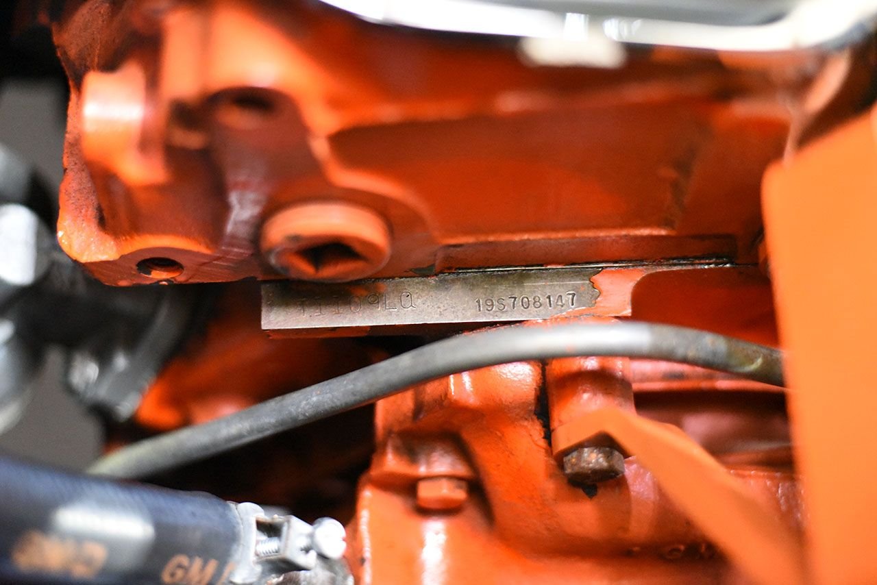

Hi Guys,
Can people please give me their opinion of this stamping on an engine pad. 3955270 block. This will be a good test of your engine pad knowledge
I will get on here in a few days and tell you the history on the block.
Thanks,
Kevin C.

Nothing unusual jumps out at me. The fonts all look correct. The last three digits (956) hang a little low which is also correctly seen on many stamps. If it’s fake, it’s an excellent job. It would have me fooled. It looks original in my opinion.

what's with the suspense, 400 4-speed, pads fine, although no factory broaching

I see factory broach marks, or what would be typical factory type cuts. Also see someone decided to scratch up the pad at right angles to the broach marks where the head would be and on the pad a little.

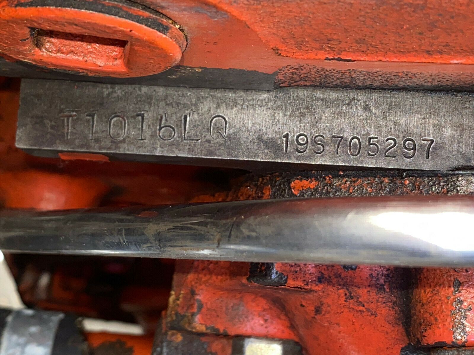

20MERCURY: I am sure they had different Q’s. Here is a pic of the Q you probably have. It’s vin is also near what the OP posted to compare
thanks Ed
That is it!

The horizontal marks are from me cleaning the pad up a little with a wire brush before I took the picture.

i think it is a restamp. careful and decently done, but you can see the T and the 1 next to it leaning towards each other. and the Q leans to the right. on ed's stamp you can see the whole gang leaning slightly upwards but evenly. and they don't line up that well. same with the vin.the first 9 leans left and the last 6 leans right and alignment is not very good. is this a block, or a numbers-matching car? 427-400. that is oval port tri-power if i am correct.

The engine stamping is typical factory production. I have several similar stamps from the same time that have the different "Q" as yours does vs the one that was used in Ed's post. Here is one close to yours and the same day

Here is another LQ pad below I have in my files. Also, as to the pad I posted above and even this one below, I can not say for sure THEY are in fact original but it looks correct from any of the pads I have looked at over the last 35 or so years that I knew were original or those certified by AL G from CCAS. I make no claims of being any kind of expert. I can only guess based on what looks typically correct. And of course not counting the really silly restamps that are easy to spot
