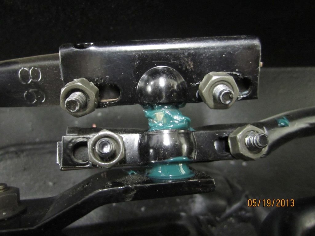

if the switch you installed won't slide up more then you can adjust where the wipers sit when parked so they are a little lower. Loosen the two nuts on either side of where the linkage meets the motor
That will make them sit a little lower on that switch
The setting process in the AIM is well explained

Perfect. Will get that done today. Much appreciated.
