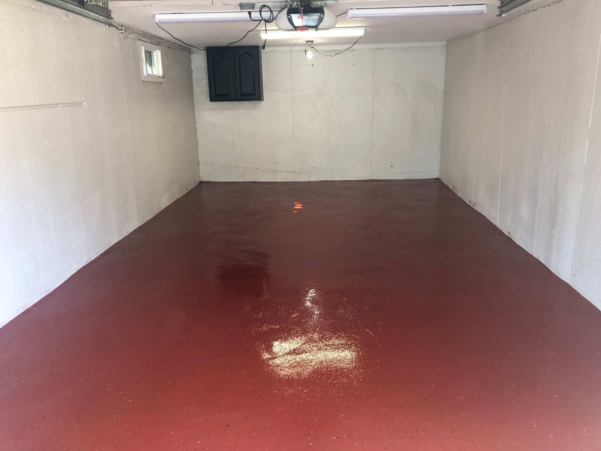

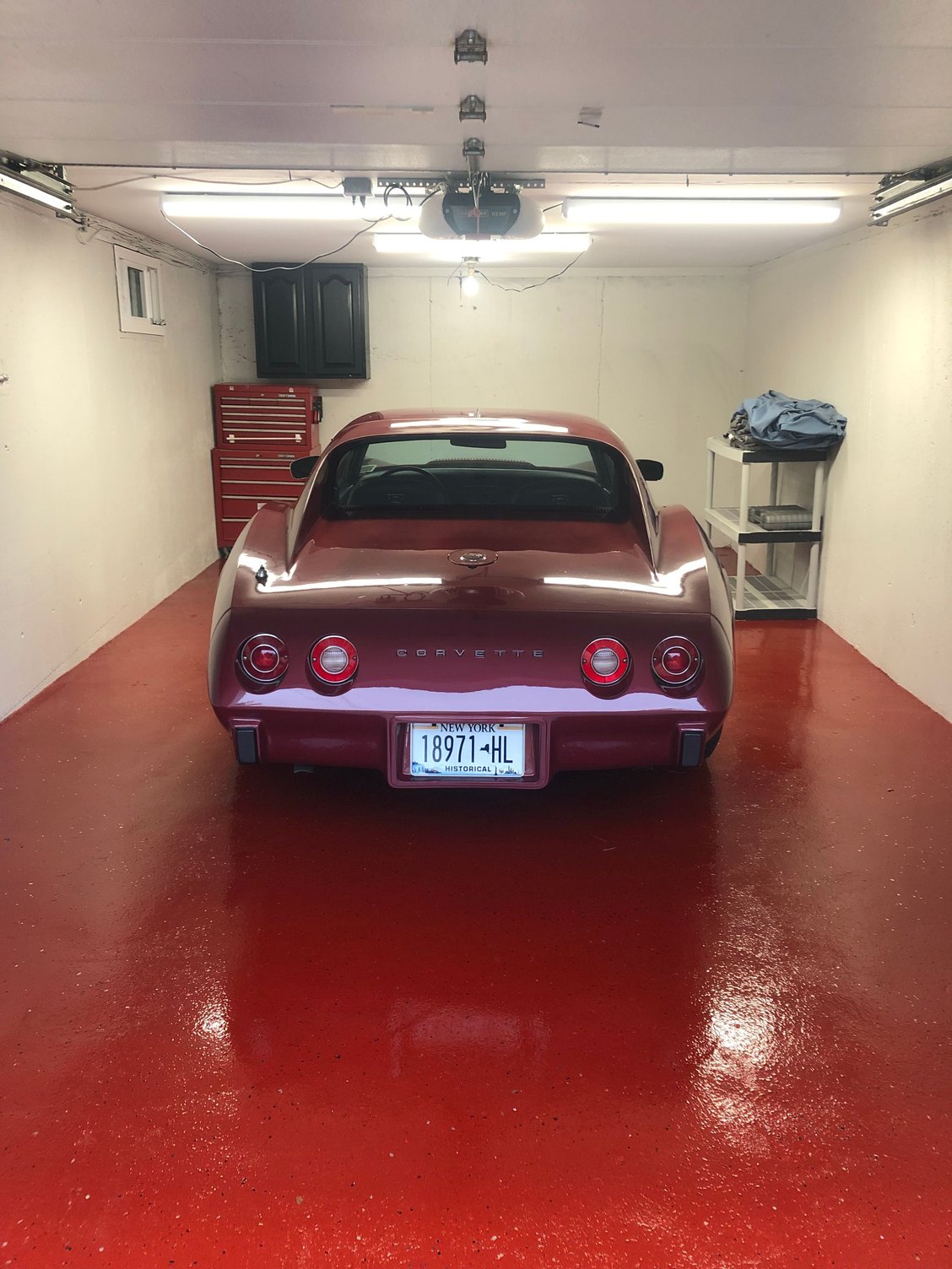

Got mine from Home Depot. An epoxy kit, 2 parts premeasured. All you do is squeeze the bag. Comes in tan or gray. Kit comes complete with acid wash which is way easier than it sounds. Took a day to sweep and acid wash, let dry. a day to apply the color and dry. Third day apply the clear. The kit comes with some of the flakes but not the clear topcoat. And the clear kit comes with some grit so you don't slip on the shiny new floor. Being extra cautious because I am getting to be an old man and not wanting to slip, I put extra grit down. I think it was a bit of overkill but I am completely happy with it. The hardest part was moving everything out of the garage. It also motivated me to DECORATE and turn the garage into MY GARAGE. Not many pics of the floor ( will be glad to share if you want) but check out the General Topics forum, AUTO EXTAS & MEMORABILIA forum and go to Any Cool Corvette Garage Ideas thread. Lots of motivational thoughts once you get your floor done.

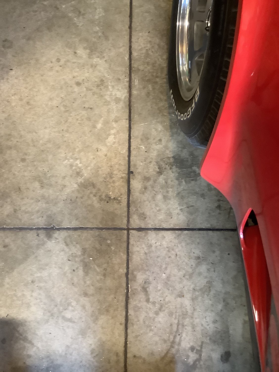

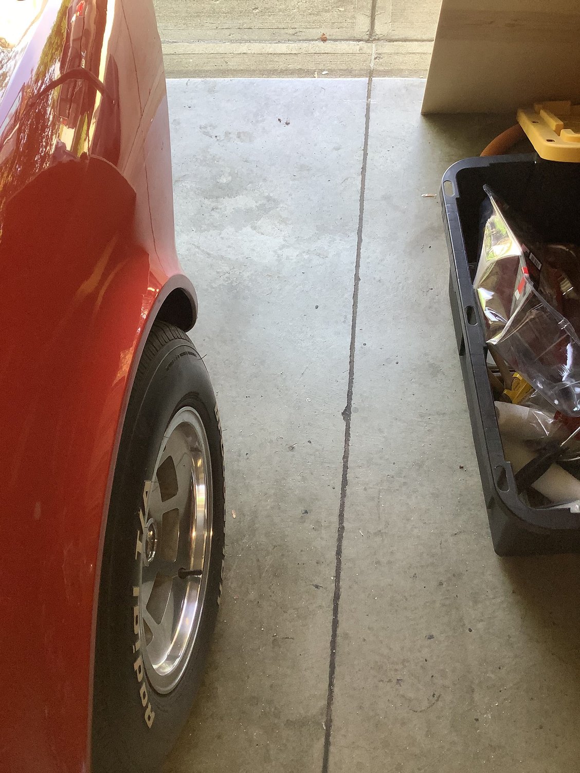

Regardless of what method or product, or NONE, you use of coating if you wanna eliminate bugs, cracks were things fall into whether an expansion joint or other use polyurethane crack filler. Buy some caulk backer so you don’t waste the product. Tape the edges on Straight runs fill the self leveling polyurethane caulk. Reduce my bug population by 99.9% (and therfore vermin attractions?) including those potato bugs and ants. It remains flexible and is extremely durable. There are multiple brands out there. One of the best thing I ever did in the garage.
6 years later no damage
Fills every defect in edge ..6 years later
