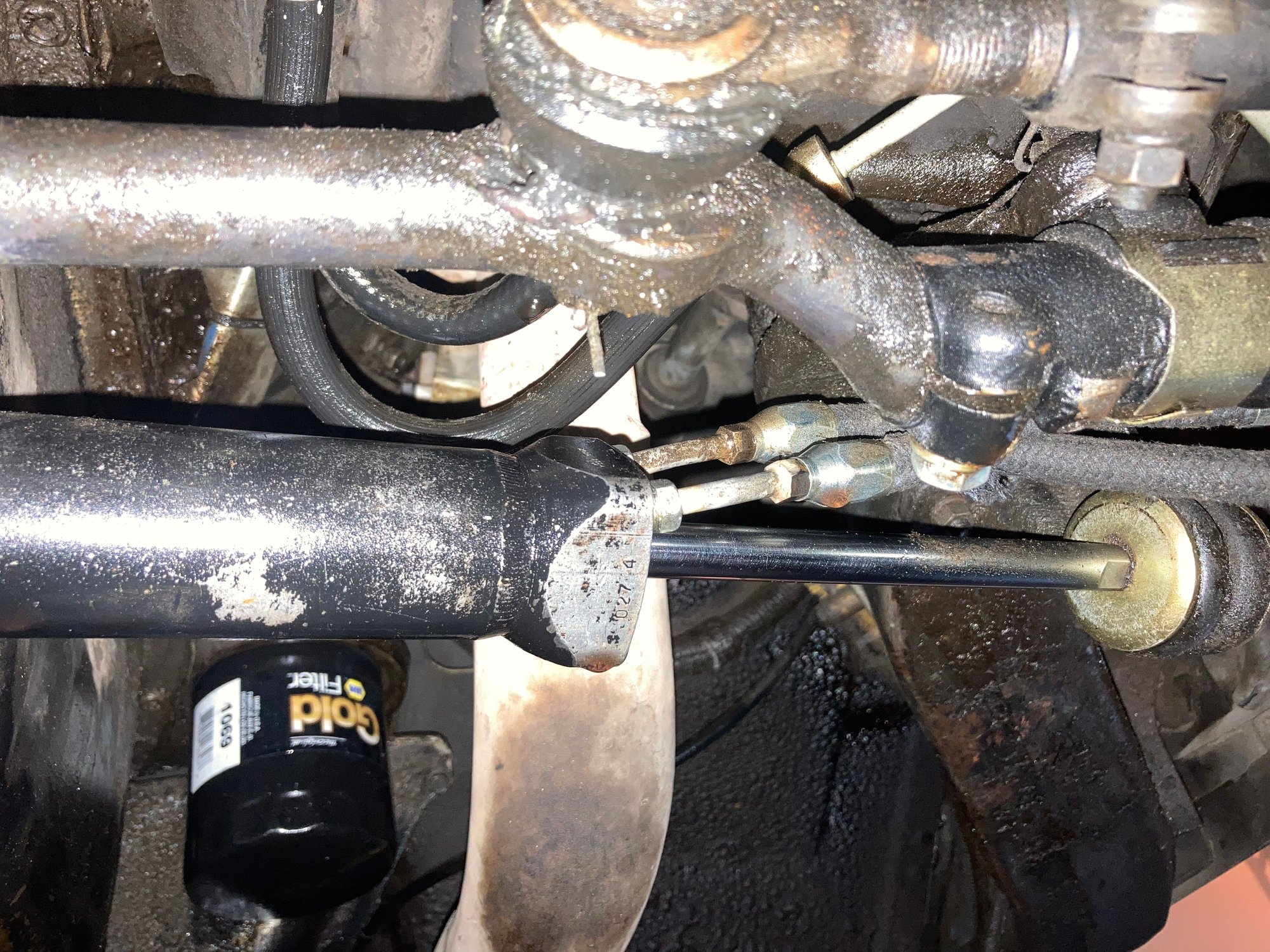

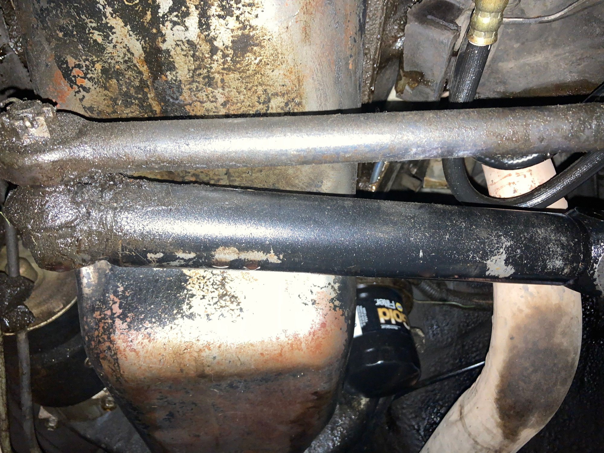

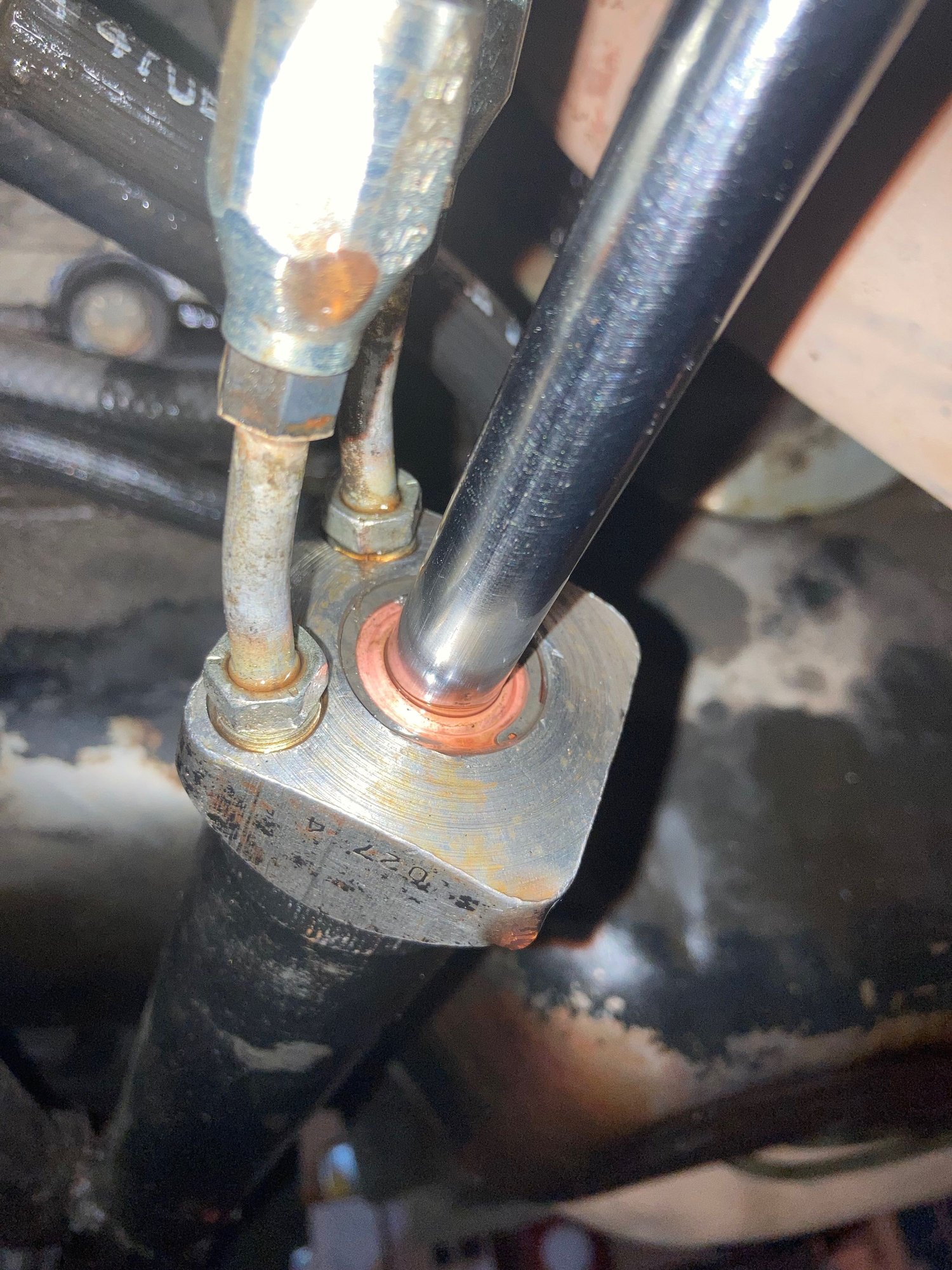

Pics of cylinder piston? They say if chrome worn replace it…

is this the factory unit? I see rebuild products for Edelman units, not sure if they will work for this one. Willcox is down right now.

You need to protrude the hydraulic rod out a little to see if the chrome is worn. It wears at the most movement location ...which is right in the middle of your steering (as you go down the road). It can wear 'thin' too, you don't necessarily need chips.
Also, check the hoses and the return hose on your pump. That could be leaking down onto the cylinder. And it's an easy fix of tightening up the clamp, or shortening up the hose an inch. If your rod looks really good, not chips or rock chips on it, keep it and replace the seals. Like I've said before, on a good rod, and a good seal it shouldn't leak. My skid steer rams leaked (a lot) when I got it (used). After I rebuild the cylinders years ago, they haven't leaked a drop. And those rams are a lot longer, contain way more fluid, and the seals are at the bottom (of a vertically mounted cylinder) ...so there's a lot more oil pressure on them.
A buddy of mine just completed a borgeson conversion. He was looking for power steering. His steering isn't any 'tighter' now, but it was an install from hell. Took a lot of work to complete (but he had headers too). The saginaw style p/s borgeson box is quite a bit larger. He wishes he'd have just put on a ram and saved a lot of money and time. Not saying it's not worthwhile, but with the manual/assist setup you get the tightness of a manual steering box and the ease of the assist. Unless your steering box is really loose (worn) you'd have to go with a rack-n-pinion system to improve it. And even if your steering box IS worn ...it's usually the lower bushing and the upper bearings that wear the most (part of the kit). It's an easy rebuild (or $350 to have rebuilt by a guy who knows his stuff). But with not a whole lot of money, you could rebuild your own steering box, if you have decent mechanical skills .
