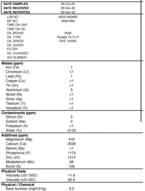

Beating a dead horse on the oil debate, but I use Shell Rotella T4 10w-30
